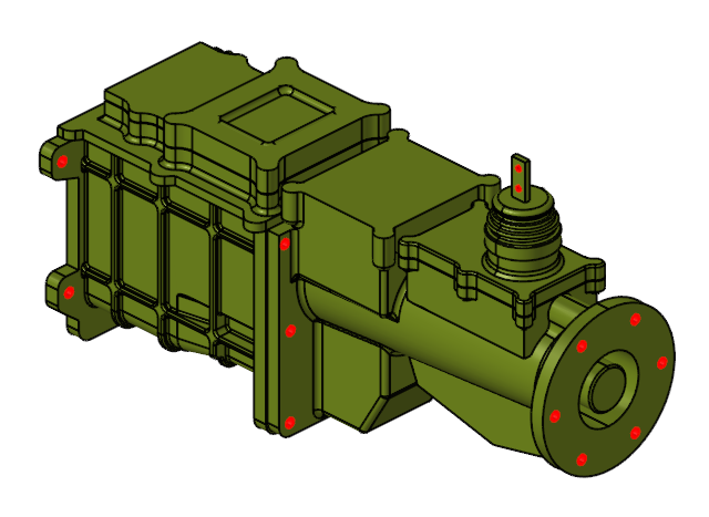

Defeature Small Bolts
From the Geometry ribbon, click the Defeature tool.
From the secondary ribbon, select the Small Features tool.
On the guide bar, click
and set the size to 20.
This value describes the size limit up to which the software should detect a part. -

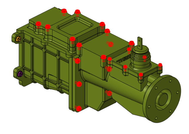

Click Find.
The bolts less than 20mm are highlighted in red.
Figure 3.
Click Remove All.

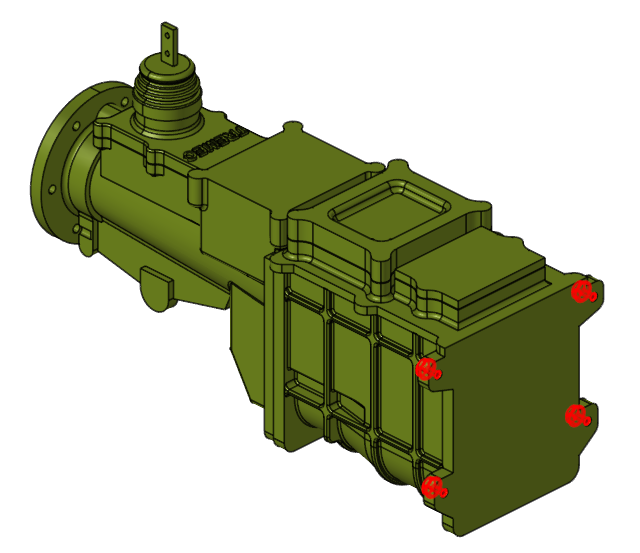

Some bolts that weren’t detected during the Find operation can be manually removed.
Select the four bolts shown below then click Remove All
again.
Figure 4.
- Press Esc to exit the tool.
- Save the model.

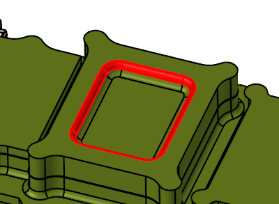

Select a continuous fillet loop, as shown in the figure below.
Figure 8.
- Click Remove All on the guide bar to remove the fillet.

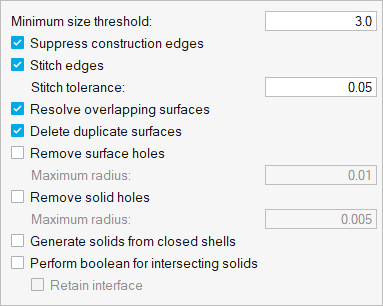

and set the minimum size threshold to 3.0.
Figure 12.
- Press Ctrl + A or left-click and drag across the geometry to select all the solid bodies.
Click Batch Repair to execute the batch process.

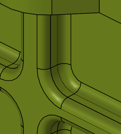

Observe that the suppressed edges are identified by dashed lines.
Figure 13.

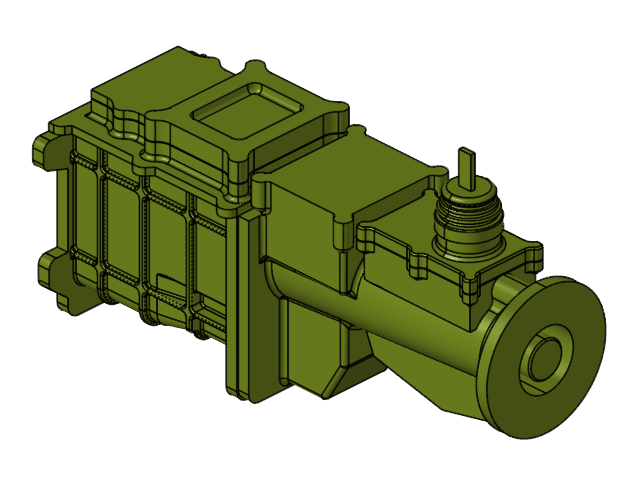

The geometry should now look that shown in the figure below.
Figure 14.
