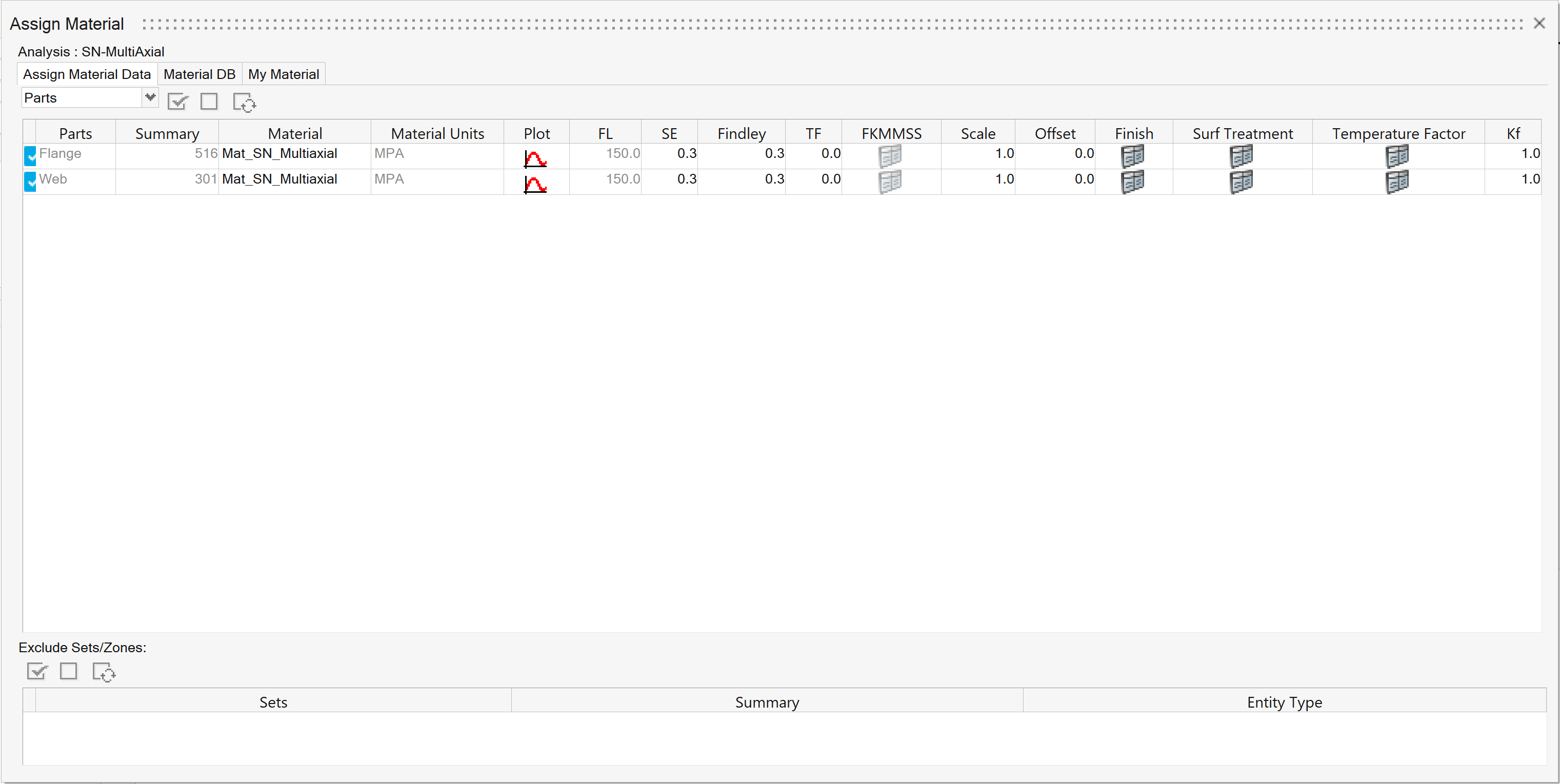

Click the Material tool.
The Assign Material dialog opens.Figure 2.
From the Assign Material Data tab, select either Parts
or Sets from the drop-down menu at the top of the
dialog.
Part lists or sets are obtained from the results model imported into HyperLife. The Summary field details the number of elements for each part.Tip: Click part/set names in the Assign Material dialog to isolate the selected component in the modeling window.
Enable the checkboxes next to the components/sets that are to be
evaluated.

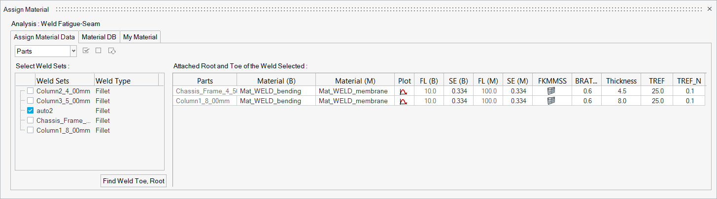

Tip: Use the guide bar to select multiple components in the modeling window.Note: The Assign Material Data tab will look slightly different if you're performing a seam weld analysis. After selecting a part or a set, click Find Weld Toe, Root to find adjacent attached components. You will also notice two material, standard error, and fatigue limit categories: B and M. M stands for membrane and B stands for bending.

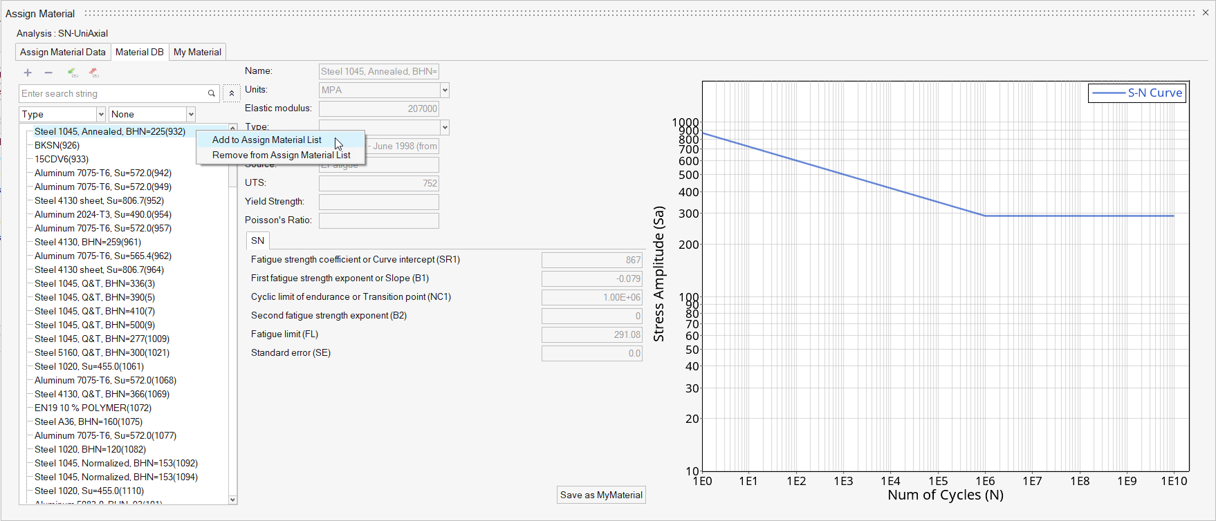

Click either the Material DB tab or the My
Material tab.
Note: When creating an FOS material, the material database is not available.
Right-click on a material and select Add to Assign Material
List from the context menu.
Figure 4.
Note: For EN calculations, a warning is shown if there is no Poisson's Ratio available for the assigned material. Click Yes in the dialog to proceed with a default value of 0.3. -
