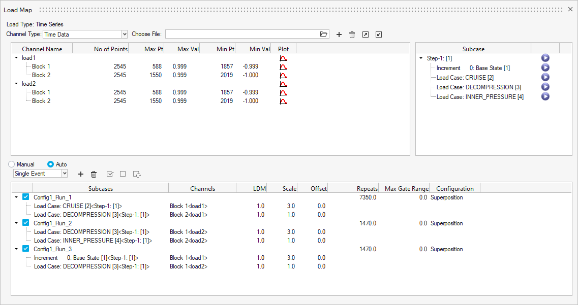

    When Auto and Single Event are selected, before you click ,
    1. Select a subcase and a load history channel, or
    2. Select multiple load histories and subcase pairs that have an equal number of time points.
    Only one event is created when you click .

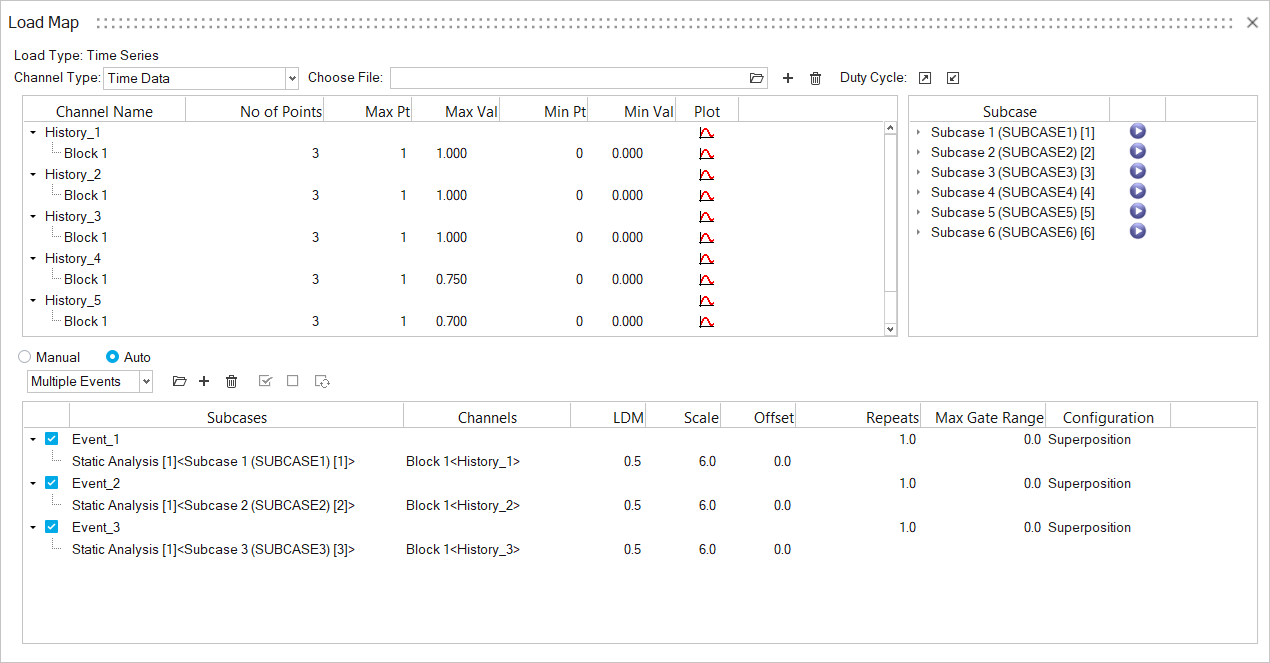

    When Auto and Multiple Events are selected, before you click ,
    1. Select multiple load histories and subcase pairs.
      The load histories must have an equal number of time points.
    2. Total number of events created = Number of channels selected / Number of subcases selected.
  3. Adjust the load magnitude, scale, offset, repeats, max gate range, and configuration of the events/subcases.

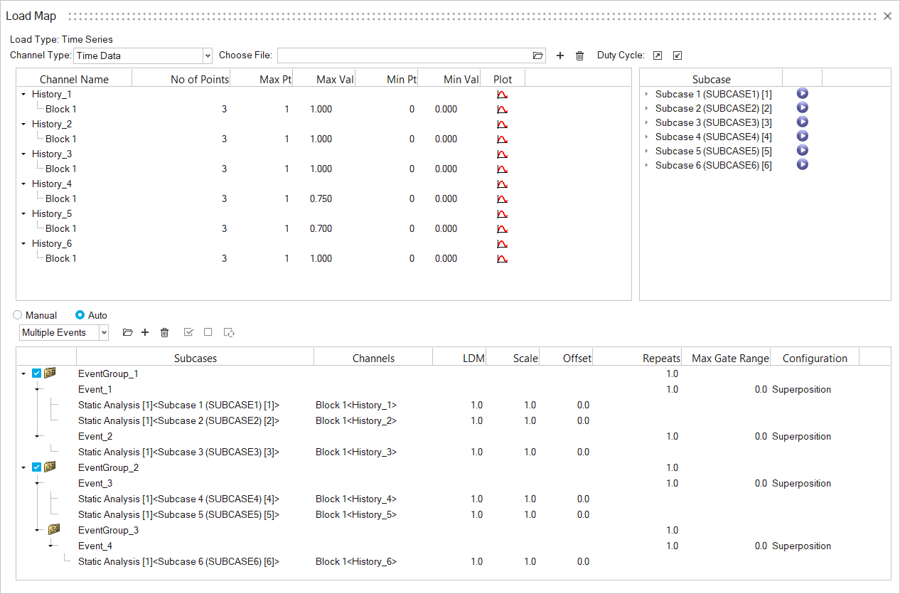

  5. Optional: Create Event Group .
    Events groups can be created to combine required event combinations. See Figure 6.
    1. Click on to create the Event Group and then use the event creation options to create events within the group.
      Event group should be highlighted before creating individual events within the group. Event groups can also be created within a group leading to nested event group combination as shown in Figure 6.
Figure 5.

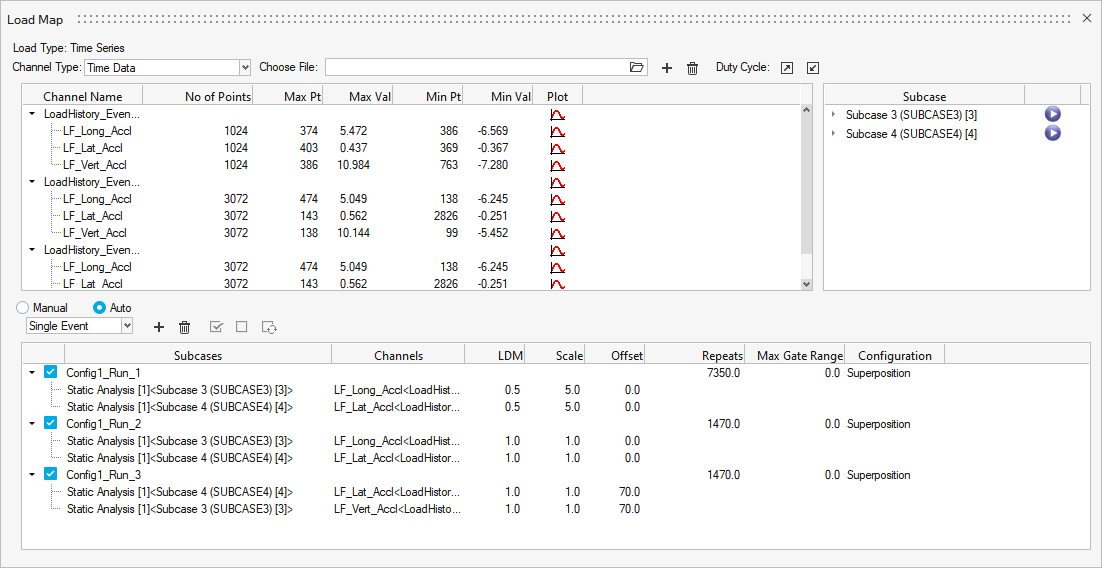

The following equation depicts how LDM, Scale, and Offset values work together to scale the FEA stress tensor at time t.
σ i j ( t ) = σ i j . F E A L D M ( P ( t ) S c a l e + O f f s e t ) MathType@MTEF@5@5@+= feaagKart1ev2aaatCvAUfeBSjuyZL2yd9gzLbvyNv2CaerbuLwBLn hiov2DGi1BTfMBaeXatLxBI9gBaerbd9wDYLwzYbItLDharqqtubsr 4rNCHbGeaGqiVu0Je9sqqrpepC0xbbL8F4rqqrFfpeea0xe9Lq=Jc9 vqaqpepm0xbba9pwe9Q8fs0=yqaqpepae9pg0FirpepeKkFr0xfr=x fr=xb9adbaqaaeGaciGaaiaabeqaamaabaabaaGcbaGaeq4Wdm3aaS baaSqaaiaadMgacaWGQbaabeaakiaacIcacaWG0bGaaiykaiabg2da 9maalaaabaGaeq4Wdm3aaSbaaSqaaiaadMgacaWGQbGaaiOlaiaadA eacaWGfbGaamyqaaqabaaakeaacaWGmbGaamiraiaad2eaaaGaaiik aiaadcfacaGGOaGaamiDaiaacMcacaWGtbGaam4yaiaadggacaWGSb GaamyzaiabgUcaRiaad+eacaWGMbGaamOzaiaadohacaWGLbGaamiD aiaacMcaaaa@55EB@
Where:
σ i j ( t ) MathType@MTEF@5@5@+= feaagKart1ev2aaatCvAUfeBSjuyZL2yd9gzLbvyNv2CaerbuLwBLn hiov2DGi1BTfMBaeXatLxBI9gBaerbd9wDYLwzYbItLDharqqtubsr 4rNCHbGeaGqiVu0Je9sqqrpepC0xbbL8F4rqqrFfpeea0xe9Lq=Jc9 vqaqpepm0xbba9pwe9Q8fs0=yqaqpepae9pg0FirpepeKkFr0xfr=x fr=xb9adbaqaaeGaciGaaiaabeqaamaabaabaaGcbaGaeq4Wdm3aaS baaSqaaiaadMgacaWGQbaabeaakiaacIcacaWG0bGaaiykaaaa@3C1E@
Results stress tensor at time t
σ i j . F E A MathType@MTEF@5@5@+= feaagKart1ev2aaatCvAUfeBSjuyZL2yd9gzLbvyNv2CaerbuLwBLn hiov2DGi1BTfMBaeXatLxBI9gBaerbd9wDYLwzYbItLDharqqtubsr 4rNCHbGeaGqiVu0Je9sqqrpepC0xbbL8F4rqqrFfpeea0xe9Lq=Jc9 vqaqpepm0xbba9pwe9Q8fs0=yqaqpepae9pg0FirpepeKkFr0xfr=x fr=xb9adbaqaaeGaciGaaiaabeqaamaabaabaaGcbaGaeq4Wdm3aaS baaSqaaiaadMgacaWGQbGaaiOlaiaadAeacaWGfbGaamyqaaqabaaa aa@3CCF@
Stress tensor from static analysis
P ( t ) MathType@MTEF@5@5@+= feaagKart1ev2aaatCvAUfeBSjuyZL2yd9gzLbvyNv2CaerbuLwBLn hiov2DGi1BTfMBaeXatLxBI9gBaerbd9wDYLwzYbItLDharqqtubsr 4rNCHbGeaGqiVu0Je9sqqrpepC0xbbL8F4rqqrFfpeea0xe9Lq=Jc9 vqaqpepm0xbba9pwe9Q8fs0=yqaqpepae9pg0FirpepeKkFr0xfr=x fr=xb9adbaqaaeGaciGaaiaabeqaamaabaabaaGcbaGaamiuaiaacI cacaWG0bGaaiykaaaa@391D@
The y point value of load-time history at time t

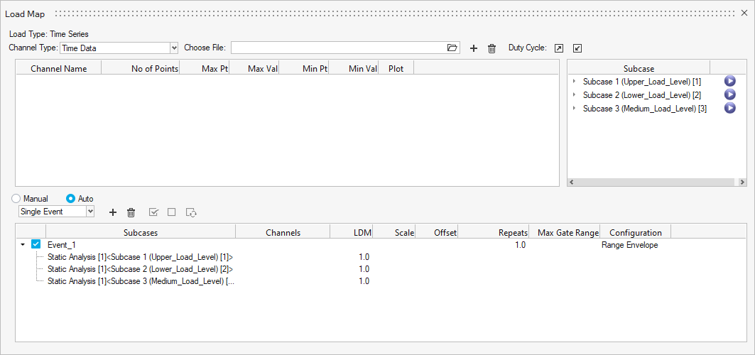

Event Configuration: Range Envelope
With Range envelope selection for an event, the worst subcase pair will be selected to create the stress range for fatigue evaluation.
  • From the subcases assigned to the event, all possible subcase pairs will be created.
  • Absolute principal stress calculated from the derived tensor from all subcase pairs. I.e., |sub1 – sub2|, |sub2- sub3|, etc. is compared to calculate the extreme.
  • Subcase pair resulting in the extreme is chosen to create the stress range. The stress range is defined by the selected stress combination for fatigue analysis.
Note:
  • Absolute principal stress is used as the metric in finding the worst subcase pair for all stress combinations except Critical plane.
  • If Critical plane is applied as the stress combination, the normal stress in each angle will be compared to obtain the extreme. Critical plane is valid for 2D stress only.
  • Range envelope configuration is supported for Stress Life evaluation only.
  • If there are more than one range envelope events created, all these events should be of the same configuration.
Figure 8.

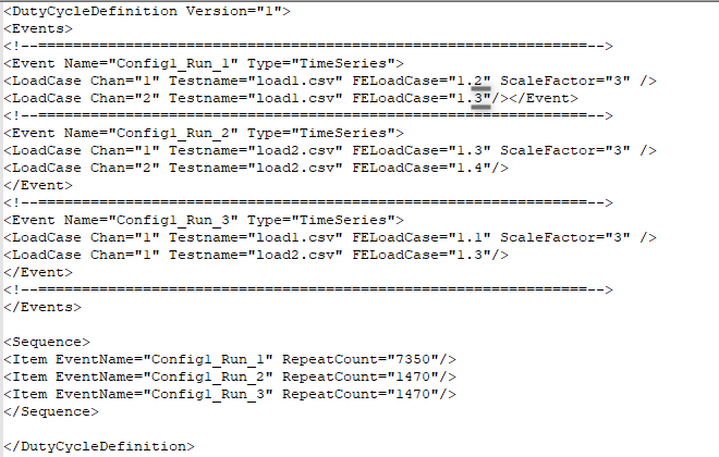

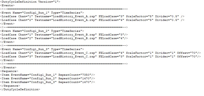

    The files formats supported for load history within the *.dcy file are: *.csv, *.rpc, *.rsp, and *.dac.
    Figure 10. Duty Cycle File Example
    The key words from the *.dcy file define the required duty cycle information, such as:
    • Channel number (Chan)
    • Load history file name with extension (Testname)
    • FE subcase ID in HyperLife (FELoadCase)

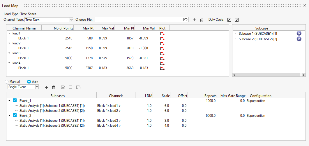

  5. Optional: Update any parameters as needed or disable an event to exclude it from the solution.
    Figure 11.
    Simulation list/increments within a FE subcase can be included in *.dcy event pairing as SubcaseID.Simulation.ID as shown in the example below.
    Figure 12.
    Figure 13.

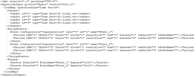

    The key words from the *.xml files define the required duty cycle information, such as:
    • Type of Load Type (typeofloading)
      <LoadMap typeofloading="Time Series">
    • Load History file name with extension
      <Channel>
              <tabfat id="1" type="Time Data">E:/load1.csv</tabfat>
      </Channel>
    • Event information
      <FatigeEvents>
              <Event Configuration="superposition" Gate="0" id="1" name="Event_1">
                  <Fatload LDM="1" Offset="0" Scale="6" block="1" resultfile="" sim="1" subcase="1" tabfatId="1" tabfatName=""></Fatload>
                  <Fatload LDM="1" Offset="0" Scale="6" block="1" resultfile="" sim="1" subcase="2" tabfatId="2" tabfatName=""></Fatload>
              </Event>
      </FatigeEvents>
    • Event sequence
      <Fatseq>
              <Fatevnt EventId="" EventName="Event_1" Repeats="1000"></Fatevnt>
              <Fatevnt EventId="" EventName="Event_2" Repeats="5000"></Fatevnt>
      </Fatseq>

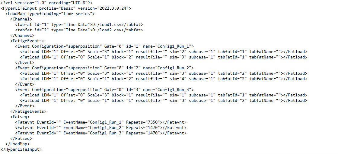

  4. Optional: Update any parameters as needed or disable an event to exclude it from the solution.
    Figure 16.
    Simulation list/increments within a FE subcase can be included in *.xml event pairing sim = Simulation.ID as shown in the example below.

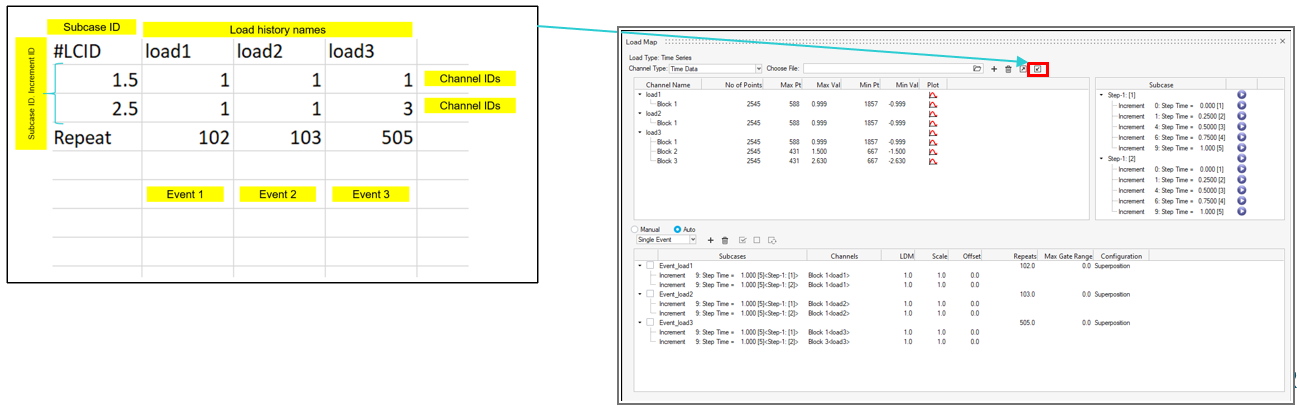

Event Mapper CSV
Event Mapper file is an alternative to Duty Cycle file for when the Channel mapping doesn’t specifically follow a uniform order for each of the FE loadcases.
The Channel IDs (Time series data) and FE loadcase IDs are pre-sorted to form Events in a *.csv format, which is imported on Load Map utility.
Figure 18.
Terminology
  • Channel Mapping: Concatenating Load history data together with corresponding FE loadcase to form a Durability Event.
  • Durability Event creation is critical step and intense when large load history is considered.
  • Need arises to consider fewer channels from a Load history file (for example, RSP) which is not in sequence.
  • FE loadcase and Channel data don’t follow an order for the tool to do Auto pairing.
Note: Load history files should already be imported to the session prior to Event Mapper CSV.

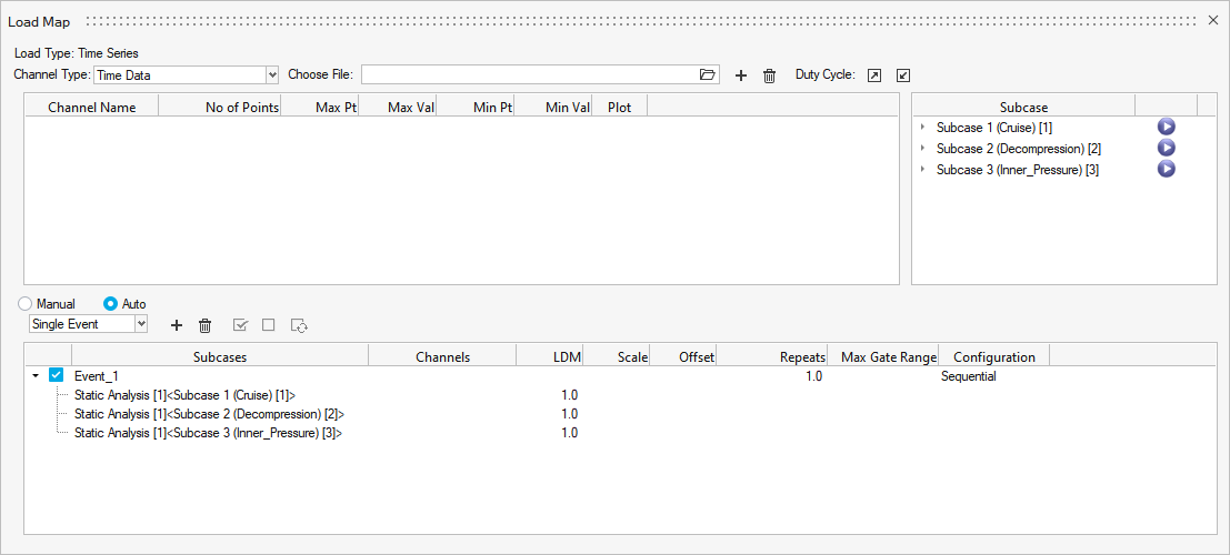

  5. Apply Max Gate Range (0.0 ≤ Real < 1.0), to apply gate on the Stress History.
  6. Activate the checkboxes of the events to be considered in the evaluation.
Figure 22.

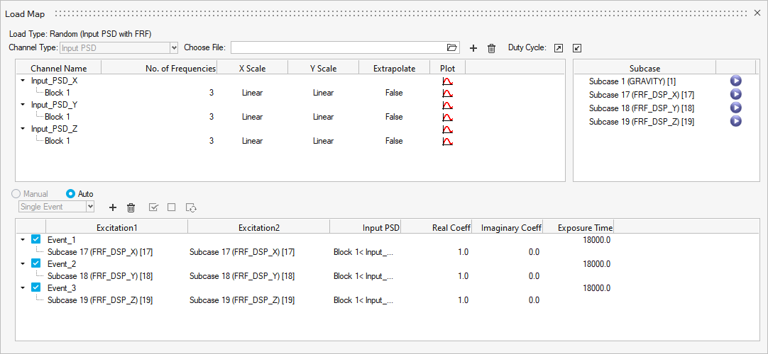

Create Random (Input PSD with FRF) Events
Frequency Response Analysis subcases are supported for SN (uniaxial) and EN (uniaxial) fatigue calculations with a Random (Input PSD with FRF) loading type.
Note: Default format on import of Input PSD is LINEAR - LINEAR (that is, linear interpolation for the x-axis and linear interpolation for the y-axis). X Scale and Y Scale is to be changed to the required format. For example: LOGARITHMIC - LOGARITHMIC.
  1. Click the Load Map tool.
    Figure 25.
    The Load Map dialog opens.
  2. Select subcases.
  3. On the bottom half of the dialog, click to create an event.
    The possible correlations (Excitation1 and Excitation2) of the selected FRF subcases are listed under the event.
  4. Drag-and-drop the imported channels onto the Input PSD field of each correlation.
    The Input PSDs are used to scale the complex stresses. Input PSD of frequency vs scale in CSV format are supported.
  5. Scale the complex stresses using the Input PSD and the Real and Imaginary coefficients from each event.
  6. Optional: Edit the Exposure Time value.
    Tip: Apply an Exposure Time value to all the events by right-clicking on a value and selecting Apply value to all events.
  7. Enable the checkboxes of the events to be considered in the evaluation.
    Figure 26.
