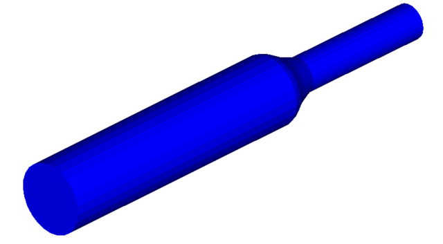

Import the Model
From the Load model and result dialog, browse and select
HL-1000\Shaft.h3d for the model
file.
The Load Result field is automatically populated. For this tutorial, the same file is used for both the model and the result.
Click Apply.

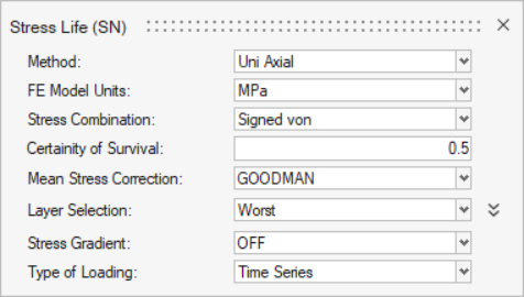

The SN dialog opens. -
Define the SN configuration parameters.
- Select Uni Axial as the method.
- Select MPa for the FE model units.
- Select Signed von for the stress combination.
- Enter a value of 0.5 for the certainty of survival.
- Select GOODMAN for the mean stress connection.
- Select Worst for the layer selection.
- Select Time Series for the type of loading.
Figure 4.
- Exit the dialog.

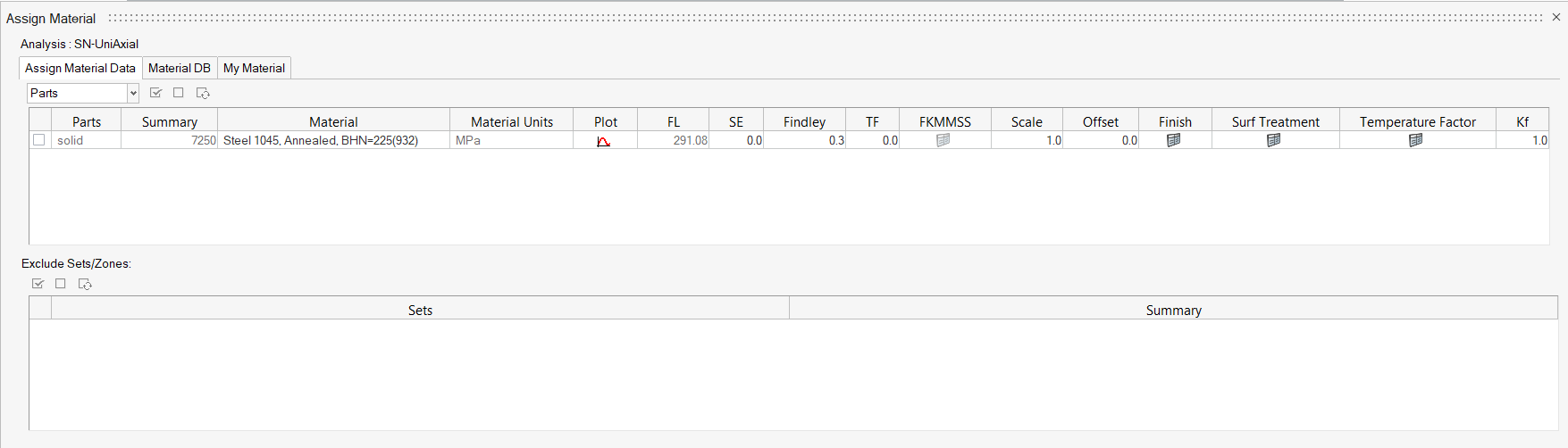

Click the Material tool.
Figure 5.
The Assign Material dialog opens. - Activate the checkbox next to the part solid.

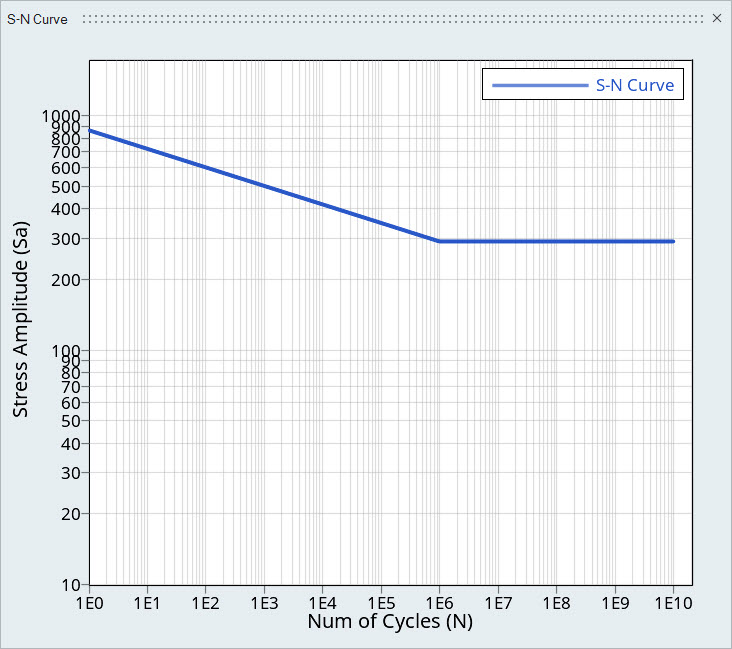

If Steel 1045, Annealed, BHN=225 (932) is not the default material assigned to
the part:
- Optional:
Click
to
review the SN plot.
Figure 7.
Accept all other default parameters.
Figure 8.
Note: The FL (Fatigue Limit) and SE (Standard Error) values are from the SN curve selected for the part. The SE value can be edited from both the Assign Material Data tab and the My Material tab. The FL value can be reviewed and edited from the My Material tab. Parameters updated in the My Material tab will be saved to a user-defined excel spreadsheet. - Exit the dialog.

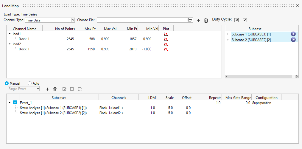

Click the Load Map tool.
Figure 9.
The Load Map dialog opens. - From the Channel Type drop-down menu at the top of the dialog, select Time Data.
Click
in the Choose File
field and browse for load1.csv.
Click
to add the load case.
- Repeat steps 3 and 4 for load2.csv.

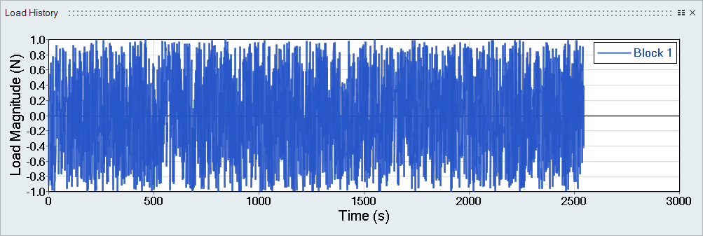

- Optional:
Click
to view a plot of the loads.
Figure 10. Load 1
Figure 11. Load 2
Tip: Expand the width of the dialog to view a clearer picture of the plot. -
On the bottom half of the dialog, set the radio button to
Manual for event creation and click
to create an
Event_1 header.
- Drag and drop Subcase 1 and Subcase 2 under Event_1.
- Drag and drop the Block file under load1 onto the Channels field of Subcase 1.
- Repeat for the Block file under load2 and Subcase 2.
- Activate the Event_1 checkbox.
Set LDM to 1.0, Scale to 5.0 and
Offset to 0.0 for both subcases.
Figure 12.
- Exit the dialog.

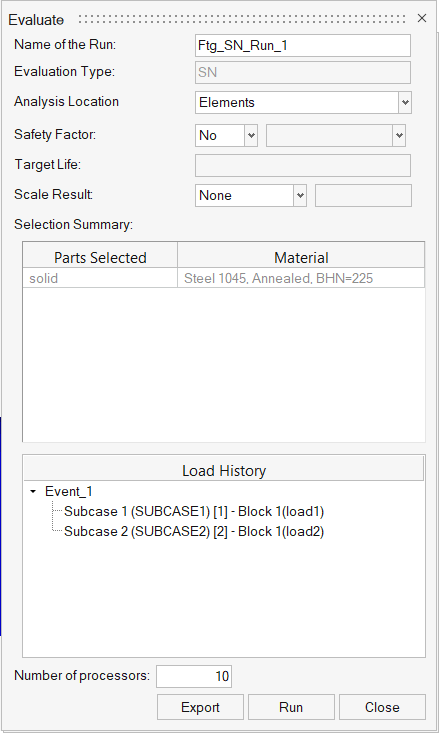

Evaluate and View Results
From the Evaluate tool group, click the
Run Analysis tool.
Figure 13.
The Evaluate dialog opens.Figure 14.
- Optional: Enter a name for the run.
Click Run.
Result files are saved to the home directory and the Run Status dialog opens.
- Once the run is complete, click View Current Results.

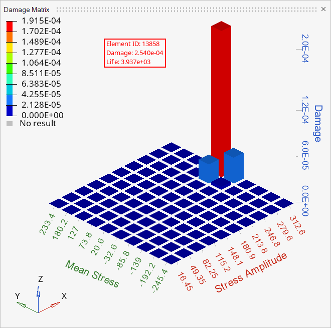

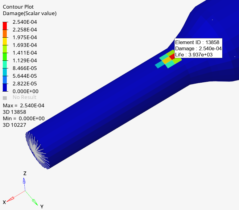

Use the Results Explorer to
visualize various types of results.
Figure 15.
Figure 16.
