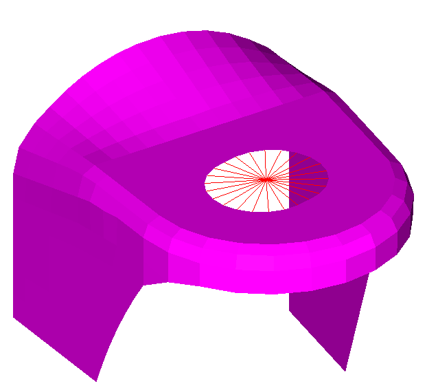

Import the Model
From the Load model and result dialog, browse and select
HL-1070\Bracket-SN-Transient.h3d for the model
file.
The Load Result field is automatically populated. For this tutorial, the same file is used for both the model and the result.
Click Apply.
Tip: Quickly import the model by dragging and
dropping the .h3d file from
a windows browser into the HyperLife
modeling window.

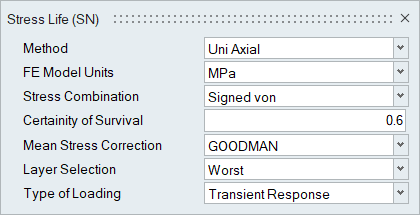

Define the Fatigue Module
Click the SN tool.
The SN tool should be the default fatigue module selected. If it is not, click the arrow next to the fatigue module icon to display a list of available options.
Figure 3.
The SN dialog opens. -
Define the SN configuration parameters.
- Select Uni Axial as the method.
- Select MPa for the FE model units.
- Select Signed von for the stress combination.
- Enter a value of 0.6 for the certainty of survival.
- Select GOODMAN for the mean stress connection.
- Select Worst for the layer selection.
- Select Transient Response for the type of loading.
Figure 4.
- Exit the dialog.

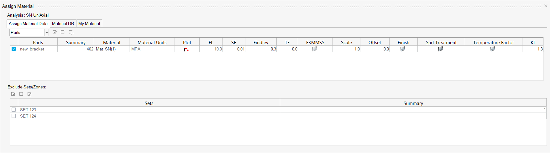

Assign Materials
Click the Material tool.
Figure 5.
The Assign Material dialog opens. - Activate the checkbox next to the part new_bracket.
Create a new material.
- Right-click on Mat_SN("n") and select Add to Assign Material List.
Return to the Assign Material Data tab and select
Mat_SN("n") from the Material drop-down menu for
new_bracket.
The Material list is populated with the materials selected from Material Database and My Material.
Click
under Finish. In the
Surface Finish dialog, select
POLISH from the drop-down menu then click
OK.
Click
under Surf Treatment. In
the Surface Treatment dialog, select
NITRIDED from the drop-down menu then click
OK.
Set the Kf value to 1.3.
Figure 7.
- Exit the dialog.

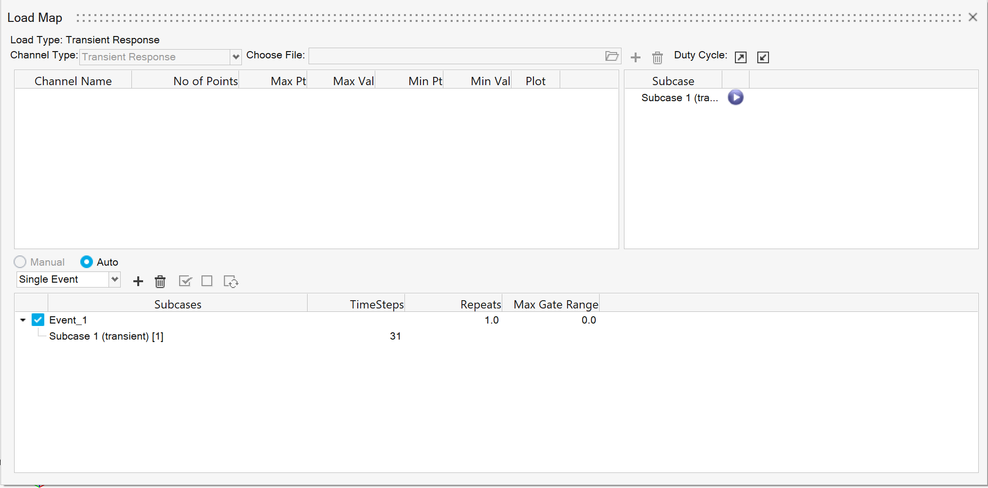

Create a Transient Event
Click the Load Map tool.
Figure 8.
The Load Map dialog opens.By default, the Channel Type is set to Transient Response and can not be changed. Since this is a transient fatigue analysis, a load history is not required.
- Select Subcase 1 (transient).
On the bottom half of the dialog, click
to create an Event_1 header.
Subcase 1 is listed under the event. -
Activate the Event_1 checkbox.
Figure 9.
Note: You can only select one transient subcase per event. - Exit the dialog.

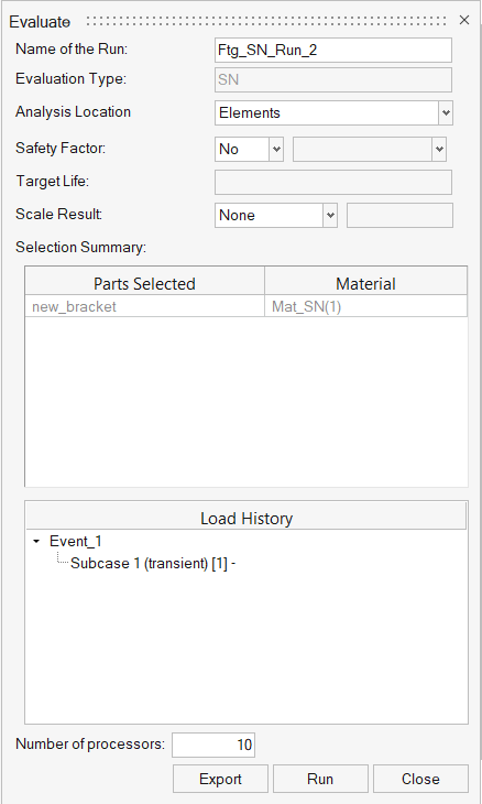

Evaluate and View Results
From the Evaluate tool group, click the
Run Analysis tool.
Figure 10.
The Evaluate dialog opens.Figure 11.
- Optional: Enter a name for the run.
Click Run.
Result files are saved to the home directory and the Run Status dialog opens.

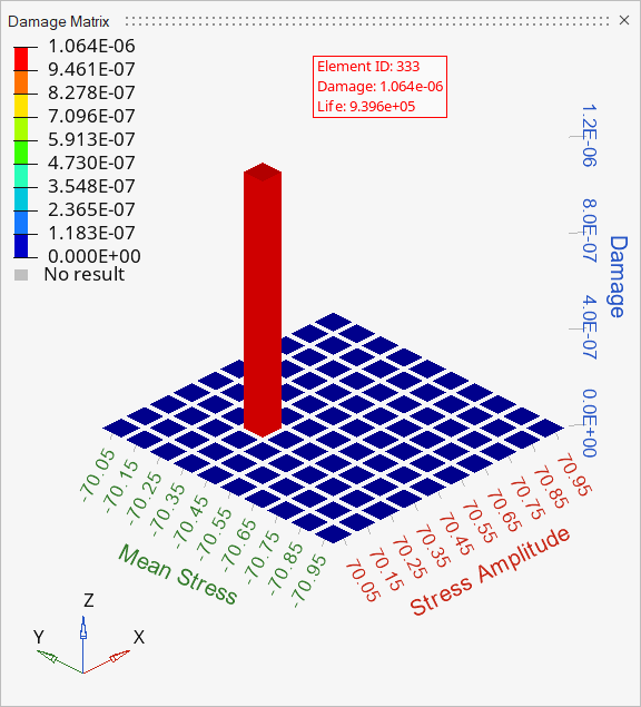

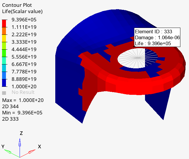

- Once the run is complete, click View Current Results.
Use the Results Explorer to
visualize various types of results.
Figure 12.
Figure 13.
