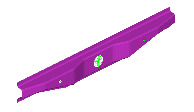

  1. From the Home tools, Files tool group, click the Open Model tool.
  2. From the Load model and result dialog, browse and select HL-1100\Rear_Truss.h3d for the model file.
    The Load Result field is automatically populated. For this tutorial, the same file is used for both the model and the result.
  3. Click Apply.

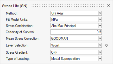

  2. Define the SN configuration parameters.
    1. Select Uni Axial as the method.
    2. Select MPa for the FE model units.
    3. Select Abs Max Principal for the stress combination
    4. Enter a value of 0.5 for the certainty of survival.
    5. Select GOODMAN for the mean stress connection.
    6. Select Worst for the layer selection.
    7. Select Modal Superposition for the type of loading.
    Figure 5.
  3. Exit the dialog.

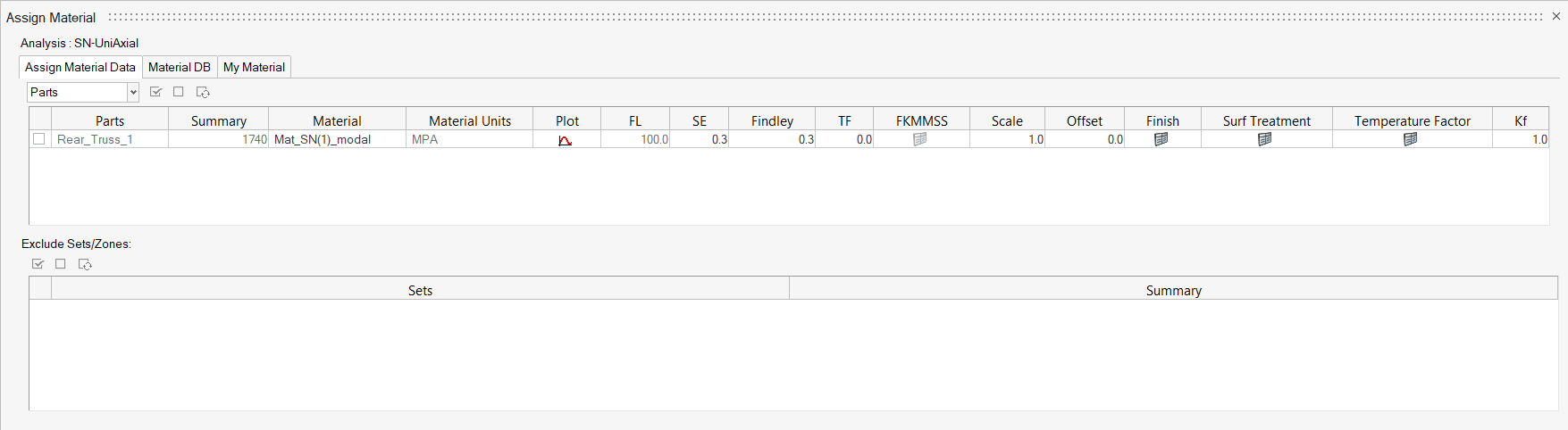

    The Assign Material dialog opens.
  2. Activate the checkbox next to the part Rear_Truss_1.

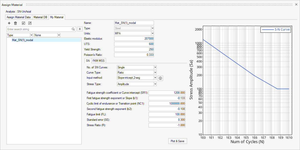

  3. Create a new material.
    1. Click the My Material tab.
    2. Click to create a new material.
    3. Name the material Mat_SN(1)_modal
    4. Set the Elastic modulus to 207000.
    5. Change the Input method to Slope-intcept,2-seg.
    6. Set the UTS to 600.
    7. Set the Yield Strength to 250.
    8. Set Poisson's Ratio to 0.333.
    9. In the SN tab, set the Fatigue strength coefficient or Curve intercept (SR1) to 1208.
    10. Set the Fatigue limit to 100.
    11. Set the Standard error to 0.3.
    12. Accept all other default settings then click Plot & Save.
      Figure 7.
  4. Right-click on Mat_SN(1)_modal and select Add to Assign Material List.
  5. Return to the Assign Material Data tab and select Mat_SN(1)_modal from the Material drop-down menu for Rear_Truss_1.
    The Material list is populated with the materials selected from Material Database and My Material.
    Figure 8.

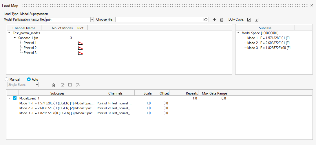

  1. Click the Load Map tool.
    Figure 9.
    The Load Map dialog opens.
  2. From the Channel Type drop-down menu at the top of the dialog, select pch.
  3. Click in the Choose File field and browse for Rear_Truss_modal.pch.
  4. Click to add the modal participation file.
  5. Select Subcase 1(transient) from the loaded pch and Modal Space from the Subcase window, to create an event with all modes.
  6. On the bottom half of the dialog, click .
    ModalEvent_1 is created with 1 repeat.
  7. Activate the ModalEvent_1 checkbox.
    Figure 10.
  8. Exit the dialog.

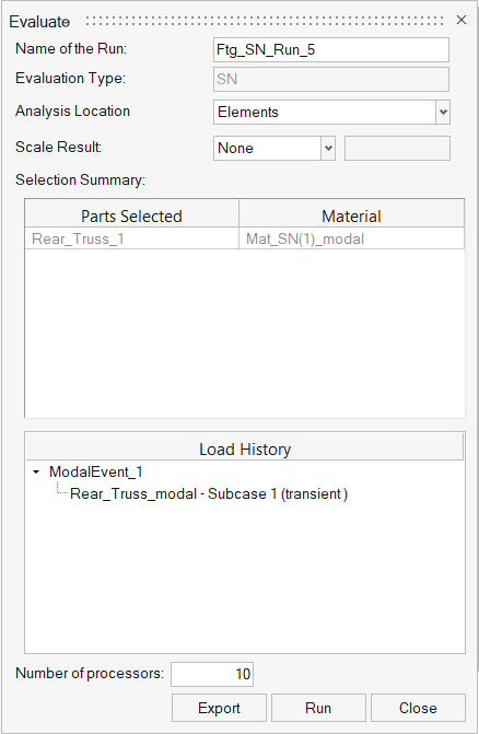

  1. From the Evaluate tool group, click the Run Analysis tool.
    Figure 11.
    The Evaluate dialog opens.
    Figure 12.
  2. Optional: Enter a name for the run.
  3. Click Run.
    Result files are saved to the home directory and the Run Status dialog opens.

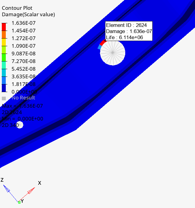

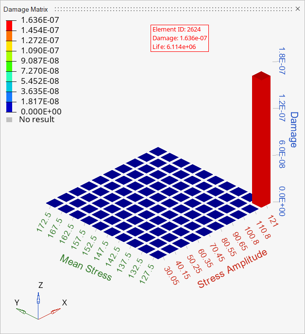

  4. Once the run is complete, click View Current Results.
  5. Use the Results Explorer to visualize various types of results.
    Figure 13.
