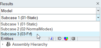

Check That the FE Result File Contains a Frequency Response Function Subcase with Element Stresses
From the Results Browser, click the second drop-down menu
and select Subcase 3 (03-Frf).
If the Results Browser is not open, click from the menu bar.

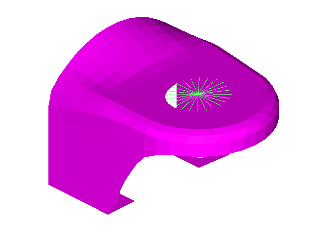

From the View Controls toolbar, click
The Contour panel opens. -
From the panel area, select Element Stresses
(2D & 3D) (t) (c) from the first Result type drop-down
menu.
Figure 4.
Click Apply.
The model is contoured.
- Observe the element stress plot in the modeling window then click Clear Contour in the panel area.
- Exit the Contour panel.

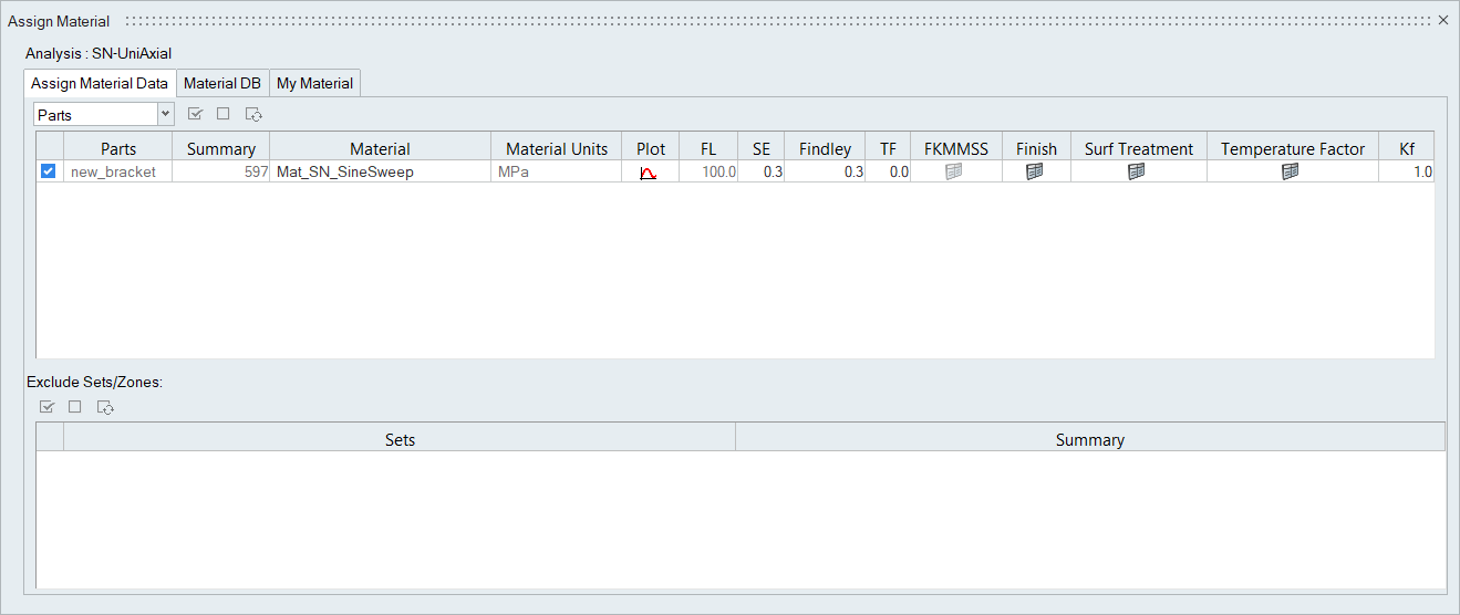

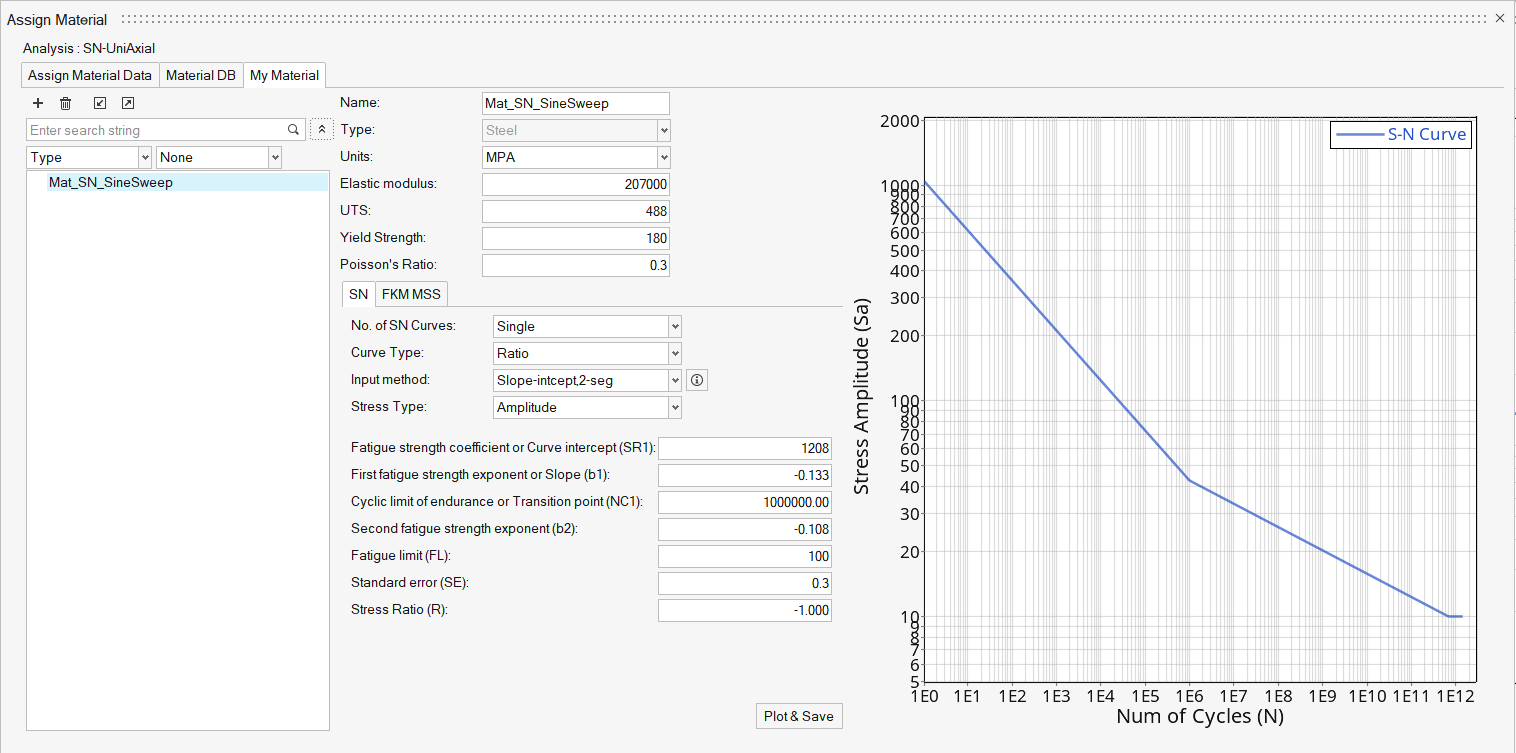

Assign Materials
Click the Material tool.
Figure 7.
The Assign Material dialog opens. - Activate the checkbox next to the part new_bracket.
Create a new material.
- Right-click on Mat_SN_SineSweep and select Add to Assign Material List.
Return to the Assign Material Data tab and select
Mat_SN_SineSweep from the Material drop-down menu for
new_bracket.
The Material list is populated with the materials selected from Material Database and My Material.
Figure 9.
- Exit the dialog.

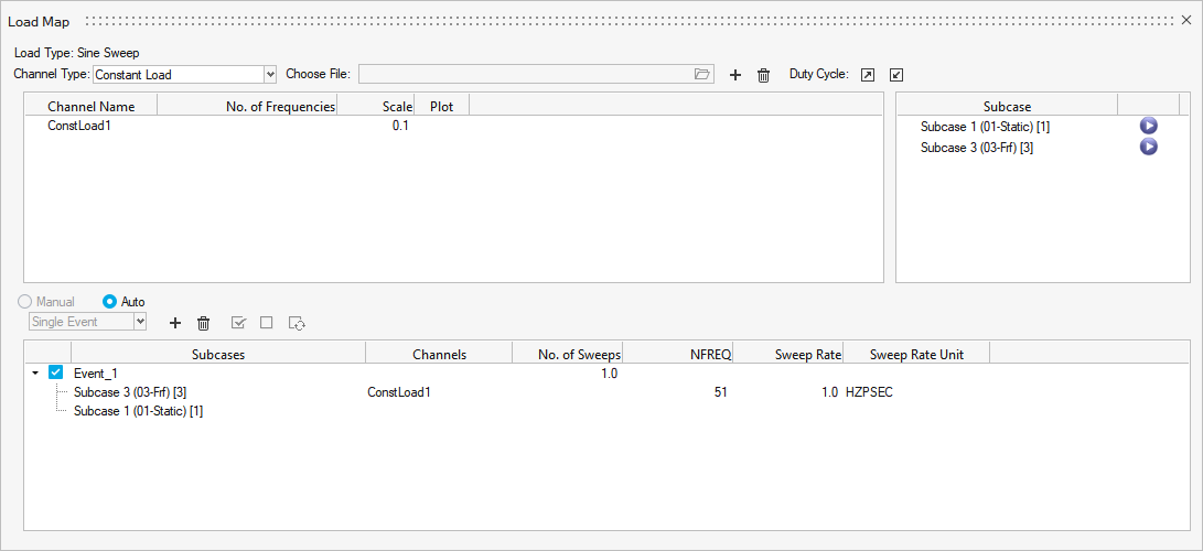

Create a Sine Sweep Event
Click the Load Map tool.
Figure 10.
The Load Map dialog opens.By default, the Channel Type is set to Constant Load.
Click
at the top of the dialog to
add the load case.
Set the Scale value of the constant load to 0.1.
This will scale the frequency response stresses used for the sine sweep calculations.Note: If the Channel Type is set to Variable scale, a Frequency vs Scale .csv file needs to be imported.
- Select both ConstLoad1 and Subcase 3 (03-Frf).
On the bottom half of the dialog, click
to create an Event_1
header.
Accept the default values used for the event then activate the
Event_1 checkbox.
Figure 11.
- Exit the dialog.

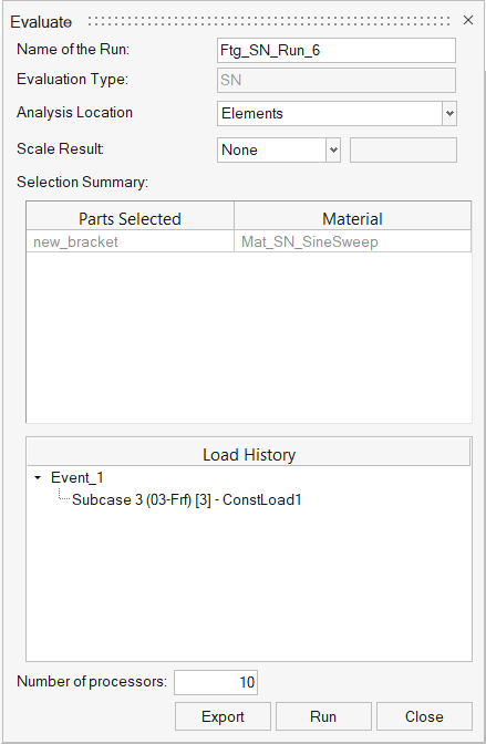

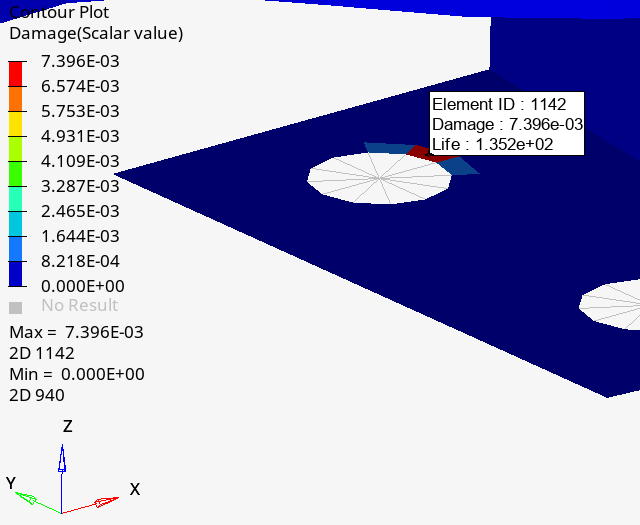

Evaluate and View Results
From the Evaluate tool group, click the
Run Analysis tool.
Figure 12.
The Evaluate dialog opens.Figure 13.
- Optional: Enter a name for the run.
Click Run.
Result files are saved to the home directory and the Run Status dialog opens.

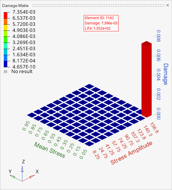

- Once the run is complete, click View Current Results.
Use the Results Explorer to
visualize various types of results.
Figure 14.
Figure 15.
