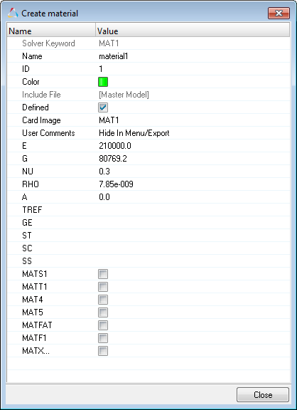

*menustring("MAT1 ")
*menufield(ID,integer,id,8)
*menufield(E,real,$E,8)
*menudefaultvalue(" ")
*menuinitialvalue(210000.0)
*menurestrictedvalue(>,0.0)
*menufield(G,real,$G,8)
*menuinitialvalue(80769.2)
*menufield(NU,real,$Nu,8)
*menurestrictedvalue(>,-1.0)
*menurestrictedvalue(<,0.5)
*menuinitialvalue(0.3)
*menufield(RHO,real,$Rho,8)
*menuinitialvalue(7.85e-09)*defineattribute(E,1,real,none)

Looking at the OptiStruct template, attribute 1 corresponds to the data name E, or Young’s Modulus.
