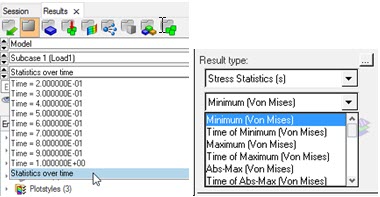

  26. Stress Statistics are only supported for Direct and Modal Linear Transient Analysis. Only Centroid stress is supported and only 2D and 3D elements are currently supported.
    Only H3D output is supported for Stress Statistics.
    The following statistics over time are output for Linear Transient Analysis when STATIS or OSTATIS is specified:
    Statistics
    Supported Stress Result Types
    Minimum
    von Mises, P1 (Major), P2 (Mid), P3 (Minor)
    Time of Minimum
    Maximum
    Time of Maximum
    Abs-Max
    Time of Abs-Max
    Arithmetic Mean
    Root Mean Square (RMS)
    Variance
    Standard Deviation
    After loading the H3D file, the Stress Statistics in HyperView can be viewed.
    Various statistics can be chosen from the sub-menu under Stress Statistics(s).
    Stress Statistics output is also supported for Neuber Stresses. For Neuber stresses, the supported components for statistics output are Maximum, Time of Maximum, Arithmetic Mean, RMS, Variance, and Standard Deviation.
