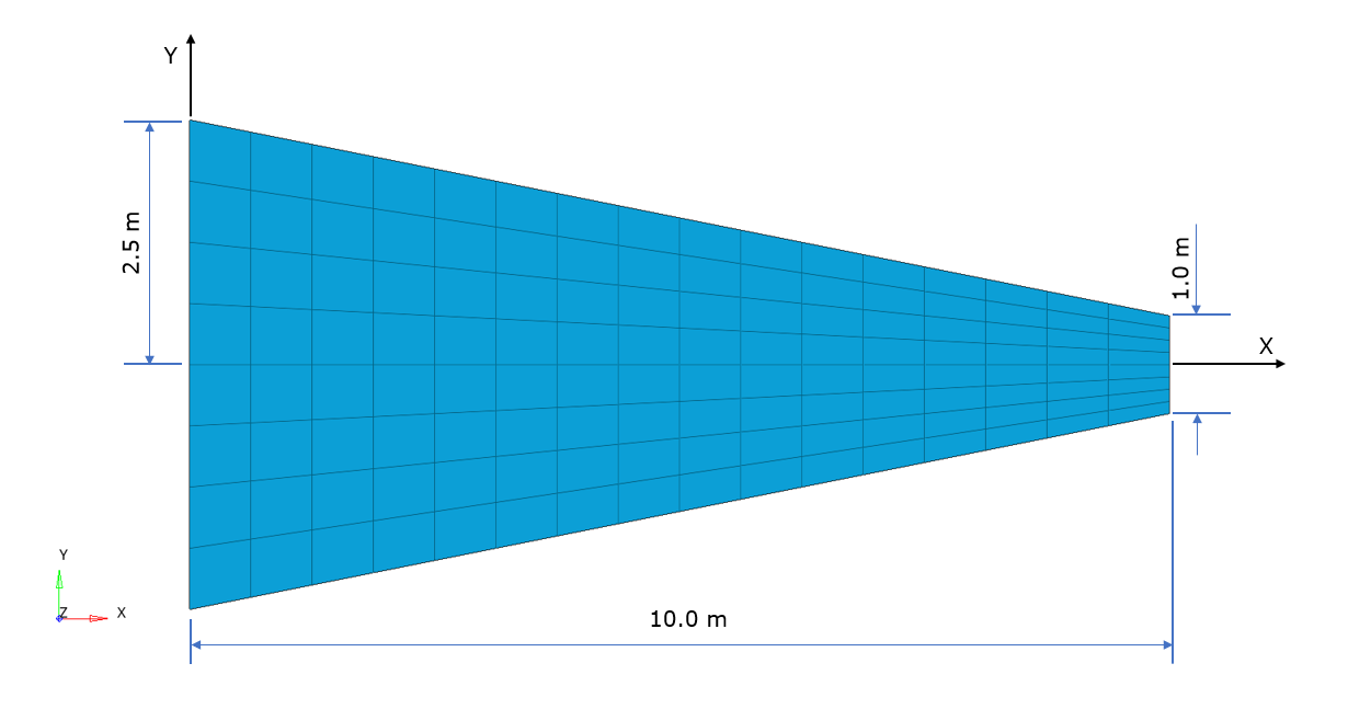

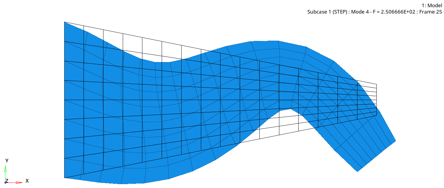

Test No. FV32 A tapered membrane problem with irregular mesh. The geometry and mesh symmetry are maintained along the x-direction. The shear behavior of membrane elements in Normal Modes Analysis is examined using OptiStruct.
Model Files
Benchmark Model
In test FV32, 4-node quad elements (CQUAD4 Lower Order Element [LOE]) with 16x8 mesh configuration are used. The taper starts with the model spanning 5.0 m in the y-direction to 1.0 m. Displacements in the z-direction are fixed on all nodes and the x- and y-translation displacements are fixed for the nodes on the 5.0 m edge along the y-axis.

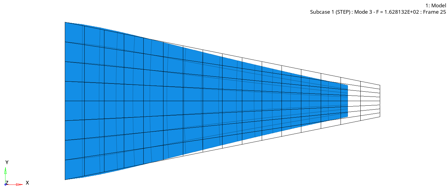

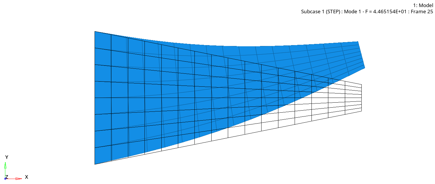

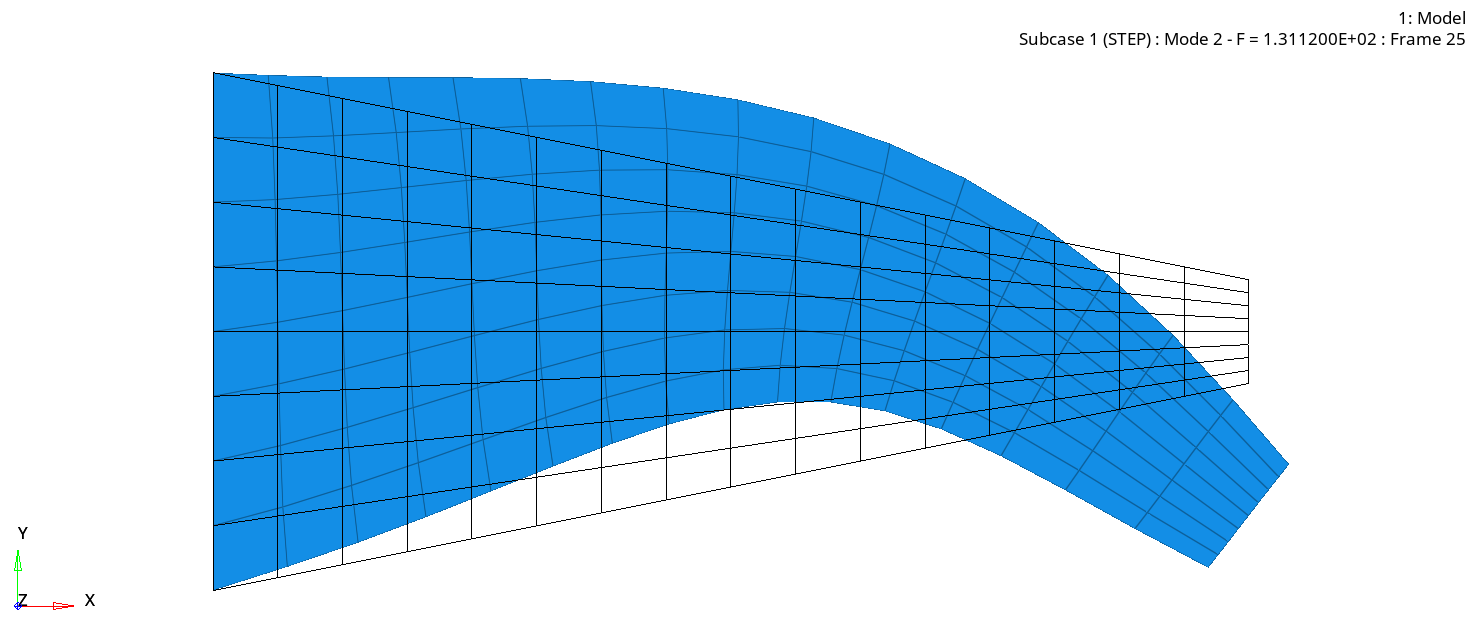

Modal Analysis Results
f*- Closed form solution
| Mode 1 | Mode 2 | Mode 3 | |||
f*=44.61
HzNormalized=1.001 |
f*=131.120
HzNormalized=1.008 |
f*=162.813

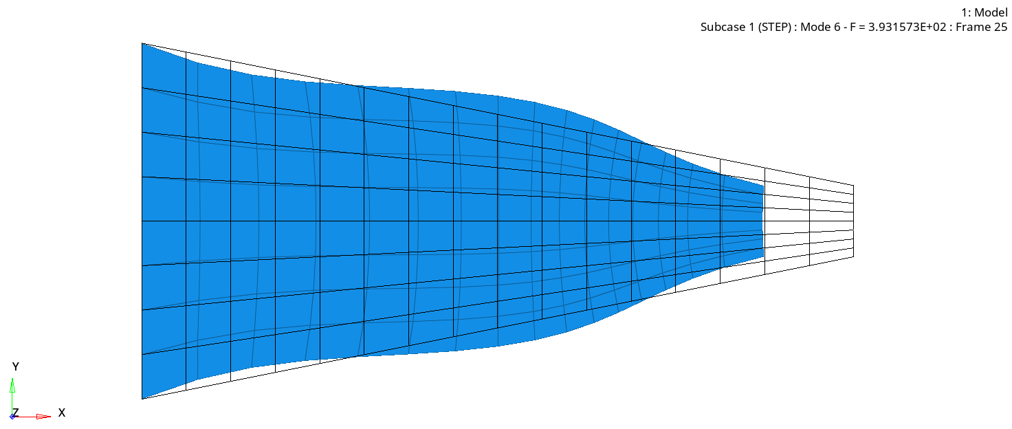

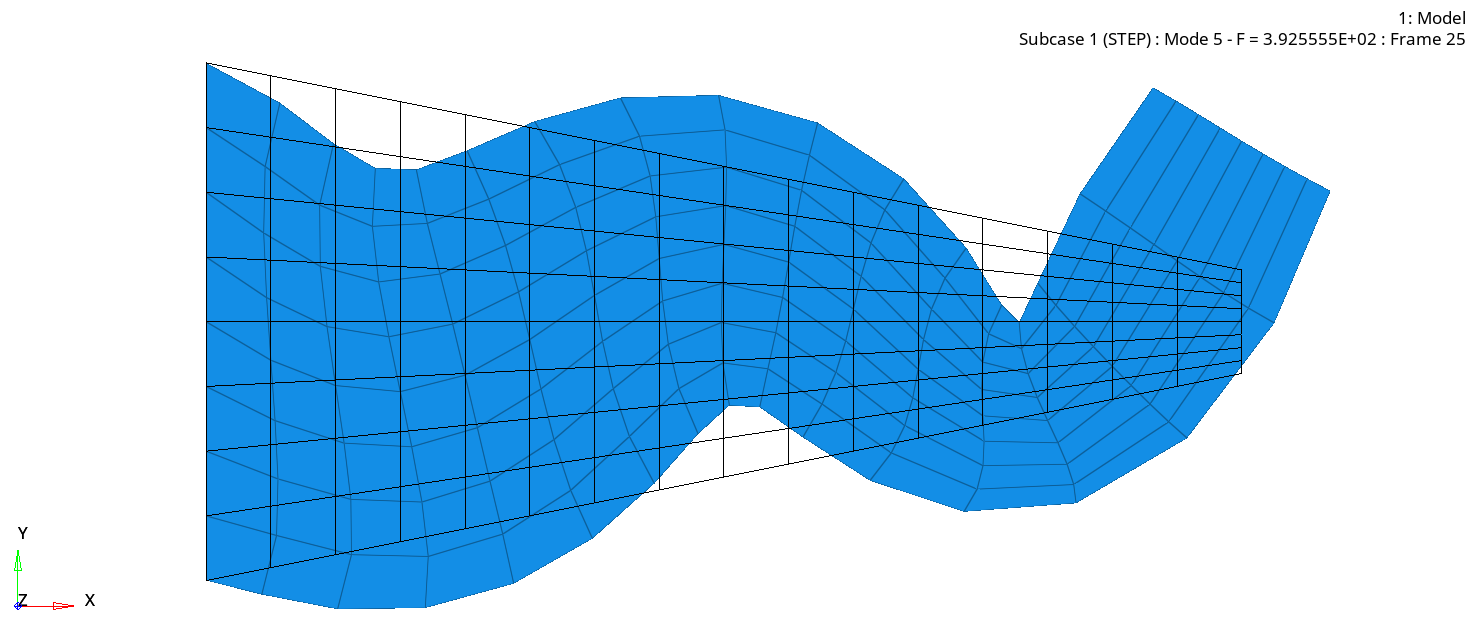

| Mode 4 | Mode 5 | Mode 6 | |||
f*=250.666
f*=392.555
HzNormalized=1.033 |
f*=393.157
HzNormalized=1.004 |
