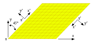

Benchmark Model
The 4-node quad elements with 12x12 mesh configuration are used to model the thin rhombic plate. The x-translation, y-translation displacements, and z-rotational displacements are fixed for all of the nodes. In addition, the z-translation, x-rotational and y-rotational are fixed for the nodes along the four edges.
