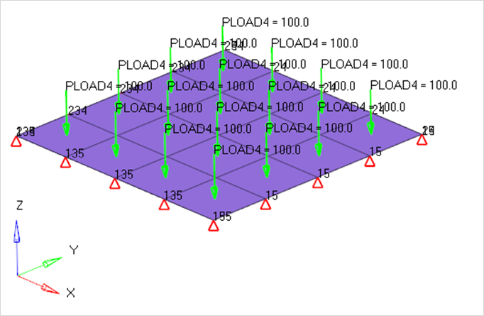

Benchmark Model
Quad4 elements are used to create Ply laminates and with SMCORE for the simply supported one quarter model. A uniform normal pressure of 200 psi is applied on the plate.
