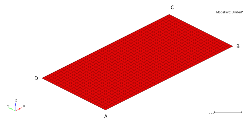

Benchmark Model
1. Composite Laminate Shell Subjected to Uniform Constant Temperature
表 2 lists out all the computed ply failure indices from OptiStruct (OS) based on Tsai-Wu, Hill and Hoffman failure criteria. 800 mesh elements of CQUAD4 element type were used in this study. The model is pinned at point A using a SPC card and a uniform thermal load of 150 °C is applied throughout the domain using a TEMP card.

The geometry of the composite laminate:
Dimension
Value
Length (m)
0.2
Breadth (m)
0.1
