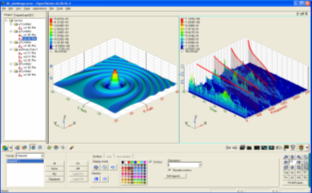

Visualize Results - Animation and Request Plots
- Easily grasp the physical phenomena.
- Quickly detect errors.
- Create compelling presentations.
These images illustrate the Altair HyperWorks powerful tools for visualizing the results of multibody simulations in the form of 2D and 3D plots and animations.

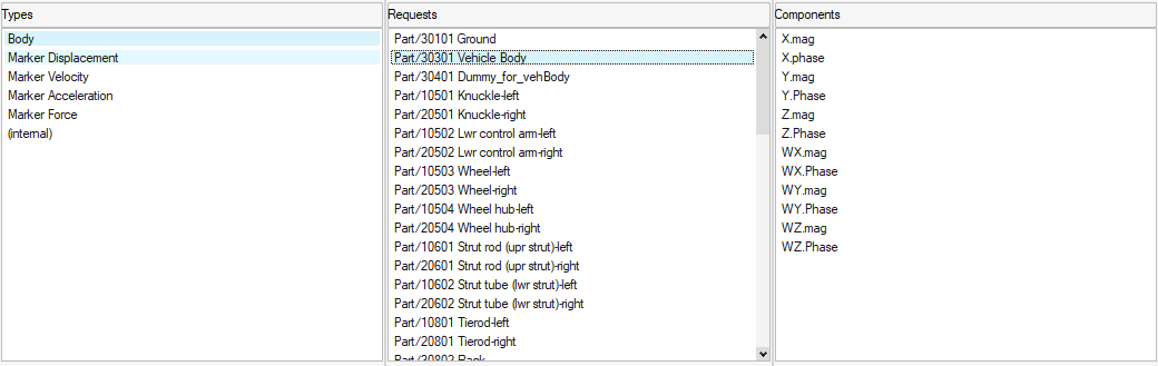

An example of organizing plot data into Type, Request and Component categories.
The following table displays the pre-defined components for each request type.
| Type | Component | Description |
| Marker Displacement | DM, DX, DY, DZ | Magnitude and X, Y, Z components of displacement. |
| E0, E1, E2, E3 | Orientation in Euler parameters. | |
| PSI, THETA, PHI or YAW, PITCH, ROLL angles | Orientation of the principle inertia axes expressed in either Euler Angles (B313) or YAW, PITCH, ROLL angles. The choice is made by specifying the ANGLE_TYPE attribute in the Output: Results command. | |
| Marker Velocity | VM, VX, VY, VZ | Magnitude and X, Y, Z components of velocity. |
| WM, WX, WY, WZ | Magnitude and X, Y, Z components of angular velocity of the principle inertia axes. | |
| Marker Acceleration | ACCM, ACCX, ACCY, ACCZ | Magnitude and X, Y, Z components of acceleration. |
| WDTM, WDTX, WDTY, WDTZ | Magnitude and X, Y, Z components of angular acceleration of the principle inertia axes. | |
| Marker Force | FM, FX, FY, FZ | Magnitude and X, Y, Z components of force. |
| TM, TX, TY, TZ | Magnitude and X, Y, Z components of torque. | |
| Expressions | F1, F2, ..., F8 | Vectors containing evaluated expressions. |

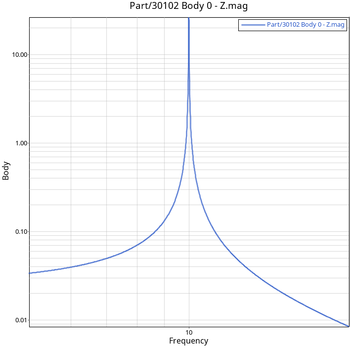

| Body | X mag, Y mag, Z mag, WX mag, WY mag, WZ mag | Magnitude of frequency response in each direction. |
| X phase, Y phase, Z phase, WX phase, WY phase, WZ phase | Phase of frequency response in each direction. | |
| FlexBody | X mag, Y mag, Z mag, WX mag, WY mag, WZ mag | Magnitude of frequency response in each direction. |
| Q/i mag, i = 1, 2, ..., n | Magnitude of frequency response of each mode. | |
| Q/i phase, i = 1, 2, ..., n | Phase of frequency response of each mode. | |

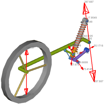

Forces and Moments
Outline

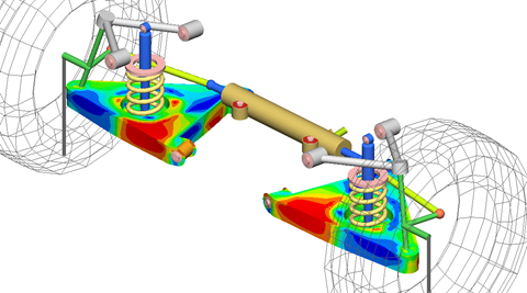

Flexible Bodies
- Contour plots
Figure 6. Result Contours for CMS Flexible Control Arms for a SLA Suspension Model

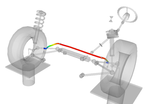

Figure 7. Result Contours for an NLFE Stabilizer Bar in a Front Suspension Model

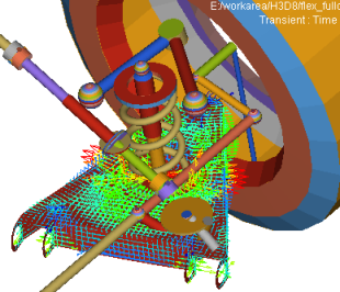

You may contour results of various types including displacements, rotation (CMS only), velocity (CMS only), acceleration (CMS only), strain, and stress. For strain and stress, you must request the corresponding modes to be computed during the component mode synthesis solution for a CMS flexible component; for an NLFE body, these are written to the H3D by default.
Note: The NLFE element results are always written in NODAL format whereas the CMS flexible results can be written in NODAL or MODAL format (this is controlled by the FORMAT_OPTION) attribute in the H3DOutput command statement. - Vector plots

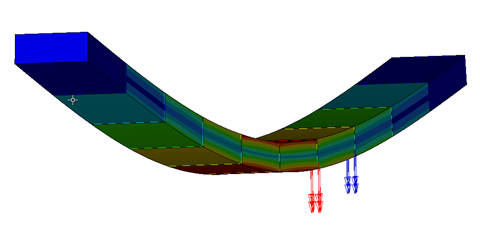

Figure 8. Displacement Vectors for an NLFE Beam Superimposed on the Stress Contour Plot
You may create vector plots of the following data types: displacement, velocity (CMS only), acceleration (CMS only), force (CMS only), and moment (torque, CMS only). The vectors may be resolved in a variety of coordinate systems. Scaling and querying are also supported. The vector plots can also be overlaid over the stress contour plots.

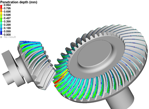

During a simulation that contains rigid body contact elements, MotionSolve computes a number of contact related quantities like normal force, friction force, slip velocities etc. These are written to the H3D after the simulation so that they can be visualized in HyperView.
- Contact summary frame:The contact summary frame is a single frame in HyperView which allows you to visualize the maximum penetrations that occurred in your 3D geometries over the length of the entire simulation. A sample contact summary frame is shown below (in exploded view).
Figure 10. Contact Summary Frame for Bevel Gears in Contact
MotionSolve writes an additional load case, called “Contact Overview” to the animation H3D file when the model contains active 3D rigid body contact(s). Within this load case, you can create a contour plot defined by maximum penetration depth.
The summary frame allows you to quickly check for excessive penetrations in your simulation before animating it. It can also be used to assess whether the areas where contact occurred are as expected. For more information on the contact summary frame, please see the Post-processing section in 3D Mesh-to-Mesh Contact Simulation.

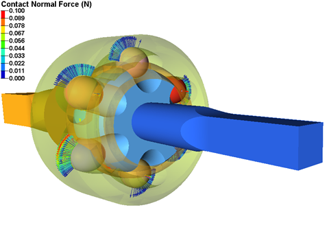

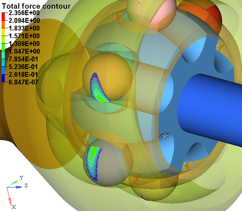

- Vector plots:You may also use vector plots to display contact forces and velocities. In addition to the total contact force, you can visualize several other results including contact friction force:
Figure 11. Contact Related Vector Plot Results
Figure 12. Normal Contact Force for a Constant Velocity Joint Geometry
You can plot these vectors for each triangular element on the rigid body or for a contact region.
- Contour plots:You may also use vector plots to display contact forces and velocities. In addition to the total contact force, you can visualize several other results including contact friction force:
- Contact force (including normal and friction force)
- Contact velocity (including normal and tangential velocities)
- Contact penetration depth
Figure 13. Total Contact Force Contour for a Constant Velocity Joint Geometry

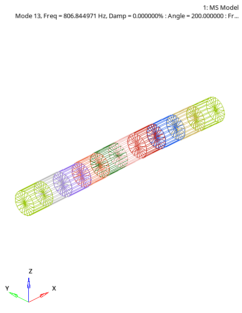

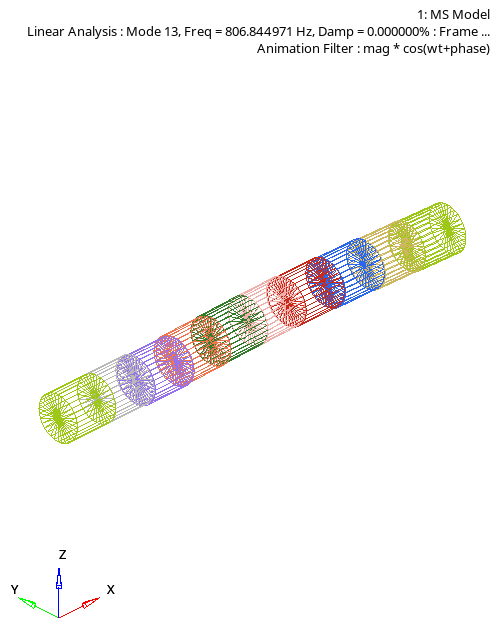

Linear Modes
- MotionSolve computes and writes the displacements for each mode as transient results from 0 to 360 degrees from complex results in the *..h3d file.
- MotionSolve writes the complex nodal
displacement to H3D in the
_linz.h3d file, and HyperView performs the modal animation.
Figure 14. Linear results from H3D results
Figure 15. Linear results from Linz H3D
