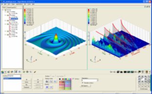

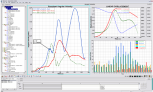

- HyperGraph 2D
- HyperGraph 2D is a graphical post-processor that
enables you to create 2-D plots from MotionSolve results and
perform detailed engineering calculations on them.
Figure 3.

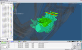

- HyperGraph 3D
- HyperGraph 3D is a
graphical post-processor that enables you to create 3-D plots from MotionSolve results for visualizing system behavior.
Figure 4.

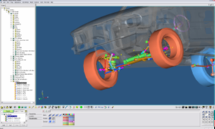

- HyperView
- HyperView is a graphical post-processor that
enables you to animate MotionSolve results and evaluate
overall system behavior.
Figure 5.

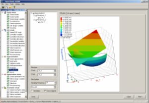

- HyperStudy
- HyperStudy not only enables you to gain insight
into your system model using Design of Experiments (DoE) techniques, but
also optimizes your model to achieve the desired performance. You can also
use stochastic analysis to assess the risk in your mechanism designs.
Figure 6.

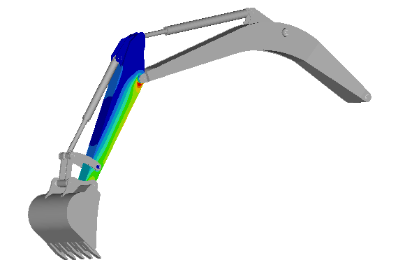

- OptiStruct
- OptiStruct, an FEA solver, lets you reduce
detailed finite element models into computationally efficient flexbody
representations using component mode synthesis (CMS) techniques. The
flexbodies can then be used in MotionSolve to capture part
compliances providing a significant accuracy improvement over rigid body
models.
Figure 7.
