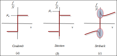

Friction is highly non-linear and dependents on system states like stiction regime, transition regime and sliding (or) dynamic regime.
- Dynamics of friction
- Friction-velocity relation or damping characteristics of friction will aid in dampening vibrations. There are other behaviors of friction such as pre-sliding and hydrodynamic effects of lubrications during dynamic simulations. Resistant forces from the above mentioned effects need consideration in design of drive systems and high-precision servo mechanisms. So, it’s important to model friction accurately to capture system dynamics.

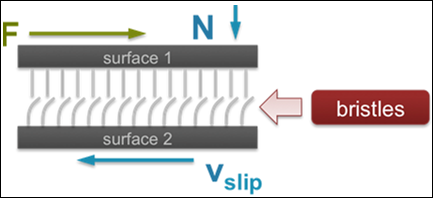

- Characterizing joint friction using LuGre friction model
- MotionSolve uses LuGre model for friction representation. LuGre model is a bristle model emerged for controls applications. LuGre model was presented by Canudas de Wit, Olsson, Åstro¨m, and Lischinsky. Stemming from a collaboration among researchers at the Lund Institute of Technology (Sweden) and in Grenoble France (Laboratoire d’Automatique de Grenoble), the LuGre model captures a variety of behaviors observed in experiments, from velocity and acceleration dependence of sliding friction, to hysteresis effects, to pre-slip displacement and lubrication.

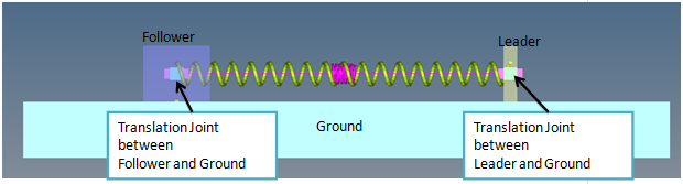

The leader and follower model constitutes two rigid bodies namely Leader and Follower respectively connected to the Ground body by translation joints and inter connected by a linear spring. In the following steps you will add friction and apply motions to study friction behavior of the translation joint.

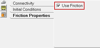

- From the Joints panel, go to the Friction Properties tab.
From the Friction Properties tab, check the Use Friction
option to activate friction on joint.

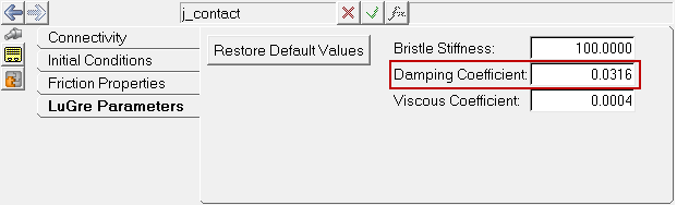

Select the LuGre Parameters tab to modify the Bristle properties. Modify the
Damping Coefficient value to 0.0316.
Figure 6.
Note: Default properties of bristle are appropriate with units N, mm, second. - Leave all the LuGre parameters at their default values.

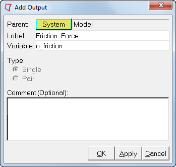

The Add Output dialog is displayed. - Change the Label to Friction_Force.
Change the Variable to o_friction.
Figure 7.
- Click OK to add output request.

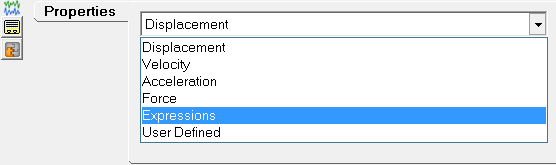

From the Properties tab, select the output type as
Expressions.
Figure 8.

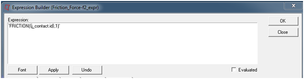

The Expression Builder dialog is displayed. -

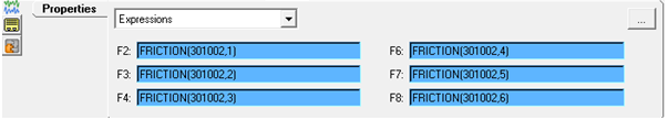

Populate the Expression Builder with the FRICTION function expression as:
`FRICTION({j_contact.id},1)`.- Follower Translation Joint ID
= {j_contact.id},- Fx component
= 1
Figure 9.
- Click OK.
Repeat the process for F3, F4, F6, F7, and F8 by changing the second parameter
to 2, 3, 4, 5, and 6 accordingly.
The function FRICTION(ID, comp) computes the friction force component specified in the comp corresponding to the joint ID.

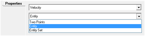

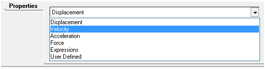

Velocity.
Figure 11.

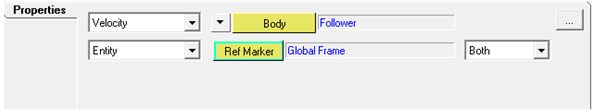

Select Entity from the drop-down menu below
Velocity.
Figure 12.
Select entity type to be
Leave
to be Global Frame.

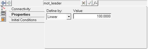

- For Label, enter Stick Slip.
- For Variable, enter mot_leader.
- Click OK to add motion.
From the Connectivity tab:
From the Properties tab:

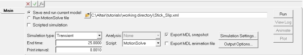

Switch to the Run panel by clicking on the Run icon
Under the Main tab, click on the
icon
to specify the name and location of the MotionSolve
.xml file. Save the file with the name
Stick_Slip.xml in your working directory.
Figure 16.
- Notice that after saving the file, the Run button to the right becomes active.
- Specify the End time as 25 sec. Modify the Print interval value to 0.001 and leave the remaining values at their default settings.
- Click on the Run button to run the simulation.

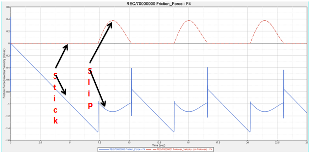

Plot Follower velocity versus Time.
Plot Friction force versus Time.
- Select X-axis Data Type as Time.
- Select the following Y-axis data:
Option Description Y Type Expression Y Request Friction_Force Y Component F4 Figure 17. Animation and Plot Windows
To start the animation, click the Start/Pause Animation
icon on the toolbar.

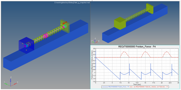

The Stick_Slip motion is clearly observed from the animation and plots.
Figure 18. Velocity and Friction Force on Time Scale
The Leader body moving at a constant velocity elongates the spring increasing spring force linearly. The friction force counteracts the spring force, and there is a small displacement of Follower body when the applied force reaches the break-away force.
Break away force = mu static x Normal Load = 0.15x1x9.81 = 1.47 Newton.

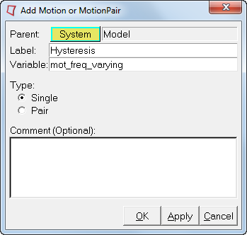

The Add Motion or MotionPair dialog is displayed. - For Label, enter Hysteresis.
For Variable, enter mot_freq_varying.
Figure 19.

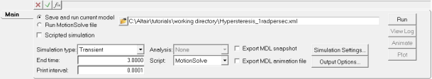

icon
Hysteresis_1radpersec.xml in your working
directory.
Specify the End time as 3 seconds and the Print interval
value as 0.0001 seconds.
Figure 24.

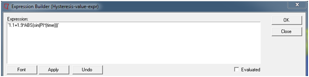

Modify the velocity expression of the Follower Translation Joint and run the
model with the file names and end times specified in the table below:
Frequency Expression File name End Time (sec) 10 rad/sec `1.1+1.9*ABS(sin(PI*(10*time)))`Hysteresis_10radpersec.xml 0.3 25 rad/sec `1.1+1.9*ABS(sin(PI*(25*time)))`Hysteresis_10radpersec.xml 0.12

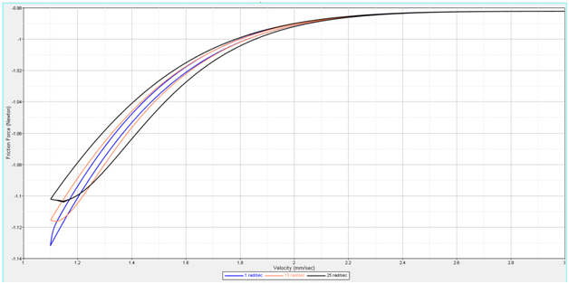

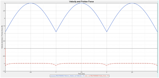

Plot Hysteresis Curves
- Select HyperGraph by clicking in the window.
Load results for the 1 rad/sec frequency.

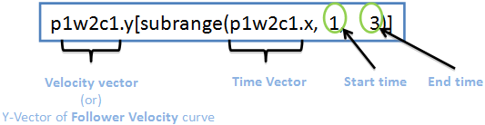

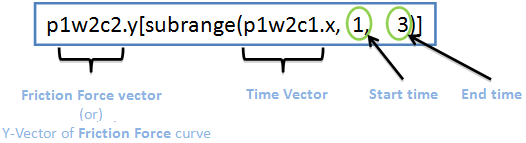

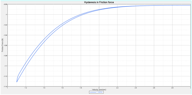

Plotting Friction Hysteresis curve (Friction Force versus Velocity).
There is an initial transition of friction force values, therefore you will plot hysteresis curve excluding first cycle data (in other words, 0 to 1 sec.).
Similarly, plot hysteresis curves for frequencies 10rad/sec
(Hysteresis_10radpersec.abf) and 25 rad/sec
(Hysteresis_10radpersec.abf) following Steps 3 -5
above.
Figure 33. Hysteresis Curves at Different Frequencies
The velocity variation with higher frequency will have widest hysteresis loop.
