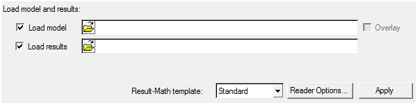

On the Standard toolbar, click the
(Load Results) icon.
Figure 2. Load model and results panel
In the panel that appears, click the Load model file
browser
and select the file
single_pendulum.h3d from your <working
directory>.
The Load results field will be automatically populated with the same path and name. -
Click Apply.
HyperView loads the animation file.

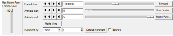

On the Animation toolbar, click
(Animation Controls).
In the panel that appears, you can control parameters like speed, start time, and end time of the animation.Figure 3. Animation Controls panel
- Drag the vertical slider bar on the left to change the animation speed from fast to slow.
- Current time: show all the time steps.
- The Animate start and Animate end sliders can be set to restrict the animation to a certain window in time. For example, moving the start slider to 0 and end slider to 3.5 to restrict the animation to these time limits and covers only a partial cycle of motion.

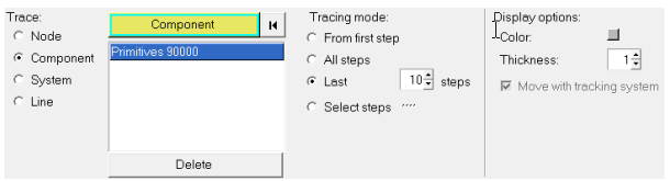

To trace the pendulum motion, click the
(Tracing) button.
Figure 4. Tracing panel
- Under Trace select the Component radio button.
- Pick the entity/component that needs to be traced by clicking on it from the modeling window.
Change the view to the
(Iso) view.
- Under Tracing mode select Last and specify 10 as the steps.
Animate the model.
This displays the last 10 steps in the animation.
- To turn the tracing off, click the Delete button to remove the selected components from the tracing list.
- Try the From First Step and All Steps options.
- Use the Display Options to change the line color and thickness.

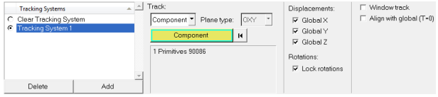

On the Results toolbar, click the
(Tracking) button.
Figure 5. Tracking panel
The Tracking panel allows you to track or fix any part of your model in the center of the animation window and to see all the other parts moving with respect to the fixed part.
- Under Tracking Systems, click the Add button to add a tracking system to the animation.
- In the Track pull-down menu, select Component. Then click on any part of the model currently loaded.
- Select the Displacements and/or Rotations to track the selected part.

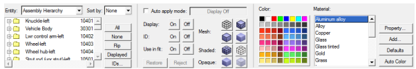

On the Visualization toolbar, click the
(Entity Attributes) panel button.
Figure 6. Entity Attributes panel
In the panel, click the arrow to the right of the Entity
option menu to expand it.
The list contains the following entity types: Components, Systems, Assembly Hierarchy, and Sets.
- Select Assembly Hierarchy from this list to show all the parts of the model in the entity list tree below.
Change the color of the model.
- From the Entity option menu, select Assembly Hierarchy.
- Next to the entity list tree, select the All button.
- Under Color, select a color from the palette.
Change the model to wire frame.
- Next to the entity list tree, select theAll button.
Click the
(Wire Frame) icon.
Make the model transparent and shaded.
Click the
(Shaded) icon.
Click the
(Transparent)
icon.
- Use the On/Off buttons to turn the entities on or off.
- Use the On/Off buttons next to ID: to display and hide the entity IDs.
