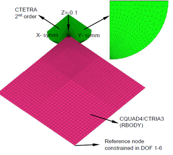

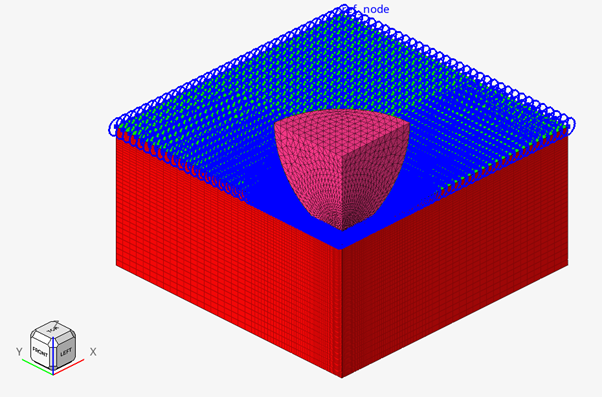

The cross-section of the half-space in the ¼ FE model is 100x100.
Figure 2. Model Details

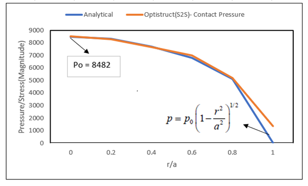

Results
Table 1.
Pressure/Stress (Magnitude) r/a
Analytical Result OptiStruct (S2S)-Contact Pressure
8482 8525 0
8350 8300 0.2
7700 7675 0.4
6800 6990 0.6
5100 5200 0.8
0 1345 1
Figure 3. Analytical Results versus OptiStruct Results
The results from FEA are in good agreement with the analytical solution.

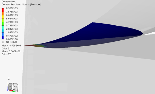

Figure 4. Contact Traction/Normal (Pressure)

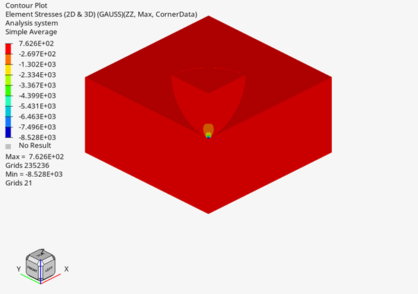

Figure 5. Stresses 2D and 3D - Z Stress

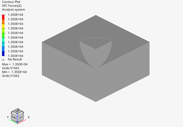

Figure 6. SPC Forces
