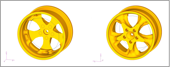

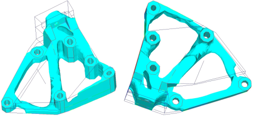

Example: Engine Bracket
engbrack
Figure 1. Engine Bracket Design with Draw Direction Constraint
engbrack2
Figure 2. Engine Bracket Design with Draw Direction and Maximum Member Size Constraints
Example: Steering Wheel Bracket
steerbrack
Figure 3. Steering Wheel Bracket Design with Draw Direction Constraint
steerbrack2
Figure 4. Steering Wheel Bracket Design with Draw Direction and Maximum Member Size Constraints

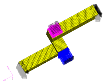

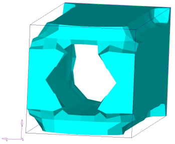

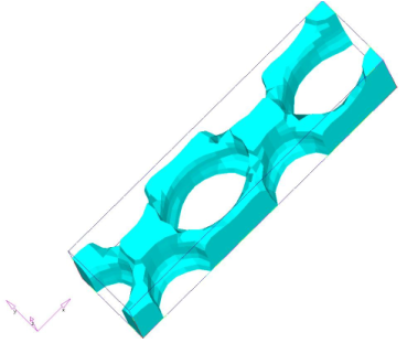

Example: Beam under Torsion
The considered beam is clamped on one end and loaded with a pair of twisting forces on the free end. The finite element model is shown in Figure 5. The design problem is to minimize the compliance with a volume fraction constraint of 0.3. The final design without draw direction constraints is shown in Figure 6. The chosen draw direction is along the Z-axis. The designs with the options SINGLE and SPLIT for draw direction constraint are shown in Figure 7 and Figure 8, respectively.
cast1
Figure 5. Finite Element Model of the Beam Under Torsion
cast2
Figure 6. Design Without Draw Direction Manufacturing Constraint
cast3
Figure 7. Design With Draw Direction Z and Die Option SINGLE
cast4
Figure 8. Design With Draw Direction Z and Die Option SPLIT
As expected, the result without manufacturing constraints is a tube-like structure that is indeed the optimal topology for torsion load. However, this design does not permit the sliding of the die in the Z direction. The result that allows the sliding of the die for casting is not very intuitive, it forms a periodical X pattern to cross the pair of twist loads until they reach the supported end. Significantly more material at the crossing point reflects the doubled shear force at this point. Compared to an upward facing C channel solution, the cross pattern has the advantage that the stress is periodical in every X cell, thus eliminating higher order influence of the span of the beam for any solution that has system level bending action.

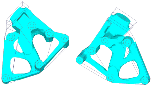

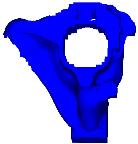

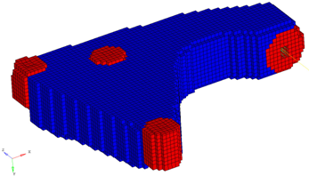

Example: Compressor Mounting Bracket
A topology optimization is run on a compressor mounting bracket, and the effects of the NO HOLE manufacturing constraint will be showcased. The finite element model is shown in Figure 12. Regions in red indicate non-design space and the region in blue indicates design space. Four different loading conditions were considered representing operating conditions, and the model was built up with approximately 90,000 elements. The design problem was formulated to minimize the compliance as the objective function, with a constraint on the design volume fraction.
Figure 13 shows the design proposal for the compressor mounting bracket without the use of the NO HOLE manufacturing constraint. As seen in the image, the design contains through-holes.
Figure 14 on the other hand, shows the design proposal of the bracket with the use of the NO HOLE constraint. In this case, the resulting design proposal does not contain any through-holes.
draw_direction_constraints_eg3_1
Figure 12. Finite Element Model Representing the Design and Non-design Spaces of the Compressor Mounting Bracket
draw_direction_constraints_eg3_2
Figure 13. Design Proposal Without the NO HOLE Option
draw_direction_constraints_eg3_3
Figure 14. Design Proposal With the NO HOLE Option

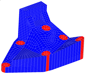

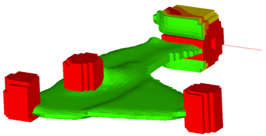

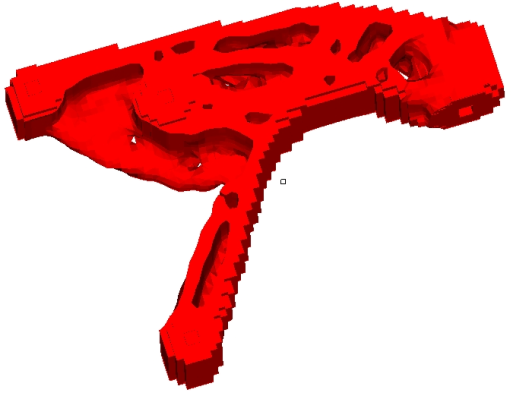

Example: Automotive Bracket
The bracket here was designed incorporating the NO HOLE constraint along with the STAMP constraint. The goal of the study was to generate a design proposal without any through-holes, while at the same time being interpretable as a sheet metal design. The STAMP constraint here forces the formation of a 3D shell interpretable structure representing a sheet metal design. Four subcases representing four different loading conditions were considered and the model was comprised of approximately 20,000 elements. The optimization problem was formulated to minimize the weighted compliance (one compliance value per subcase) for a constrained design volume fraction. This essentially results in evolving the stiffest design for a given amount of material.
Figure 15 represents the finite element model of the design and non-design spaces of the bracket. The regions in red are the non-design regions and the region in blue is the design space.
Figure 16 is the design proposal without the consideration of the STAMP and NO HOLE manufacturing requirements. While it is possible to cast such a design, stamping such a part is not feasible.
Figure 17 and Figure 18 showcase the design proposal after incorporating the STAMP and NO HOLE manufacturing constraints. The NO HOLE constraint prevents the formation of any through-holes in the design space and helps keep a continuous shell layout, while the STAMP constraint leads to the formation of a uniform thickness design proposal. The thickness is defined along with the STAMP constraint and represents the desired thickness of the sheet metal part. From this proposal, it is now possible to interpret the design as a sheet metal or stamped part.
draw_direction_constraints_eg4_1
Figure 15. Finite Element Model Representing the Design and Non-design Spaces of the Bracket
draw_direction_constraints_eg4_2
Figure 16. Design Proposal Without 'STAMP' and 'NO HOLE'
draw_direction_constraints_eg4_3
Figure 17. Design proposal With 'STAMP' and 'NO HOLE' (view 1)
draw_direction_constraints_eg4_4
Figure 18. Design Proposal with 'STAMP' and 'NO HOLE' (view 2)

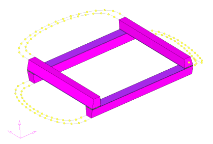

Example: Curved Beam

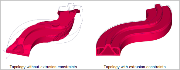

In this example, a curved beam is considered to be a rail over which a vehicle is moving. Both ends of the beam are simply supported. A point load applied over the length of the rail as five independent load cases simulates the movement of the vehicle. The objective is to minimize the sum of the compliances, and the material volume fraction is constrained at 0.3. The rail should be manufactured through extrusion. The 13 grids represented as black dots on the right figure define the extrusion path.
ext45
Figure 21. Curved Beam
The optimized topologies without and with extrusion constraints are shown in Figure 22. Reanalyzing the final designs without penalty for intermediate density, the compliances for these two designs are 29.9396 and 37.4377 respectively, which implies a 20% loss in performance due to extrusion constraints. The extruded design represents a clean proposal that requires little refinement. On the other hand, the design obtained without manufacturing constraints may require significant modifications that could cause efficiency loss in performance.
ext5
Figure 22. Extrusion Constraints

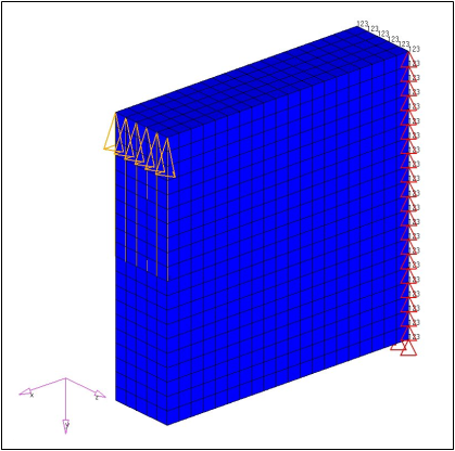

Example: Block Models

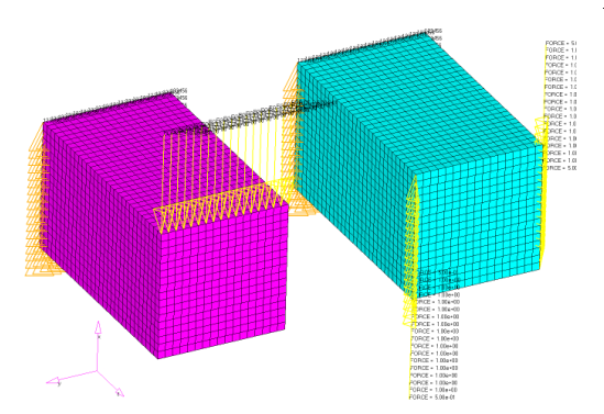

This example shows how pattern repetition may be used to generate the same topology in different parts. The first figure shows two similar blocks loaded in two different ways. The optimization problem is to minimize the compliance with 30 percent volume fraction.
patrep3
Figure 29. Similar Blocks Loaded in Two Different Ways
If pattern repetition is not used, the optimized topologies are different, as shown in Figure 30 and Figure 31.
patrep4
Figure 30. Same View as in the First Figure
patrep5

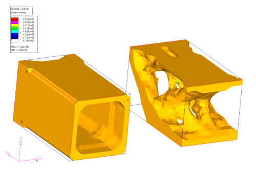

Figure 31. Back View Showing that the Turquoise Block is Hollowed Out
Using pattern repetition, both of the loads on the main (the left hand block in first figure) and the loads on the secondary are taken into account, and the optimized topology is repeated for both blocks (Figure 32).

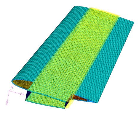

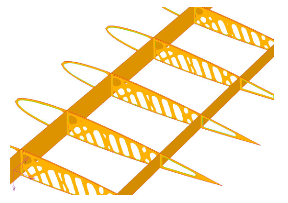

Example: Simplified Wing Model
patrep7
Figure 33. Simplified Wing Model

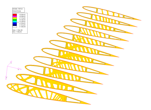

The internal wing structure consists of 2 spars and 11 ribs. In this example, each rib is subdivided into three sections; the nose section, the center section and the tail section, and each of these sections is chosen as a topology design region.
patrep8
Figure 34.
The optimization problem is to minimize compliance for 30 percent of the design volume fraction. Here you see the optimized topology when each region is independent.
patrep9
Figure 35. Optimized Topology of Independent Region
Pattern repetition is used to group all of the noses together, all of the centers together and all of the tails together, resulting in 3 main pattern definitions, each with 10 secondary definitions. Notice how different meshes are used for each rib; pattern repetition is mesh independent. Also the wing tapers, so the outboard ribs are shorter and thinner than the inboard ribs, scaling is defined for the secondary so that the pattern fits in the design space.
patrepa
Figure 36.
The optimized topology achieved using pattern repetition (Figure 37), and you can see how the same topological layout is repeated for each rib.

Cyclical Symmetry
Cyclical symmetry can also be defined through the use of pattern grouping.
With cyclical pattern grouping, the design is repeated about a central axis a number of times determined by you. Furthermore, the cyclical repetitions can be symmetric within themselves. If that option is selected, OptiStruct will force each wedge to be symmetric about its centerline.
To define cyclical symmetry, it is necessary to provide an anchor grid and a reference grid. The axis of symmetry runs from the anchor grid to the reference grid. It is also necessary to specify the number of cycles; the repetition angle will be automatically computed.
Figure 42.
To add planar symmetry within each wedge, a second reference grid needs to be provided. The plane of symmetry is determined by the anchor grid and the two reference grids.
Figure 43.
Draw Constraints
Draw direction constraints can be combined with pattern grouping.
As illustrated in Figure 44, the sense of the vector defining the symmetry also determines the primary side of the design space to which the draw direction applies. The draw direction for the secondary side of the design space is automatically computed.
Figure 44. One-plane Symmetry
The same reasoning applies for two-plane and three-plane symmetries, as well as for cyclical symmetry.
Caution should be used in order to achieve manufacturable designs. With cyclical symmetry, for instance, the draw direction should be parallel to the axis of symmetry.
Currently extrusion constraints cannot be used simultaneously with pattern grouping.

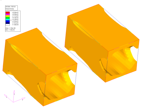

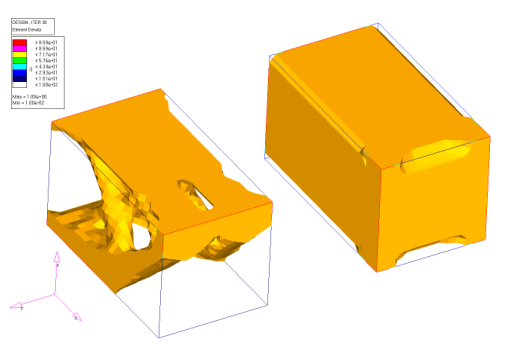

Example: Solid Block
A solid block of material is used in this example. The grids located on the rear of the block (in the YZ plane) are fully constrained. Axial loading is applied to the block's upper edge in the direction of the negative Y-axis. The objective is to minimize the compliance with a constraint on the volume fraction. Single-die draw direction constraints are applied in the direction of the positive Z-axis.
patgrp7
Figure 45. Solid Block of Material
As the loading is not symmetric with respect to the XY and YZ planes, the design is not symmetrical about these planes when symmetry constraints are not specified. Enforcing symmetry conditions about the XY or YZ planes yields significantly different results.
patgrp8
Figure 46. Results Obtained for Various Symmetry Combinations

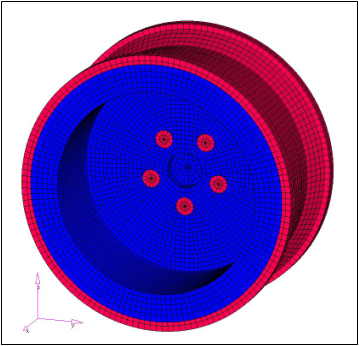

Example: Car Wheel Model
Here, solid elements are used to model a car wheel. The outer layers as well as the bolts are non-designable. Twenty load cases are considered. The objective is to minimize the weighted compliance with a constraint on the volume fraction. Split-die draw direction constraints are applied in the direction of the X-axis. Cyclical pattern grouping is defined with planar symmetry within each cycle.
patgrp9
Figure 47. Car Wheel Model
As the results show, a clean and reasonably manufacturable design is achieved. Cyclical symmetry is obtained even though the loading is not symmetric.
