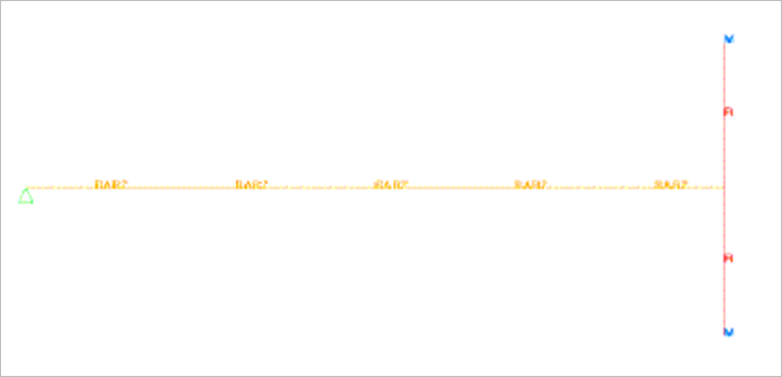

The 2-node simple beam elements are used to model the problem. The cantilever beam consists of five elements. Two rigid elements are used to connect mass 1, 10000 kg, and mass 2, 1000 kg, at the end of the cantilever beam. All degrees of freedom at end A are constrained.
