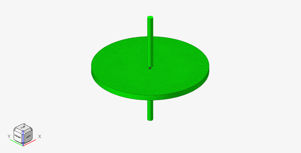

- Unbalanced rigid disc on a massless rigid shaft.
- CELAS, CTETRA4 and RBE2 elements defined.

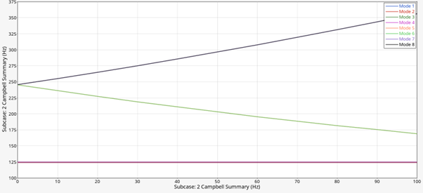

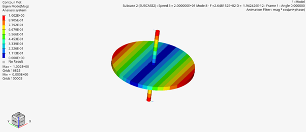

- ASYNC Complex Eigenvalue Analysis with Gyroscopic effects.
- Rotor speed increments via RSPEED from 0 to 100 Hz, in steps of 10 Hz.

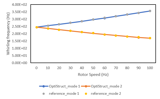

Results
The reference results are obtained by:
Where,
- Inertia moment of polar axis.
- Inertia moment of transverse axis.
- Stiffness of the transverse rotation.
- Spinning speed [rad/s].
- Whirling frequency [rad/s].
| RotorSpeed (Hz) | OptiStruct_mode 1* | OptiStruct_mode 2** | Reference_mode 11 | Reference_mode 21 |
| 0 | 246 | 245 | 245.7213 | 245.7213 |
| 10 | 255 | 236 | 255.254 | 236.5446 |
| 20 | 265 | 227 | 265.1419 | 227.7231 |
| 30 | 275 | 219 | 275.3828 | 219.2546 |
| 40 | 286 | 211 | 285.9728 | 211.1353 |
| 50 | 297 | 203 | 296.9069 | 203.3599 |
| 60 | 308 | 196 | 308.1784 | 195.9211 |
| 70 | 319 | 189 | 319.7799 | 188.8141 |
| 80 | 331 | 182 | 331.7025 | 182.0274 |
| 90 | 344 | 175 | 343.9369 | 175.5524 |
| 100 | 356 | 169 | 356.4728 | 169.3789 |
* mode 1 - Forward Whirl Mode
** mode 2 - Backward Whirl Mode
