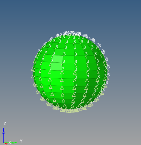

The sphere is of 1 m radius.
All the nodes of the model are constrained to six degrees of freedom (123456), along with an enforced velocity of a 1.0 m/s amplitude on SPCD via RLOAD1 in DOF 3.
The loading frequencies at which the responses are calculated are specified using the FREQ1 entry starting from 50 Hz to 160 Hz in increments of 10 Hz.

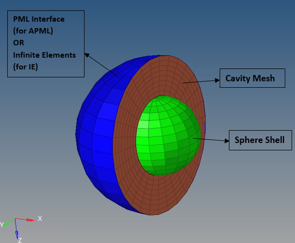

For APML, the entire vibrating structure is enclosed with an acoustic cavity mesh and further adding a layer of PML elements on this enclosed acoustic cavity mesh. A minimum of one layer of fluid elements will be defined on the surface of the structural domain of interest. Then, the APML elements, CACPML3 and CACPML4 will only be defined on the topmost surface of the fluid elements (Figure 2).
Similarly for IE, the vibrating structure is enclosed with an acoustic cavity mesh and a layer of Infinite Elements (CACINF3 and CACINF4) on the enclosed acoustic cavity mesh is added.

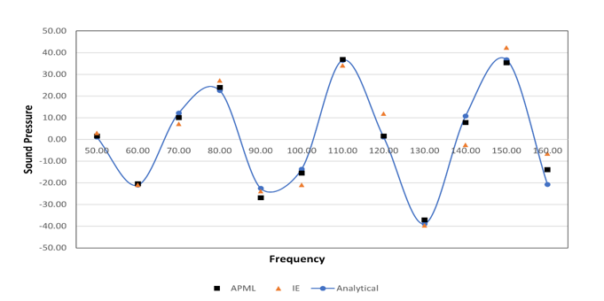

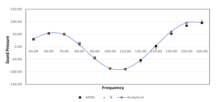

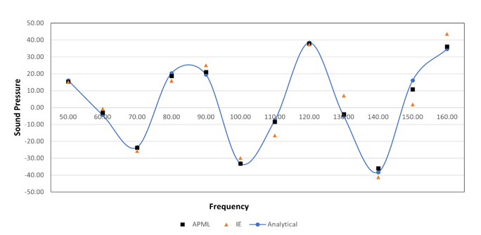

Sound Pressure versus Frequency for two microphone locations is plotted.
Adaptive Perfectly Matched Layer (APML), Infinite Elements (IE) and Analytical results are compared.
| APML | IE | |
| Z = 10 | 8.55% | 24.46% |
| Z = -4 | 7.79% | 11.15% |
- Microphone Pressure versus Frequency at z = 10 m
Figure 3. Real
Figure 4. Imaginary
Figure 5. Real
Figure 6. Imaginary
