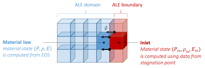

Block Format Keyword This law enables to model a liquid inlet condition by providing data from stagnation point. Liquid behavior is modeled with linear EOS. Input card is similar to /MAT/LAW11 (BOUND), but introduces two new lines to define turbulence parameters.

Comments
  1. Provided gas state from stagnation point ( ρ stagnation , P stagnation ) is used to compute inlet gas state. Bernoulli is then applied.
    P stagnation = P in + ρ in ν in 2 2
    This leads to inlet state:
    ρ in = C 1 ⋅ ρ stagnation C 1 + ρ stagnation ν in 2 2 ( 1 + C d )
    P in = P stagnation − ρ stagnation ν in 2 2 ( 1 + C d )
    ( ρ e ) in = ( 1 − ρ in ρ stagnation ) P in + E stagnation
