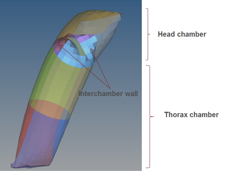

Internal surfaces (internal walls, baffles, and so on) shall be defined as a collection of components and referenced in the surf_IDin field.
