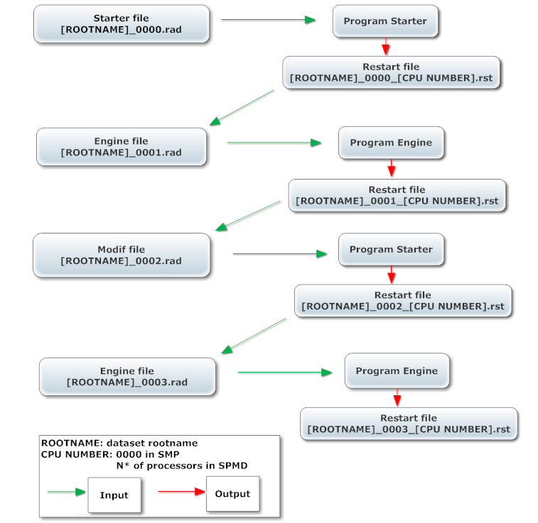

Modif files have the name: Runname_run#.rad
where, run# is the Radioss run number four digits from 0000 to 9999 and run# is the name of the last Restart file + 1.
For example, to run a Modif file after the first run, restart file Runname_0001_cpu.rst
where, cpu # is the number of processors (four digits), and cpu # = 0000 = SMP Radioss version.
The run number for the Modif file must be Runname_0002.rad.
