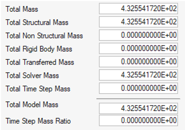

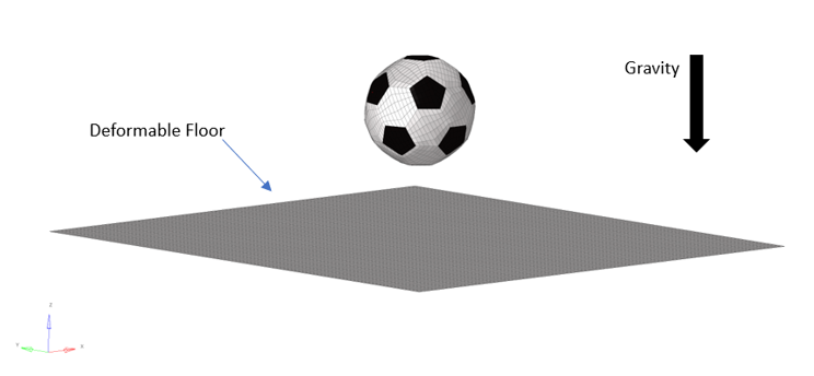

Shell elements (/SHELL and /SH3N) were used to model the ball and a fabric elastic orthotropic material law (/MAT/FABRI) was applied. In addition, a controlled volume (/MONVOL/AIRBAG1) is created to keep the pressure inside the ball constant during the simulation. The initial ball mass is 432.55g, the target ball mass is 435g using /ADMAS.
The only load applied to the ball is gravity with /GRAV.
The ball is dropped with an initial velocity of zero.

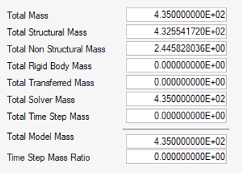

The total mass will be estimated by HyperMesh and compared to the mass calculated by Radioss solver (in the Starter listing and in the time history).
Results

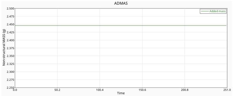

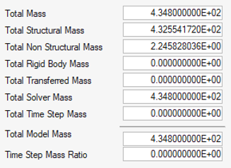

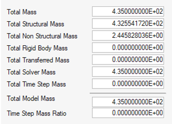

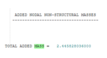

- /ADMAS/0:The mass is added to each node contained in the specified node set. Each node receives 1.68e-3 g of additional mass, and the total added mass is 1.68e-3g x 1453 Nodes, or 2.445g. As expected, the total mass estimated by HyperMesh and the mass calculated by the Radioss solver (in the Starter listing and in the time history) are equal to 435g, as shown here.
Table 1. Mass calculated by HyperMesh, Radioss and HyperGraph using input Type 0 HyperMesh Radioss Starter Listing Radioss Time History
