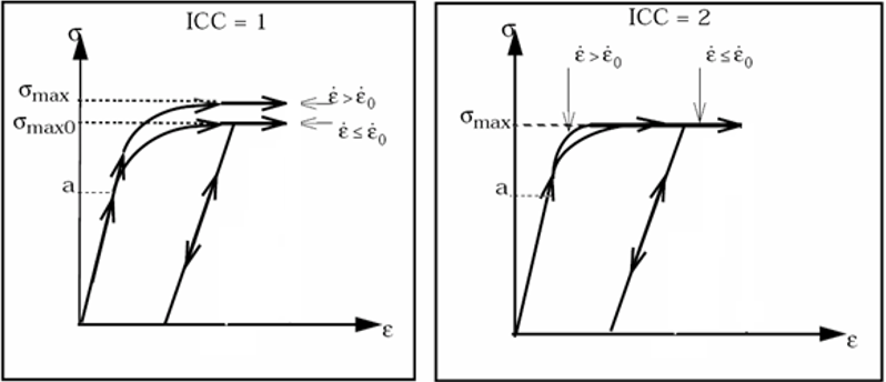

- The ICC flag defines the effect of strain
rate on the maximum material stress
. Figure 1 shows the value of for
the corresponding ICC flag.
