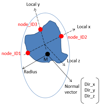

- The elements groups defined will
be intersected by the defined disc. The section nodes are created from the nodes
of those intersected elements, which are on the upside (z > 0) of the plane of
the disc.
- The forces and moments from the sections will be stored in the time history file and requested using /TH/SECTIO.
- The local force and moment output
system of the section is defined using 3 nodes. These three nodes should be
nodes on the section plane, so their position is updated when the section moves.
When using the Cross-Section Assistant in HyperMesh
to create the section, the 3 nodes are automatically selected.Local system is defined as:
- Nodes node_ID1 and node_ID2 define the local x-axis of the section.
- Nodes node_ID1, node_ID2, and node_ID3 define the local plane xy of the section.
- The local y-axis is defined by projecting node_ID3 perpendicular to the local x-axis.
- The intersection of the local x- and y-axis is then the origin of the system.
- Last, the section normal is the local z-axis which is perpendicular to the xy plane.
