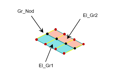

- The
/SLIPRING/SHELL is defined by the 2 groups of shell
elements initially connected to the slipring, El_Gr1,
El_Gr2 and a group of nodes Gr_Nod
used to define the position of the slipring. The common node between the
elements of El_Gr1 and El_Gr2 must be
at the same position as Gr_Nod.
- The slipring must be represented by a line; therefore, the nodes of Gr_Nod must be aligned and can not be nodes of the seatbelt shell elements. All the nodes of Gr_Nod must belong to a single rigid body or boundary condition (all DOF fixed).
