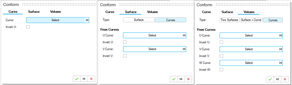

Conformal coordinate spaces can be 1-, 2- or 3-dimensional and are defined by a set of features defining the U, V and W directions of the parametrization. There are a number of options for defining the 2- and 3-dimensional parametrizations; these can be seen on the Conform guide panel.
- 1D conformal coordinate spaces can only be created based off a single curve. The
Invert U parameter allows for the 0-1 parametrization
for the curve to be inverted.
- 2D conformal coordinate spaces can be created either from a single surface or
two curves to create a virtual surface. For both types, the U and V parameters
can be inverted, and for the single-surface mode, the U and V parameters can be
swapped so the U definition of the surface becomes the V and vice versa.

- 3D conformal coordinate spaces can be created from two surfaces, which creates a
lofted conformal volume between them, a surface and a curve, which creates a
swept conformal volume or a virtual volume defined with three separate
curves.
