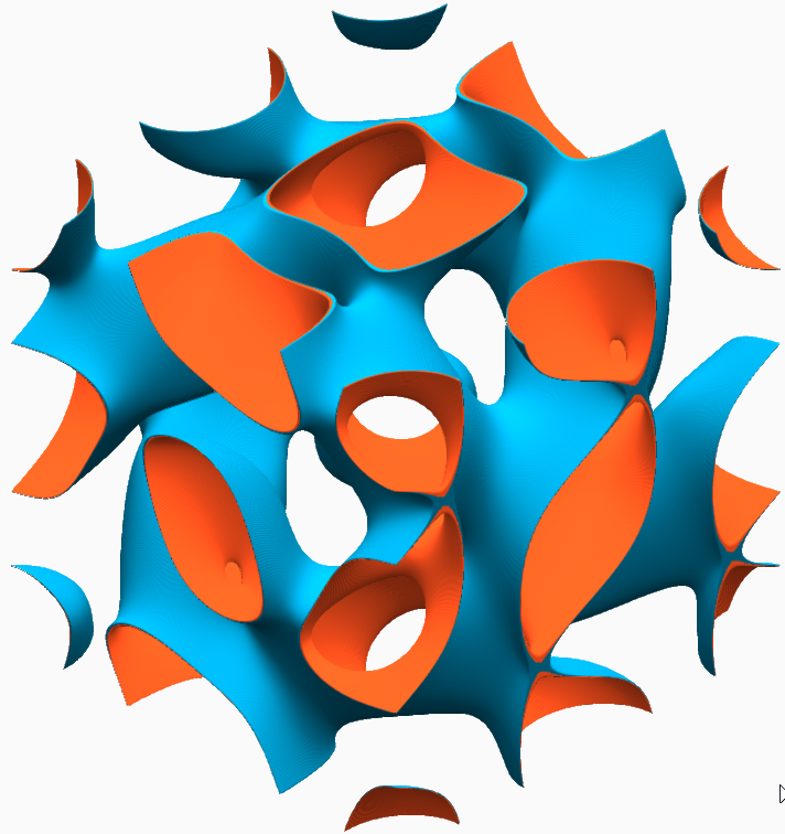

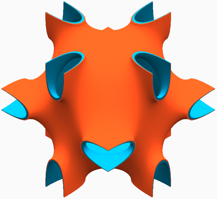

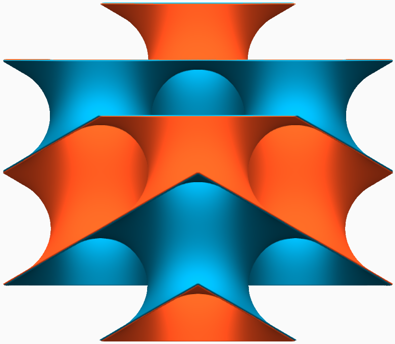

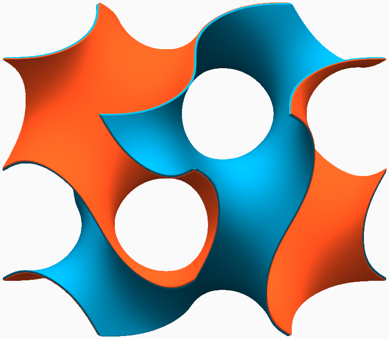

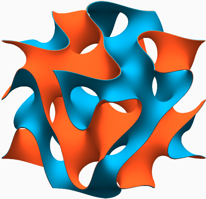

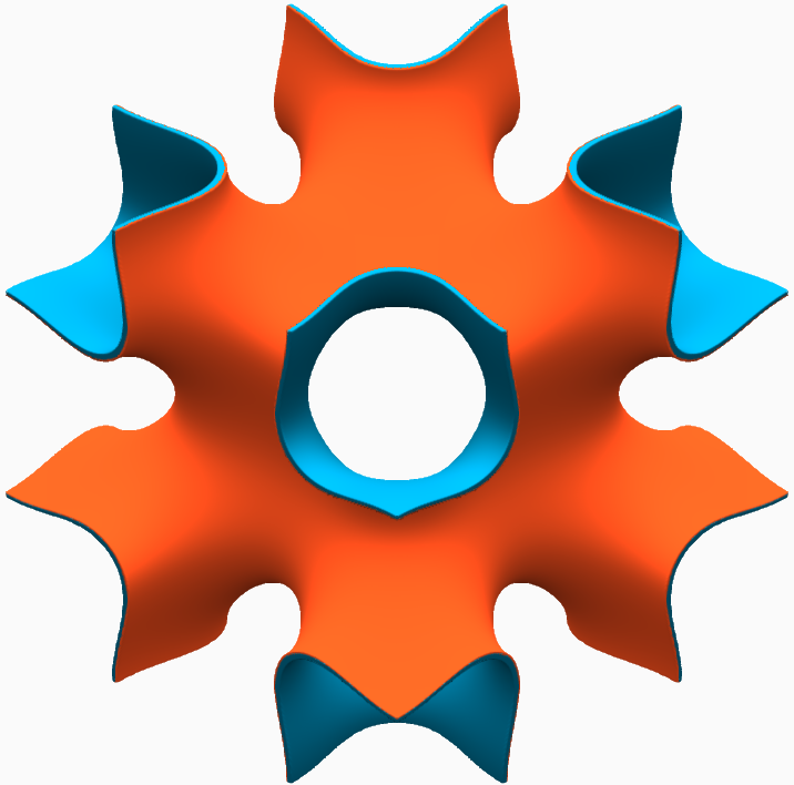

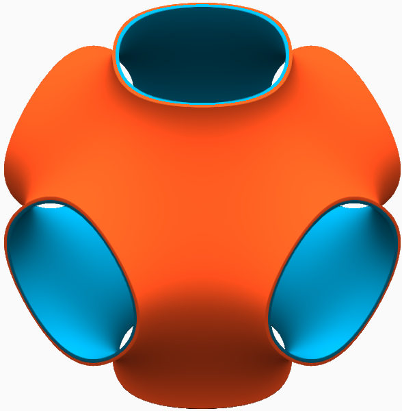

Option Description Surface - Unit Cell Select a unit cell type. In the following images, the surface that creates the lattice has been shown with blue coloring on one side of the surface and orange coloring on the other. These infinitely thin surfaces are transformed into solid volumes using the Surface Type options (Single and Double), which are described in the next section. - Gyroid

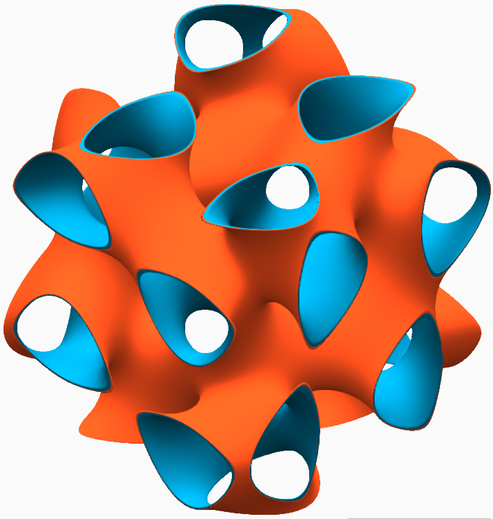

- Schwarz P

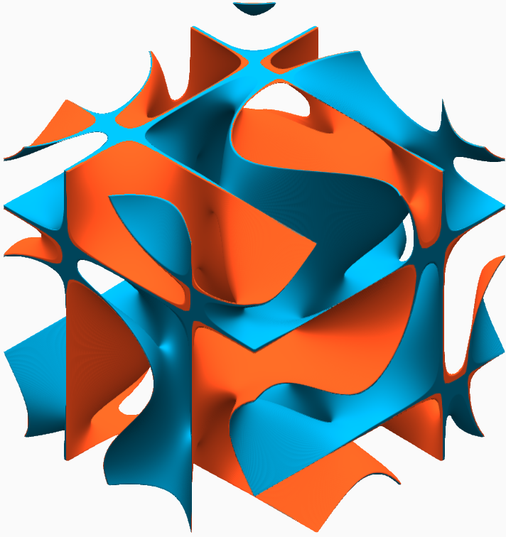

- Schwarz D

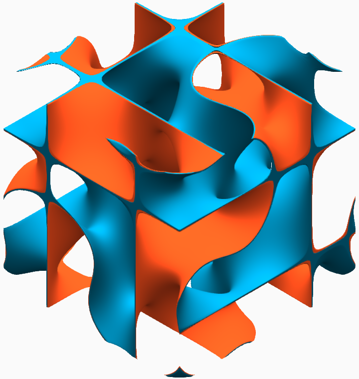

- Neovius

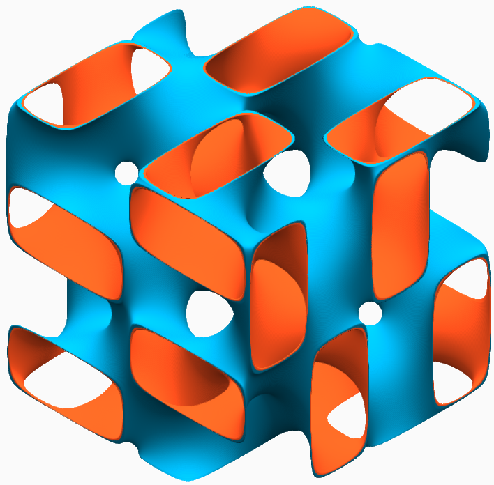

- Lidinoid

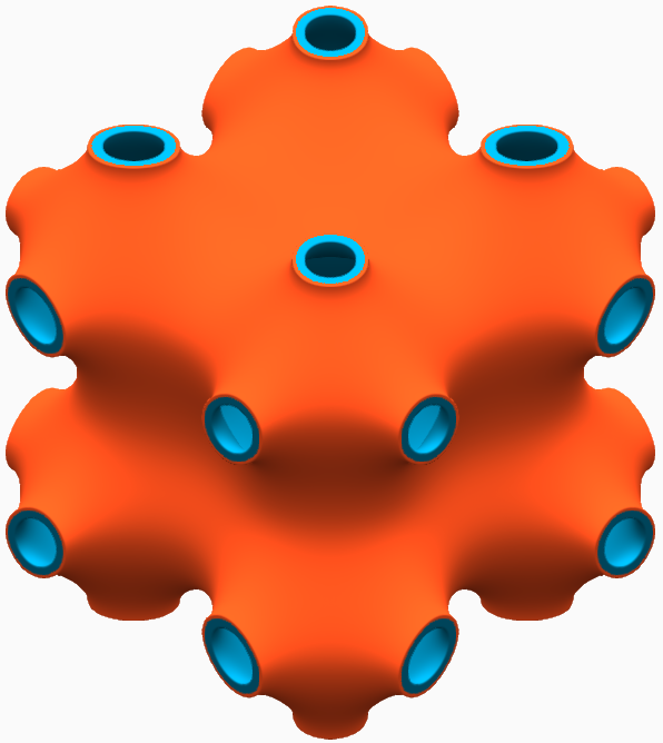

- Fischer Koch S
- Fischer Koch Cs
- Fischer Koch Y
- Fischer Koch Cy
- FRD
- IWP
- Split P
- Karcher K
- G Prime

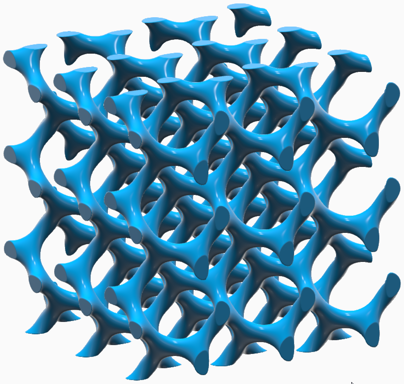

Surface - Type Select between a single or double surface lattice. - Single: Create a single, fully connected volume where one side of the surface is defined as being solid material.
- Double: Create a lattice with
two sides. In this case, two offset surfaces of the
same type are created, and the volume between the
surfaces is defined as being solid material. These
surfaces create two separate but interwoven pore
networks that are separated by the lattice volume.
This is useful for functions like heat transfer,
where you want the lattice to serve as a barrier
between two types of fluids.

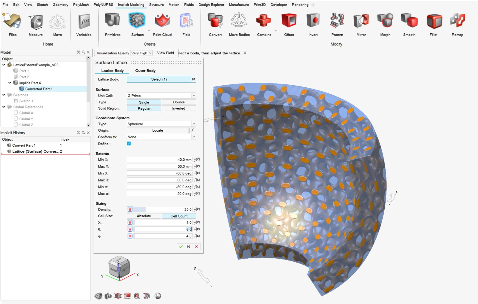

Coordinate System - Origin Locate: Use the Move tool to position and orient the local coordinate system of the lattice. Coordinate System - Conform to Conform to:use this option to generalize a Cartesian lattice by creating conformal (curved) spaces that operate on the parametrized coordinates, U, V and W. You can select an existing Conformal Coordinate Space from the dropdown menu or create a new one. For more information, see Create a Conformal Coordinate Space. Coodinate System - Define Extents Define: Using the input fields for on-screen handles, define the minimum and maximum extents of each of the coordinate directions (Cartesian: x, y, z; Cylindrical: x, θ, z; Spherical: x, θ, φ). You can then specify the number of unit cells that will span these extents by sizing them according to 'Count', or you can specify an 'Absolute' unit cell size in length units.
When using 'Count' for unit cell sizing, you are guaranteed to have precisely the specified number of unit cells spanning the extents. If the count is an integer, the unit cells will begin and end perfectly on the boundaries of the extents (see the images below for an example in a spherical coordinate system)
In case of absolute sizing, unit cells are guaranteed to begin on the minimum extent of each coordinate direction but they are not guaranteed to terminate nicely on the upper extent of each direction.
Sizing - Density - Drag the slider or enter a value to define the relative density of the lattice as a percentage.
- Assign a variable.
- Apply a field.
Sizing - Cell Size Choose between defining the lattice size by an absolute dimension or the number of cells. - Absolute: Enter an absolute length value, or an absolute angle value, for non-Cartesian coordinate systems, along each axis.
- Cell Count: Enter the number of cells along each axis.

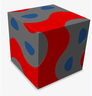

Bias When working with the Double surface lattice type, drag the slider or enter a value to vary the volumes on either side of the lattice, without changing the volume of the lattice itself. When you change the surface type to Double, there is a volume on one side of the lattice surface and a separate volume on the other side. The bias allows you to make one of those volumes smaller and the other larger without changing the amount of volume that the lattice itself takes up.
In this image, the lattice volume is gray, the volume on one side is blue, and the volume on the other side is red.Note that blue is appreciably smaller than red, hence "bias."
This mostly applies to situations where you have two fluids that are separated by a wall (lattice). Two-fluid heat exchangers are a good example of where this is helpful.
