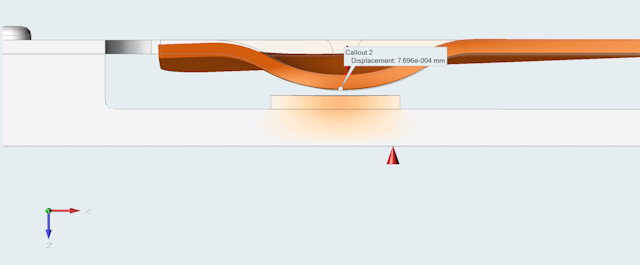

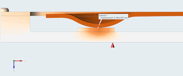

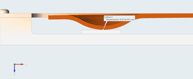

Contact Clearance
Contact clearance is an advanced feature used to either force or prevent contact in cases where there is a slight separation between contacting parts. It is only considered when running an analysis or optimization with Sliding or Separating contact types defined.
By default, the contact clearance is set to 0.0, meaning that the parts are always in
contact regardless of the minimum separation. You can change the default value by
clicking the
icon
on the Contacts guide bar.
To edit the contact clearance for an individual contact:
Click the List Contacts
satellite icon on the Contacts tool.
Right-click a column header on the Contacts Table and select Clearance to add
it to the table.
- Enter a Clearance for the desired contact in the table. To enforce a contact from the beginning of the solution, set the contact clearance to 0.0. If you want the parts to operate independently and only contact if they physically touch during the load case, remove 0.0 and set the value to (none). To enforce an interference fit, enter a positive clearance. To add clearance between touching parts, enter a negative value into the contact clearance field.
