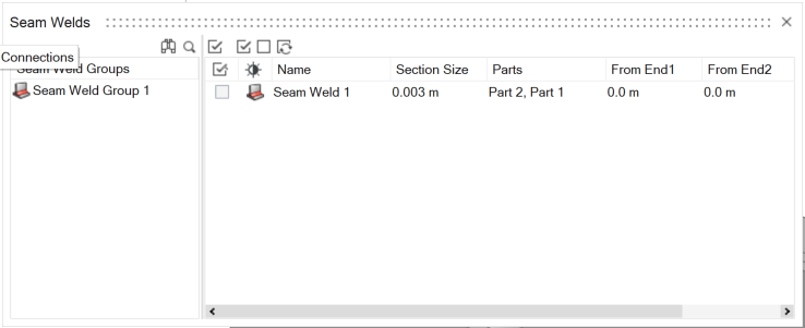

Seam Welds Table
Review all seam welds and edit their names in one place.
Click the
satellite icon on the Seam Welds tool to review welds in a table.
Note: Some properties cannot be edited due to construction
history dependence.
| To | Do this |
| Rename a seam weld | Select the cell in the table and then click again to make the field editable. |
| Change the material | Select the cell in the table and then select a different option from the list. |
| Sort a column | Click the column header. Click repeatedly to toggle between ascending and descending order. |
| Add or remove columns | Right-click on a column header. |
