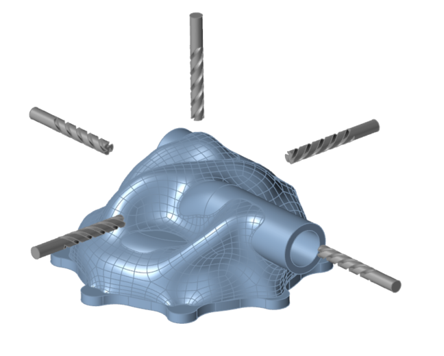

“5-axis” refers to the number of directions in which the cutting tool can move. On a
5-axis machining center, the cutting tool not only moves along the x, y, and z linear
axes, but also rotates about the x- and z-axes. This allows the tool to approach the
workpiece from any direction, allowing complex shapes to be machined. The geometry that
can be machined is constrained by the tool dimensions and subsequent machining access.
The access angle or tool dimensions must also be defined.

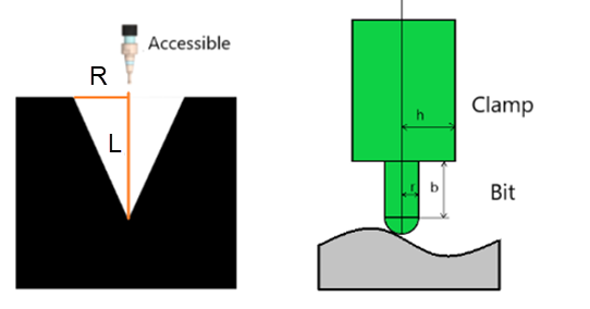

You can define the tooling dimensions by selecting either Access
Angle Parameters or Drill Bill Diameters
from the rightmost dropdown in the microdialog:
- Access Angle Parameters: Define the access angle
by defining the Access Radius and the
Access Depth, where the angle is r/d.
- Drill Bill Diameters: Define the dimensions of
the milling bit and head by entering the Tool
Radius, Tool Length, and
Clamp Radius.
