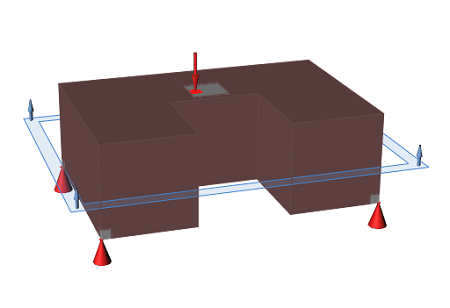

Click on a design space to apply a single draw direction.
A microdialog appears, along with a set of three orthogonal planes. The active plane is shown in blue.
- Select a plane to orient the draw direction.

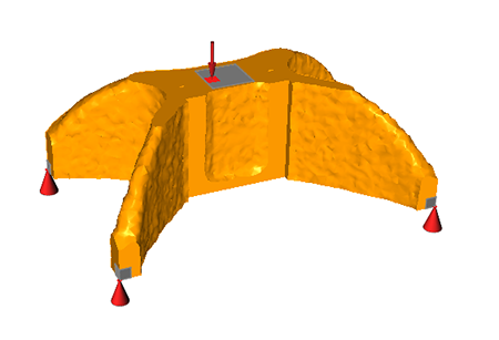

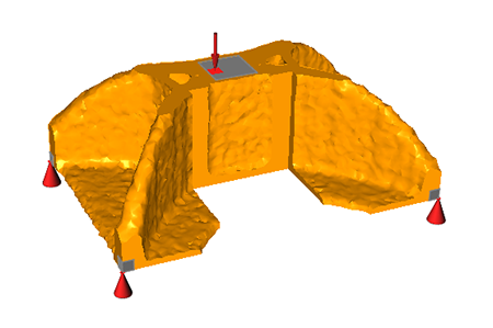

Single Draw Examples
