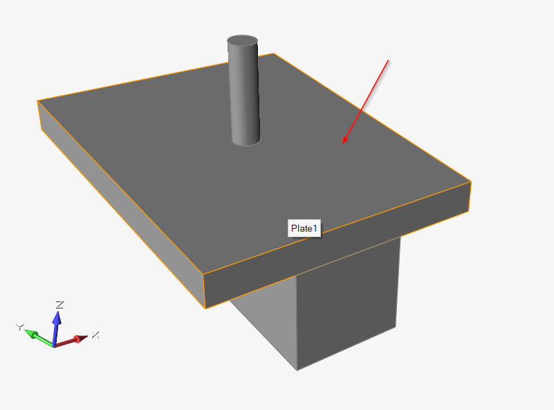

Identify the Plates
Click the Plates icon.
Select both top and bottom plates in the model,
and select the material AA6063 in the microdialog.

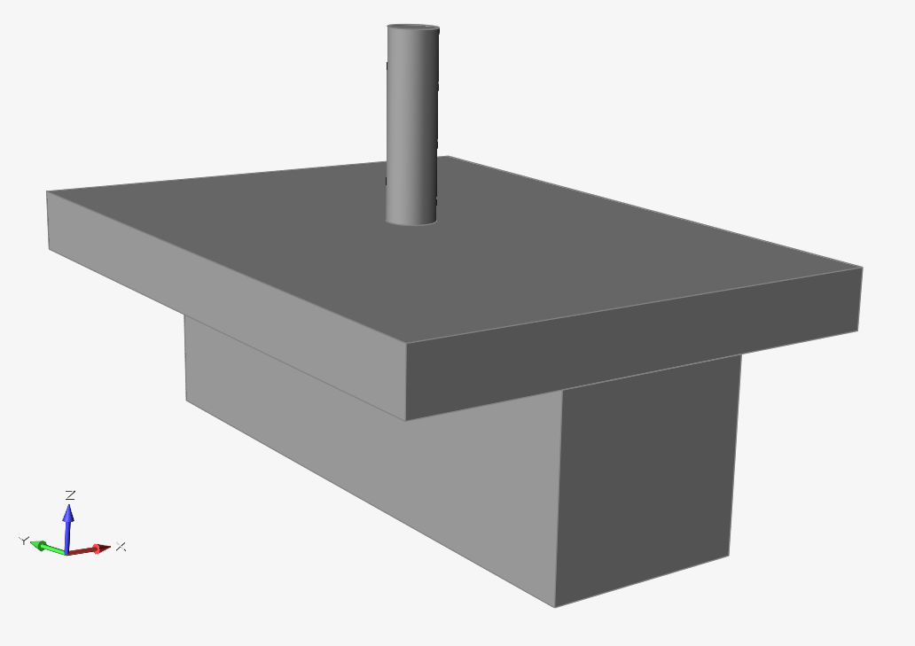

Orient the Model
Click the Orient icon.
Select the top surface that will be pierced by the pin.

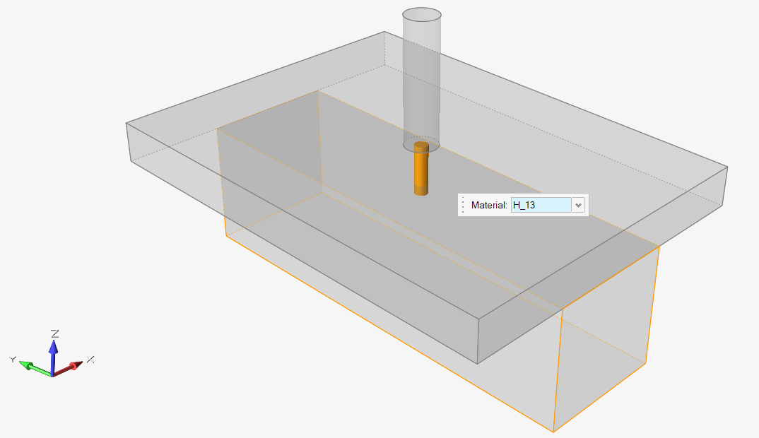

Identify the Pin
Click the
satellite icon on the Pin tool.
Select H_13 in the microdialog for the automatically
identified pin.

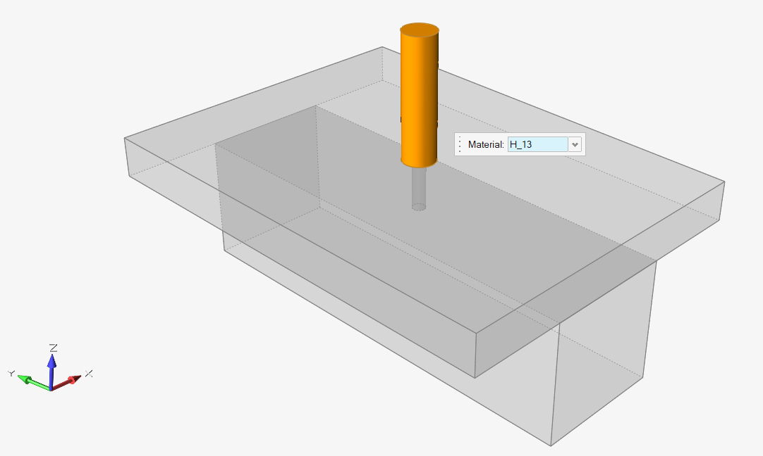

Identify the Shoulder
Click the satellite icon on the Shoulder tool.
identified shoulder.

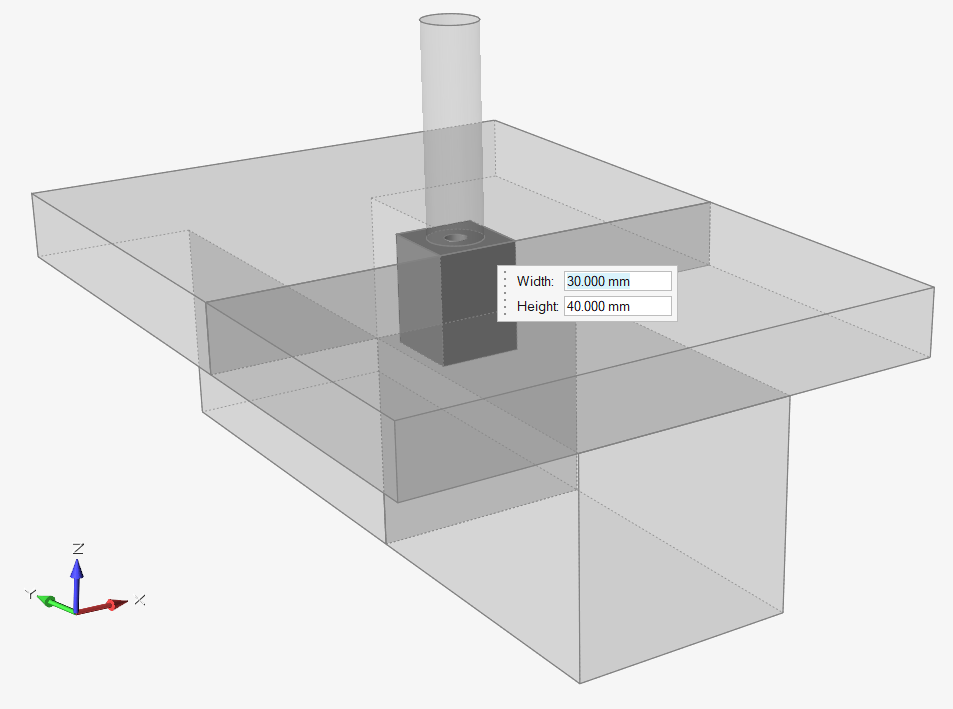

Create HAZ
Click the HAZ icon.
Enter the HAZ dimensions in the microdialog.

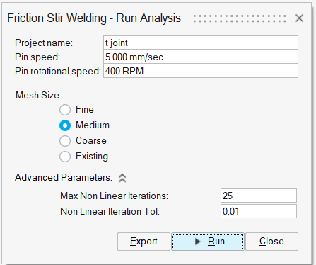

Specify Process Parameters and Simulate
- Save the model.
Click the Submit Job icon.
Enter the analysis parameters.
Note: To see Advanced Parameters options, you must have enabled it in Preferences. - Click Run.

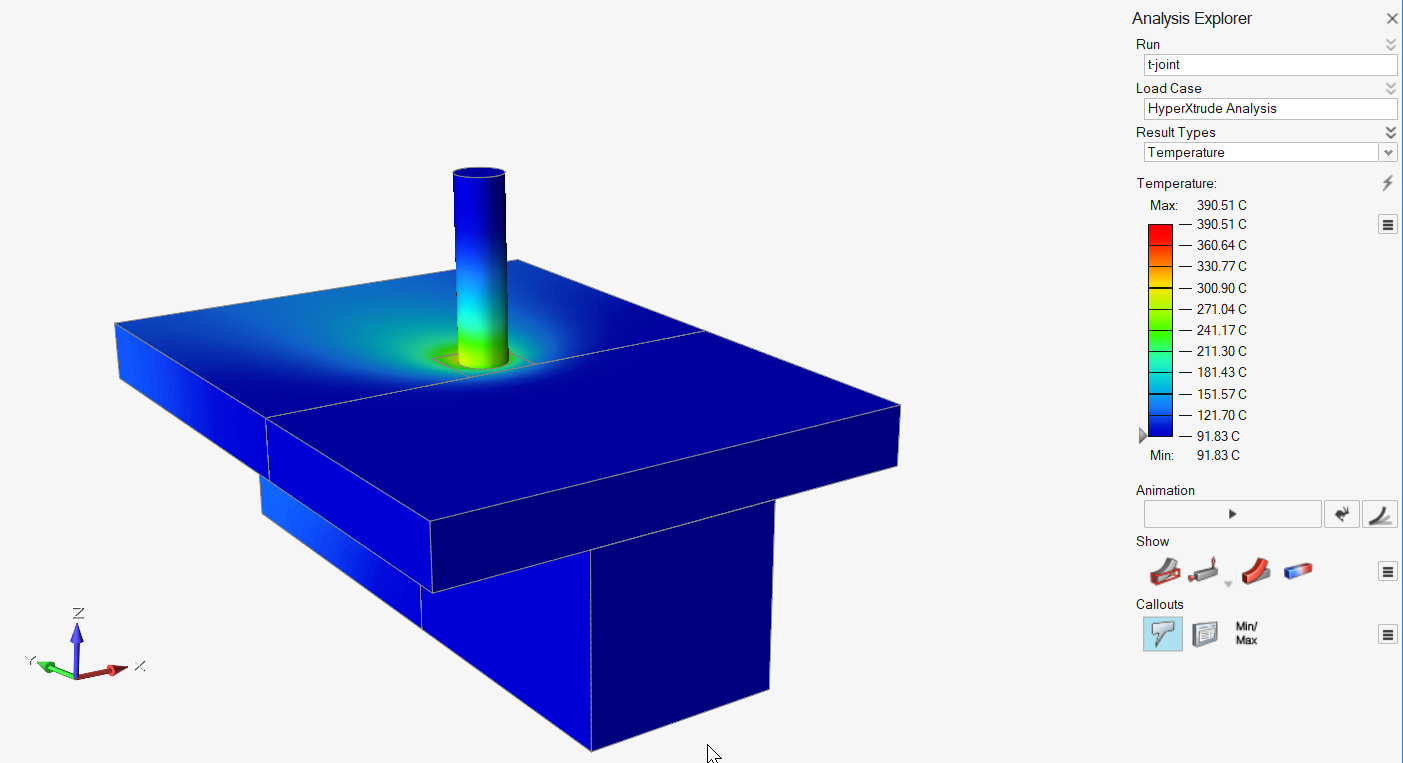

View Simulation Results
When the analysis is complete, double-click the name of the run to open the
results in the Analysis Explorer.
Note: You can also open the t-joint.ifsw file to view those same results.
Select the Temperature result type.
Click the Play button in the
Animation ribbon.
