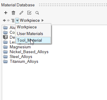

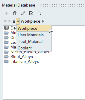

In the Material Database dialog, to the right of
, click the triangle and select Workpiece.

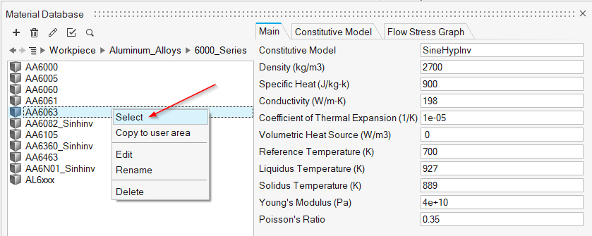

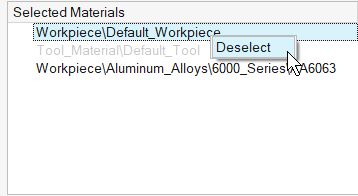

3. Select the workpiece material AA6063. Right-click on
the material and select Select.
Right-click on the Default_Workpiece material in the
selected materials and click Deselect.
To the right of

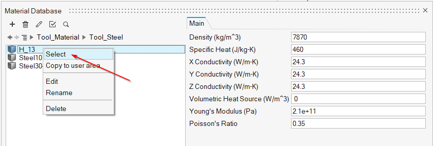

, click the triangle and select Tool_Material.
Select the tool material H_13. Right-click on the
- Click OK to save and close the window.

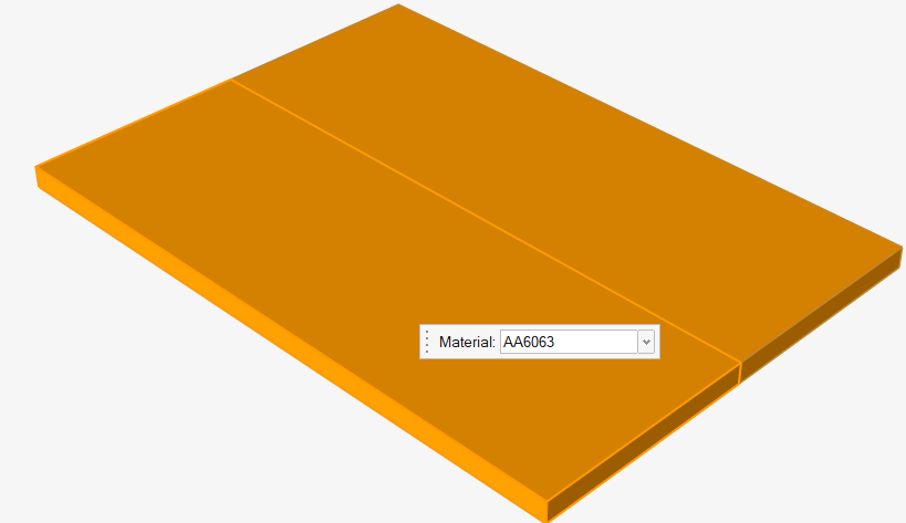

Click the Plates icon.
Select both left and right plates in the model,
and select the material AA6063 in the microdialog.

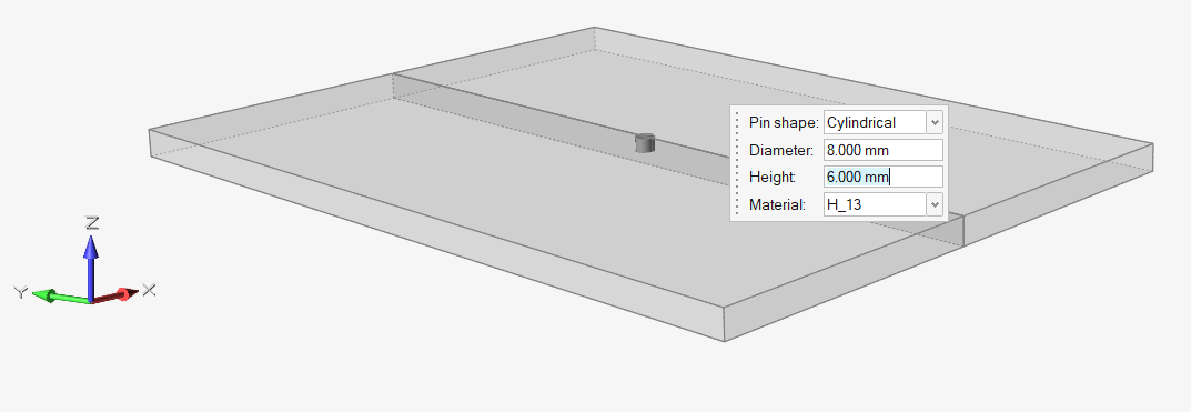

Create the Pin
Click the Pin icon.
Modify the pin geometry and specify the pin material with the
microdialog.

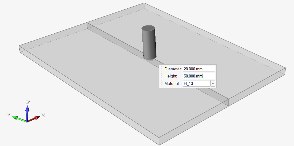

Create the Shoulder
Click the Shoulder icon.
Modify the shoulder geometry and specify the pin material with the
microdialog.

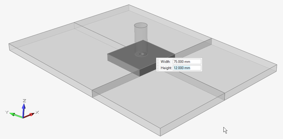

Create HAZ
Click the HAZ icon.
Enter the HAZ dimensions in the microdialog.

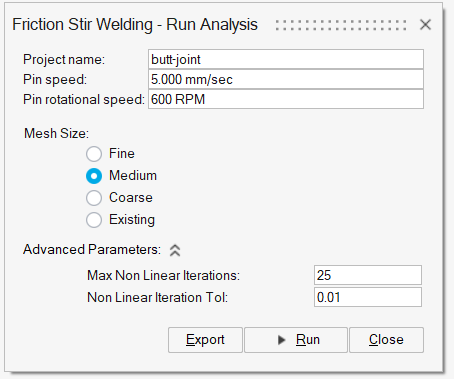

Click the Submit Job icon.
Enter the analysis parameters.
Note: To see Advanced Parameters options, you must have enabled it in Preferences. - Click Run.

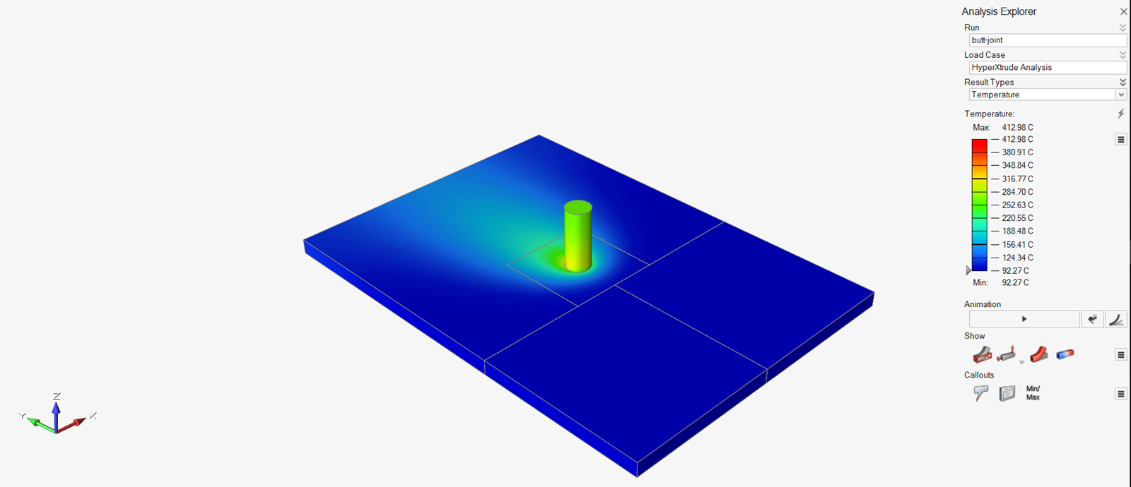

View Simulation Results
When the analysis is complete, double-click the name of the run to open the
results in the Analysis Explorer.
Note: You can also open the butt-joint.ifsw file to view those same results.
Select the Temperature result type.
Click the Play button in the
Animation ribbon.
