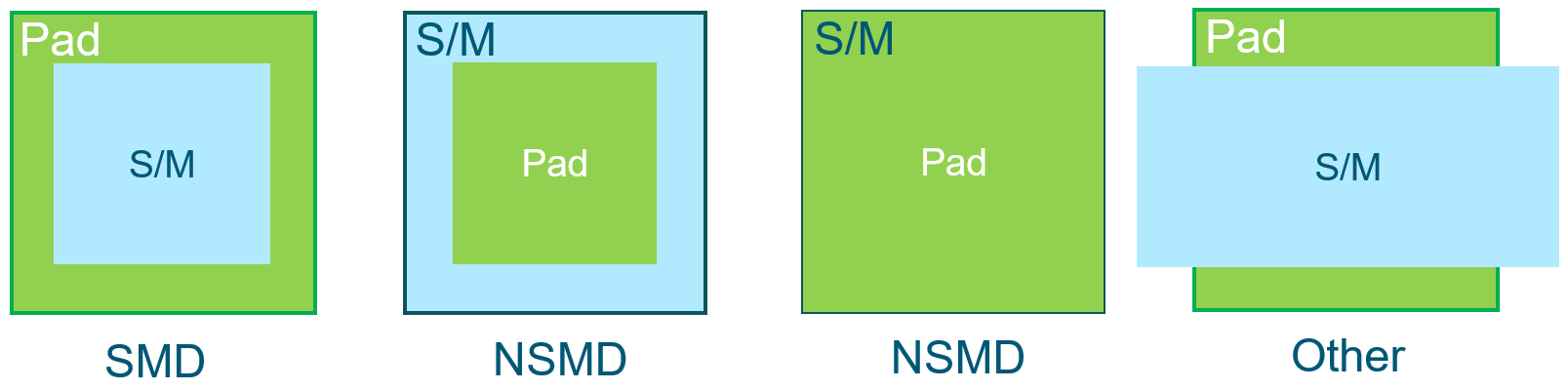

- If the Solder Mask is entirely within the Pad area, it is considered an SMD Pad.
- NSMD: Set the clearance value between solder
mask and NSMD pad.
- If the Pad is entirely within the Solder Mask area (including cases where they are the same size), it is considered an NSMD Pad.

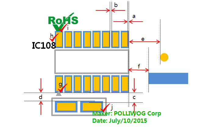

- Clearance between Solder Masks in Same Component: Set the clearance value between solder mask and solder mask.
- Clearance between Pad and Other Component’s Solder Mask: Set the clearance value between pad and other components’ solder masks.
- Clearance between Solder Mask and Other Component’s Solder Mask: Set the clearance value between solder mask and other component solder masks.
- Clearance between Solder Mask and Board Figure Pads: Set the clearance value for solder mask and board figure type pads.
- Clearance between Solder Mask and Board Figure Solder Masks: Clearance checking between the Solder Masks of Pad and Board Figure.
- Clearance between Solder Mask and other Net: Clearance
checking between the Solder Masks of Pad and Net.
- Recognize as different nets if other nets are connected to the same reference.
- Check exposed copper on the same net due to solder mask.
- Solder Mask Overlapping with Component Figure Silkscreen: Option to check the area where the Solder Mask and Component Figure silkscreen overlap. Overlapped area is considered as fail.
- Solder Mask Overlapping with Component Text Silkscreen: Option to check the area where the Solder Mask and Component Text silkscreen overlap. Overlapped area is considered as fail.
- Solder Mask Overlapping with Board Figure Silkscreen: Option to check the area where the Solder Mask and Board Figure silkscreen overlap. Overlapped area is considered as fail.
- Solder Mask Overlapping with Board Figure Text Silkscreen: Option to check the area where the Solder Mask and Board Figure Text silkscreen overlap. Overlapped area is considered as fail.
- Check Existence of Solder Mask in Target Component’s Pin: Check whether target component’s pin has solder mask or not.
- Check the existence of Solder Mask between Thermal Pad and I/O Pad: Check whether Solder Mask exists between Thermal Pad and I/O Pad.

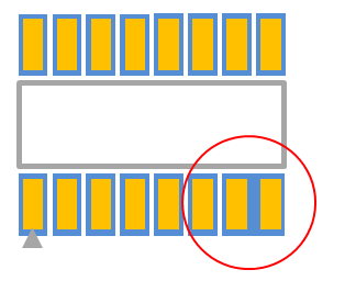

- Check Solder Mask usage in multiple Pins: Check multiple
shares same solder mask.
