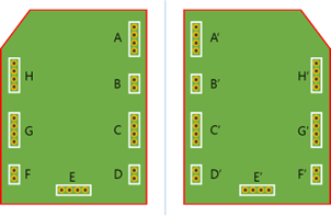

Verifies the position of the component and that the net connected to the pin is designed symmetrically, because this design combines two PCBs with the symmetrically placed components in each design.
Products have a symmetrical structure that combines two PCBs.
