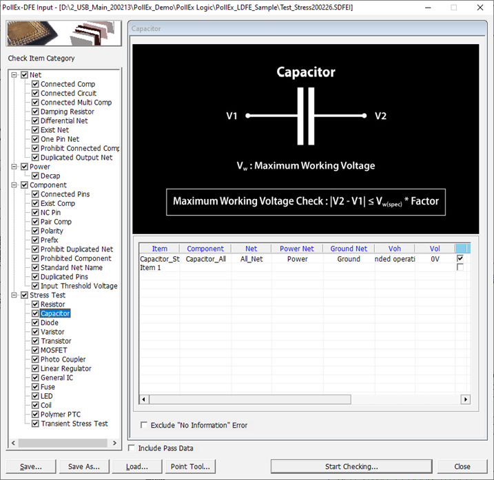

Capacitor
This item tracks the voltage and signal lines in the circuit, calculates the voltage value of each net, and checks whether the all capacitor connected to the net is within the allowable voltage range.
- Component: Select capacitor component group to be checked.
- Net: Select net group to which capacitor components are connected.
- Power Net: Select power net group to which capacitor components are connected.
- Ground Net: Select ground net group to which capacitor components are connected.
- Voh: Set the output high voltage (Voh) of driver pin. You can set this by entering the value directly or select the property name which contain voh value.
- Vol: Set the output low voltage (Vol) of driver pin. You can set this by entering the value directly or select the property name which contain vol value.
- Working Voltage
Check: Set the allowable working voltage of this component. You can set this
by entering the allowable value directly or select the property name which
contain allowable working voltage value. You can also assign tolerance of
this check.
