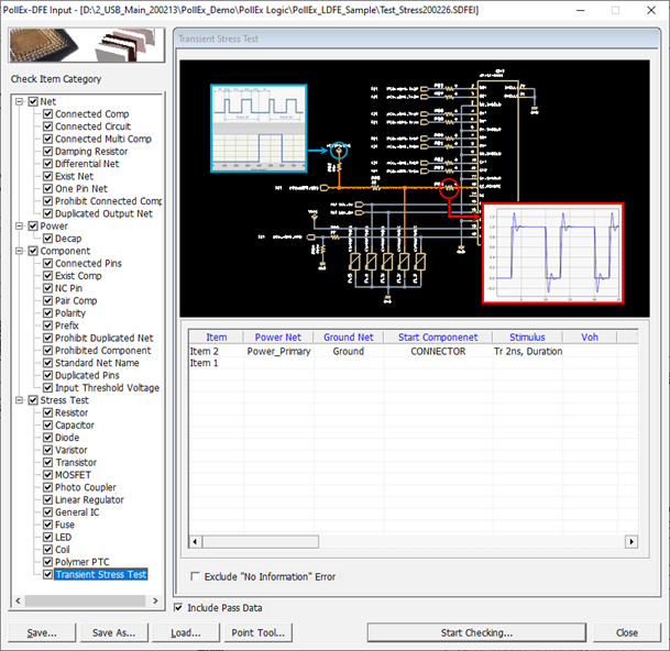

Transient Stress Test
The transient stress test item uses the SPICE Engine, it makes a SPICE net list, finds the node voltage, and checks whether all passive components connected to the net are within the allowable voltage range.
- Power Net: Select power net group to which passive components are connected.
- Ground Net: Select ground net group to which passive components are connected.
- Start Component: Select start component of power net. Normally Power Device or Connector can be a start component of power net.

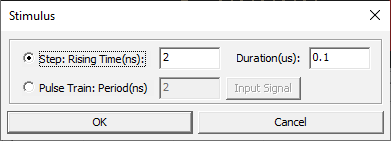

- Stimulus: Set
input stimulus of SPICE net list. You can assign Step Pulse or Pulse
Train.
Figure 2. - Voh: Set the output high voltage (Voh) of driver pin. You can set this by entering the value directly or select the property name which contain voh value.
- Vol: Set the output low voltage (Vol) of driver pin. You can set this by entering the value directly or select the property name which contain vol value.

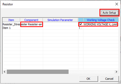

Set Resistor
Set resistor component parameters for the Transient Stress Test item.
Double-click the empty field in the Resistor column to open the
Resistor dialog.
Figure 3. -
If this stress test-item was previously
set, click Auto Setup to import all properties except for
Simulation Parameter and Simulation Model.
Simulation Parameter column, and then select from the following:
- To enter the value of resistance, select Value (ohm).
- To select the property that contains the value of resistance, select Property Name.
Figure 4. - Optional: To register a SPICE model, double-click the empty field, and then use the File Explorer to select the .model file.
- Click OK to exit the dialog.

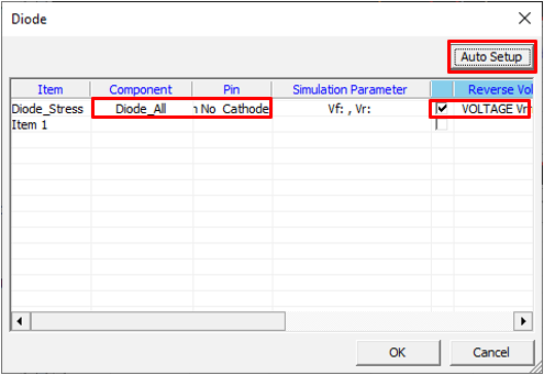

Set Diode
Set diode component parameters for the Transient Stress Test item.
Double-click the empty field in the Diode column to open the
Diode dialog.
Figure 7. -
Simulation Parameter column, and then do the following:

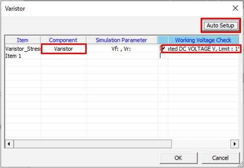

Set Varistor
Set varistor component parameters for the Transient Stress Test item.
Double-click the empty field in the Varistor column to open the
Varistor dialog.
Figure 9. -

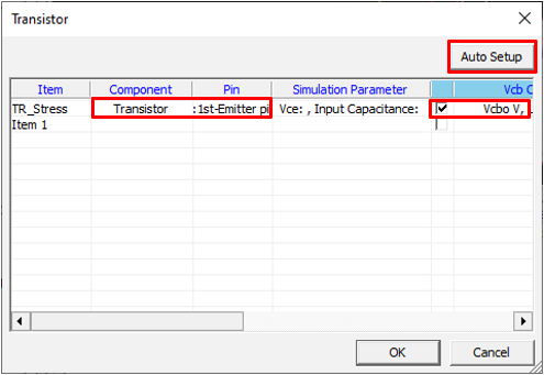

Set Transistor
Set transistor component parameters for the Transient Stress Test item.
Double-click the empty field in the Transistor column to open the
Transistor dialog.
Figure 11. -

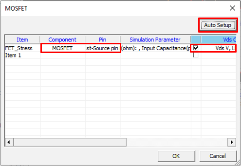

Set MOFSET
Set MOFSET component parameters for the Transient Stress Test item.
Double-click the empty field in the MOFSET column to open the
MOFSET dialog.
Figure 13. -

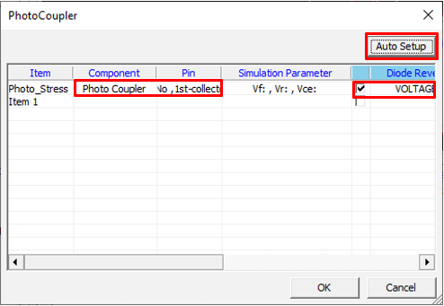

Set Photo Coupler
Set Photo Coupler component parameters for the Transient Stress Test item.
Double-click the empty field in the Photo Coupler column to open the
Photo Coupler dialog.
Figure 15. -

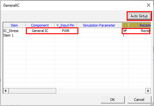

Set General IC
Set General IC component parameters for the Transient Stress Test item.
Double-click the empty field in the General IC column to open the
General IC dialog.
Figure 19. -
- To enter the value of input capacitance, select Value (pF).
- To select the property that contains the value of input capacitance,
Figure 20.

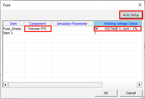

Set Fuse
Set fuse component parameters for the Transient Stress Test item.
Double-click the empty field in the Fuse column to open the
Fuse dialog.
Figure 21. -
- To enter the value of resistance (RON), select Value (ohm).
- To select the property that contains the value of resistance (RON), select Property Name.
Figure 22. - Optional: To register a SPICE model, double-click the empty field, and then use the File Explorer to select the .model file.

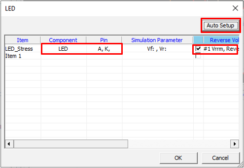

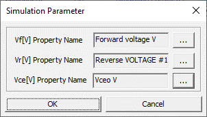

Set LED
Set LED component parameters for the Transient Stress Test item.
Double-click the empty field in the LED column to open the
LED dialog.
Figure 23. -
- Select the property that contains the forward voltage.
- Select the property that contains the reverse voltage.
Figure 24. - Optional: To register a SPICE model, double-click the empty field, and then use the File Explorer to select the .model file.

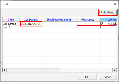

Set Coil
Set coil component parameters for the Transient Stress Test item.
Double-click the empty field in the Coil column to open the
Coil dialog.
Figure 25. -
- To enter the value of inductance, select Value (uH).
- To select the property that contains the value of inductance, select Property Name.
Figure 26. - Optional: To register a SPICE model, double-click the empty field, and then use the File Explorer to select the .model file.

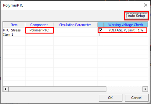

Set Polymer PTC
Set Polymer PTC component parameters for the Transient Stress Test item.
Double-click the empty field in the Polymer PTC column to open the
Polymer PTC dialog.
Figure 27. -
- To enter the value of resistance (ESR), select Value (ohm).
- To select the property that contains the value of resistance (ESR), select Property Name.
Figure 28. - Optional: To register a SPICE model, double-click the empty field, and then use the File Explorer to select the .model file.
