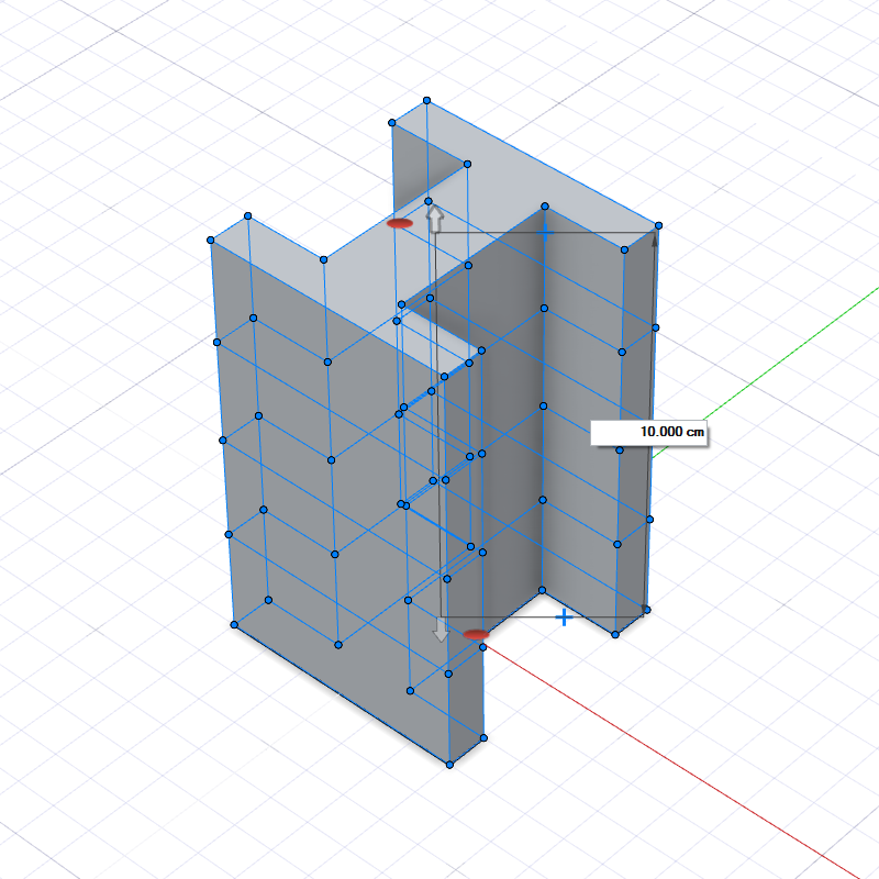

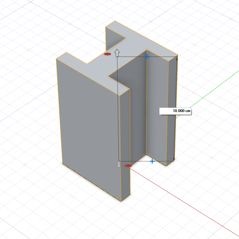

Manipulate the Shape of an Extrusion
Select a degree option and then reposition or change the number of the control points in order to manipulate the shape of an extrusion.
In the guide bar, Exact is selected by default. It is used to achieve precise dimensions when you don't plan to manipulate the shape.
If you want to manipulate the shape, select one of the degree options.
  1. In the guide bar, select NURBS Degree 2, 3 or 5.
    Note: Select a higher degree for a smoother curvature.
  2. Modify the control points.
    To Do this
    Change the number of points In the guide bar, enter the number of Points.
    Reposition a point
    • Drag a point.
    • Click a point, and then enter the x, y, and z coordinates.
    Modify multiple points
    • Click a blue line, and then drag one of the selected points.
    • Box select the points, and then drag one of the selected points.
    Undo changes for selected points Click the points you want to revert, and then in the guide bar, select Un-edit selected.
  3. Right-click and mouse through the check mark to exit, or double-right-click.
Figure 1. Exact
Figure 2. Degree 3
