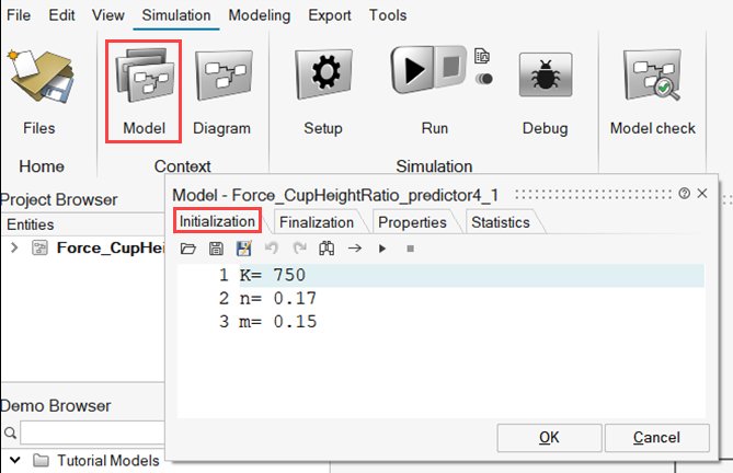

Define the design variables in Twin Activate.
In Twin Activate, you must define variables that you want to use as design variables only in the script section of the file.
All independent variables in the initialization script will be imported to HyperStudy as design variables. You can deselect the ones you might not need.
Figure 1. Defining Variables in the Initialization Script
Note:- Only independent variables can be used as design variables.
- K=750.0 is an independent variable and will be a design variable in HyperStudy.
- m=K*0.235 is not an independent variable and cannot be used as design variable in HyperStudy.
- They can be defined in different lines or can defined in one
line with ‘;’ separation:
- K=750.0 m=0.5
- K=750.0; m=0.5;
- You can use these independent variables as desired in various fields in the model. When HyperStudy changes the value in the initialization script, all fields get modified due to the parametrization created by you.
- Independent variables defined inside loops are ignored (if, for, function, while, switch, try blocks).

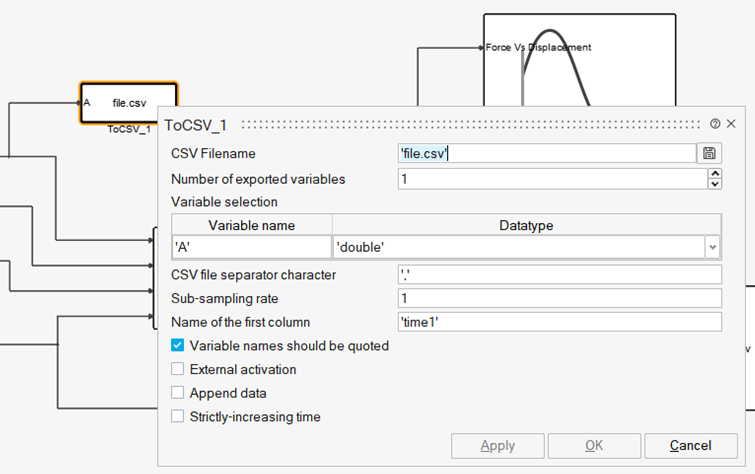

Create output resources for use in HyperStudy.
Output resources are vectors that are output from the results of a simulation. Using these vectors, you can create output responses for design exploration in HyperStudy. In Twin Activate, only output resources need to be created. Output responses are created in HyperStudy.
You need to create ToCSV blocks in Twin Activate and output all signals you want to be included as response sources.
Figure 2. ToCSV Block to Output Signals into a CSV File
Note:- You can output all required signals into one or more CSV files. Each signal from each CSV file will be used as an output resource (or output vector).
- The column names (Variable name fields) must be unique between all CSV files. The Name of the first column must also be unique between CSV files. If you define ‘time’ as the name of the first column in one.csv, you must use a different name (say, time1) as the name of the first column in the second.csv file.
- Column names cannot contain special characters, such as / * + -.
- The ToCSV block should only have scalars as output. Vectors are not handled by the HyperStudy-Twin Activate bridge. Vectors must be split using the demux block into scalars, and those scalars must be added to the ToCSV block.
- While running design exploration, the CSV blocks are read into HyperStudy. Each column is presented as an output resource. You can create your own responses from these output resources.
