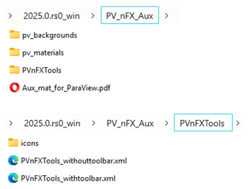

In the nanoFluidX installation folder you will find the PV_nFX_aux folder containing three additional folders: pv_backgrounds, pv_materials, and PVnFXTools. Additional instructions for enabling the nanoFluidX Toolbar Plugin can be found in Aux_mat_for_ParaView.pdf. The ParaView nanoFluidX toolbar is located in the PVnFXTools folder.
Figure 1. Contents of the PV_nFX_aux Folder
The requirement of ParaView for automatically loaded plugins is to keep the location of the plugin consistent. For PVnFXTools, this means the location of the folder and the files in it should not be altered.
  1. Copy the PVnFXTools folder to a location of your choosing.
    Important: For automatic loading of the Plugin, the folder and file locations should not change.

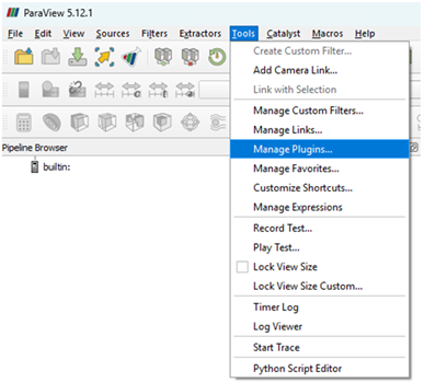

  3. From the menu bar, click Tools > Manage Plugins.
    Figure 2. Select Manage Plugins

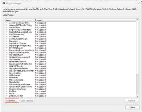

  4. In the Plugin Manager dialog, select Load New.
    Figure 3. Select Load New

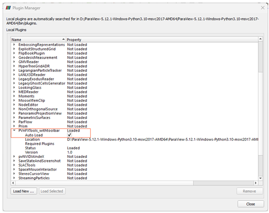

  6. In the Plugin Manager dialog, select the PVnFXTools_withtoolbar plugin.
  7. Enable the Auto Load checkbox and click Close.
    Figure 4. Enable Auto Load Checkbox
    Figure 5. Enable Auto Load Video

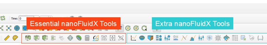

Two nanoFluidX menus appear in the toolbar section of the ParaView user interface. The tools should also be available in the Filters drop-down menu. The coloring of the tools will appear only once the data is loaded into the session.
Figure 6. Essential and Extra Tools
Essential nanoFluidX tools:
  • Threshold
  • Slice
  • Clip
  • Stream Tracer
  • Tube
  • Glyph
  • Contour
  • Calculator
  • Transform
  • SPH Volume Interpolator
  • SPH Plane Interpolator
  • SPH Line Interpolator
Extra nanoFluidX tools:
  • Plot Data
  • Iso-volume
  • Surface Vectors
  • Extract Time Steps
  • Temporal Statistics
  • Plot Selection Over Time
  • Compute Derivatives
  • Integrate Variables
  • Descriptive Statistics
  • Probe Location
  • SPH Dataset Interpolator
  • Resample with Dataset
  • Table to Points
  • Extract Selection
  • Programmable Filter
The majority of post-processing can be done with essential set of nanoFluidX tools. The extra tools are intended only for corner case post-processing requirements.
