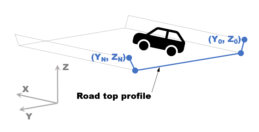

Road top profile notes:
  • Is a two column file of the Y Z form.
  • Consists of a minimum of two Y Z pairs (two points defining one line segment).
  • Has a strictly increasing Y coordinate. Every value in the first column must be bigger than that of the previous line.

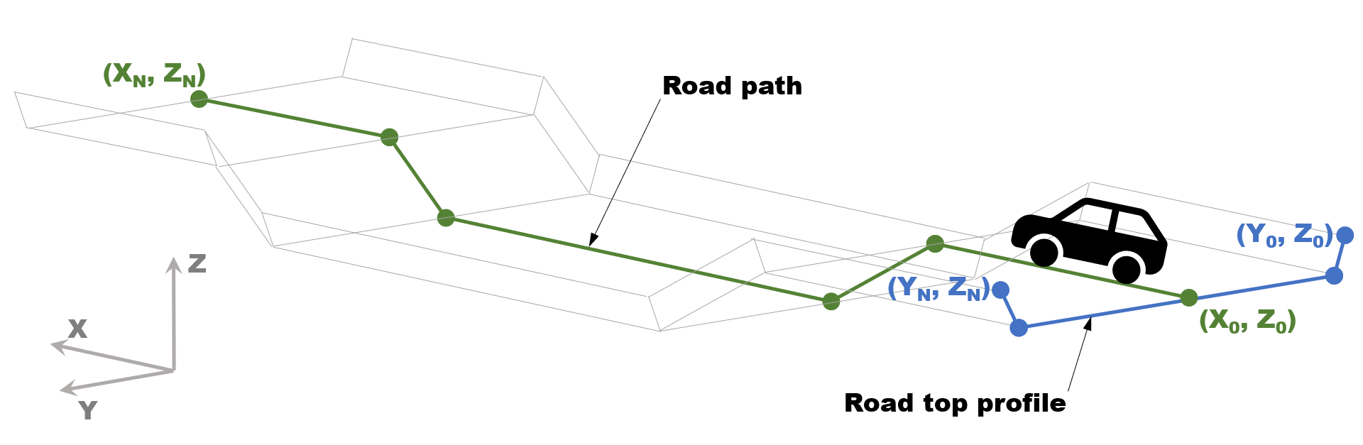

Road path profile notes:
  • Is a two column file with X coordinate in the first and Z coordinate in the second column.
  • Consists of a minimum of two X Z pairs (two points defining one line segment).
  • Has a strictly increasing X coordinate.
Figure 1. Schematic View of the Road Generated for the Case of SLIDING frame. Road Path (green line) and the Road Top Profile (blue line). Respective circular markers on the lines represent points in the stencil definition files (pairs of coordinates) which define the lines.
Note: It is critical that in the case of the Road Path, the X coordinate must be strictly increasing; and in the case of Road Top Profile the Y coordinate must be strictly increasing. Furthermore, it is important to note that it is assumed that the Z coordinate axis is always pointing upwards.

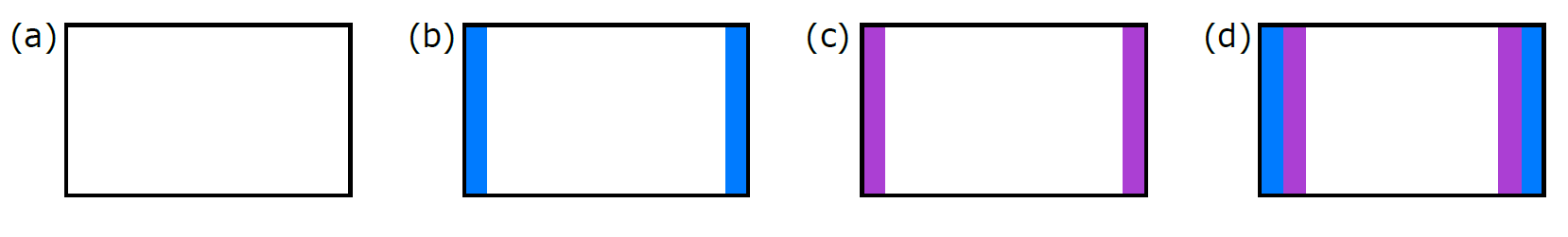

Freeze and sponge layers
Freeze and sponge layers are used to avoid fluid spill through X and Y (and potentially Z) bounding planes in the middle of the channel. The following image shows a schematic of the available configurations of these layers. A freeze layer sets the velocity of all particles within the layer to zero. A sponge layer multiplies a hyperbolic tangent profile with the calculated particle velocity. The two layers aim to satisfy the requirement of quiescent fluid near the frame boundaries.
Figure 3. Schematic of Inner Layers of Domain Box . Depending on frame_min_bc_overlay and frame_max_bc_overlay. Blue and purple bars represent freeze and sponge layers, respectively. (a) Option 0; (b) Option 1; (c) Option 2; (d) Option 3
