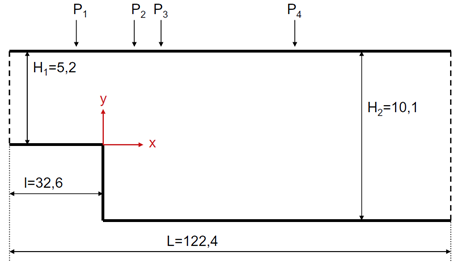

The backward-facing step in a streamwise periodic channel as shown in Figure 1 is based on the geometry given by Issa. The step height is S = 4.9 mm. A constant bulk velocity UB = 0.14 m/s is forced by a constant volume force chosen as F = 0.4 m/s2. The dynamic viscosity of the fluid is 1.456e-5 kg/m/s, with a density of 1 kg/m3. With the hydraulic diameter D = 2*H1 of the channel above the step the Reynolds-Number of the flow is Re = 100.
Figure 1. Sketch of the Backward-Facing Step from Adami et al (lengths in mm). See Adami et al

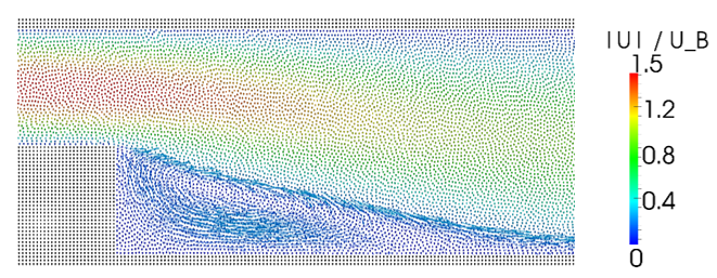

In Figure 2 the flow in the recirculation region behind the step is visualized with emphasis on the recirculation bubble.
Figure 2. Visualization of the Flow Behind the Step for the Fine Resolution at Steady-State

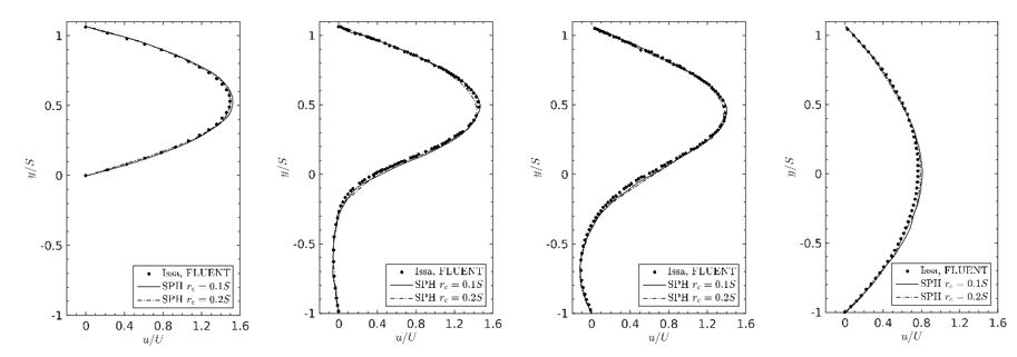

The velocity profiles at the positions P1 to P4 (see Figure 1) are shown in Figure 3. Both simulations show very good agreement with the reference profiles by Issa.
Figure 3. Velocity Profiles at the Reference Positions P1 to P4 (from left to right)
