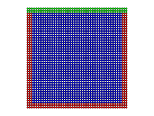

Three different resolutions of 50x50, 100x100, and 200x200 fluid particles are used for each Reynolds-Number. Figure 1 shows the initial particle distribution for the coarsest resolution where wall boundary conditions are imposed by three rows of particles. The simulation is run until a fully developed flow is achieved.
Figure 1. Initial Particle Distribution of the 50x50 Case

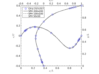

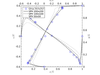

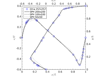

The velocity profiles in the horizontal and vertical centerlines are shown in Figure 2 to Figure 4 for each Reynolds-Number. For the Re = 100 case, all the profiles show very good agreement with the reference profiles by Ghia et al. Velocity profiles at Re = 1000 and Re = 10000 match those of Ghia et al at finer resolutions of 100x100 and 200x200, respectively. This is expected as higher Reynolds numbers results in finer structures and requires more particles to resolve.
Figure 2. Profiles of the Re=100 Case
Figure 3. Profiles of the Re=1000 Case
Figure 4. Profiles of the Re=10000 Case
