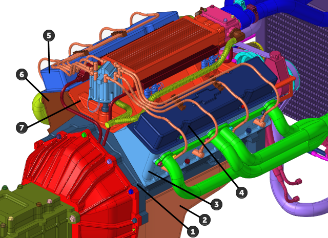

  3. While holding the Ctrl key, select the solids depicted in the figure below.
  4. From the Assembly ribbon, click the Group tool.
  5. Make sure that you have 7 parts selected by observing the number in parentheses on the guide bar selector.
    Figure 3.
  6. On the guide bar, click to execute the command and remain in the tool.

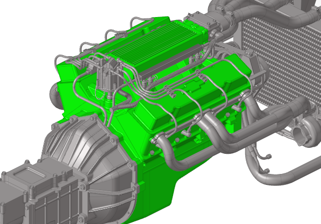

    Figure 4.
  7. In the Groups legend, rename the Parts Group to For_Wrapping.
  8. Right-click For_Wrapping and select Isolate.
    This displays only the parts that will be enclosed.

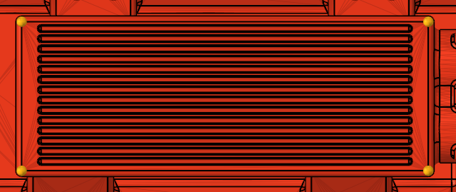

  6. Change the guide bar selector from Surfaces to Nodes.
  7. Select the four nodes shown in Figure 9.
    Figure 9.
  8. Click Cap to begin the capping process.

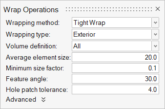

  9. Click the Enclosure > Adaptive Wrap tool.
    Figure 10.
  10. In the dialog, set the wrapping method to Tight Wrap, enter the value of 20 for the Average element size, and leave all other options as their default values.
    Figure 11.
  11. Select all Parts on the screen.
  12. Click Run to execute the wrapping operation.
  13. Press Esc to exit the tool.

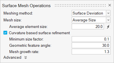

Re-mesh Enclosed Results
  1. From the Discrete ribbon, click the Remesh tool.
    Figure 12.
  2. Select all surfaces on the screen.
  3. In the dialog, set the Average size to 20 and leave all other options as their default values.
    Figure 13.
  4. Click Mesh on the guide bar to execute the re-mesh operation.
  5. Press Esc to exit the tool.

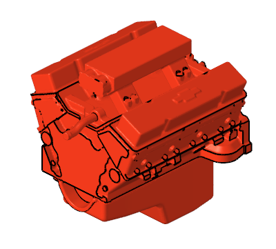

Fix Enclosed Geometry

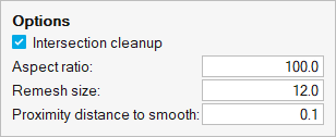

  1. From the Discrete ribbon, click the Auto Repair tool.
    Figure 14.
  2. Select all parts on the screen.
  3. Click on the guide bar. Ensure that Intersection cleanup is checked.
    Figure 15.
  4. Click Fix to initiate the repair of the wrapped surface model.
  6. Save the model.
