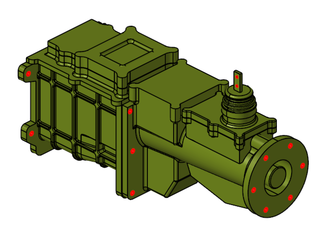

    This value describes the size limit up to which the software should detect a part.
  4. Click Find.
    The bolts less than 20mm are highlighted in red.
    Figure 3.
  5. Click Remove All.

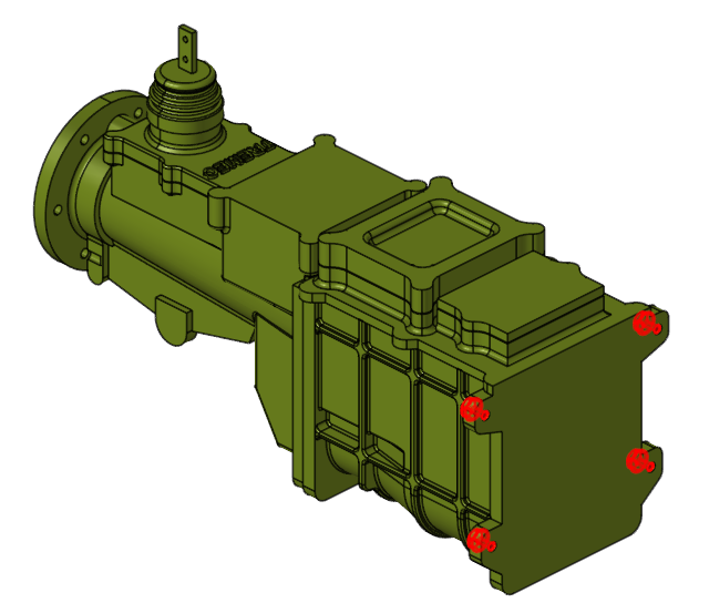

    Some bolts that weren’t detected during the Find operation can be manually removed.
  6. Select the four bolts shown below then click Remove All again.
    Figure 4.

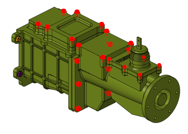

  1. Select the Logos tool from the Defeature secondary ribbon.
    Figure 5.
  2. On the guide bar, click Find.
    The tool searches for any logos in the model.
    Figure 6.
  3. Click Remove All.

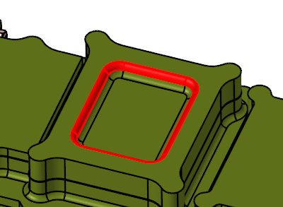

Defeature Fillets
  1. Select the Fillets tool from the Defeature secondary ribbon.
    Figure 7.
  2. Select a continuous fillet loop, as shown in the figure below.
    Figure 8.
  3. Click Remove All on the guide bar to remove the fillet.
  4. Press Esc to exit the tool.
  5. Save the model.

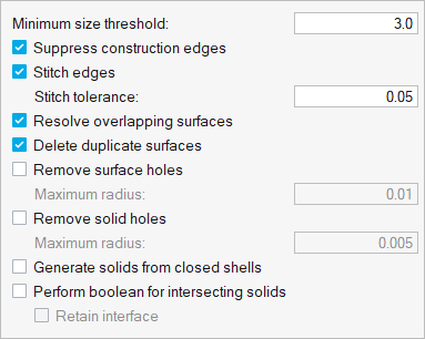

  2. On the guide bar, click and set the minimum size threshold to 3.0.
    Figure 12.
  3. Press Ctrl + A or left-click and drag across the geometry to select all the solid bodies.
  4. Click Batch Repair to execute the batch process.

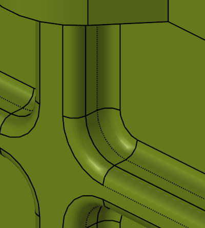

    Observe that the suppressed edges are identified by dashed lines.
    Figure 13.

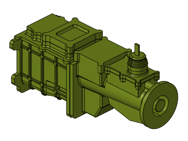

    The geometry should now look that shown in the figure below.
    Figure 14.
