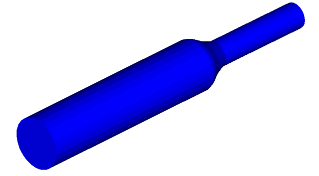

Import the Model
  1. From the Home tools, Files tool group, click the Open Model tool.
  2. From the Load model and result dialog, browse and select HL-1000\Shaft.h3d for the model file.
    The Load Result field is automatically populated. For this tutorial, the same file is used for both the model and the result.
  3. Click Apply.

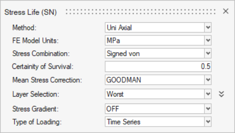

Define the Fatigue Module
  1. Click the SN tool.
    The SN tool should be the default fatigue module selected. If it is not, click the arrow next to the fatigue module icon to display a list of available options.
    Figure 3.
    The SN dialog opens.
  2. Define the SN configuration parameters.
    1. Select Uni Axial as the method.
    2. Select MPa for the FE model units.
    3. Select Signed von for the stress combination.
    4. Enter a value of 0.5 for the certainty of survival.
    5. Select GOODMAN for the mean stress connection.
    6. Select Worst for the layer selection.
    7. Select Time Series for the type of loading.
    Figure 4.
  3. Exit the dialog.

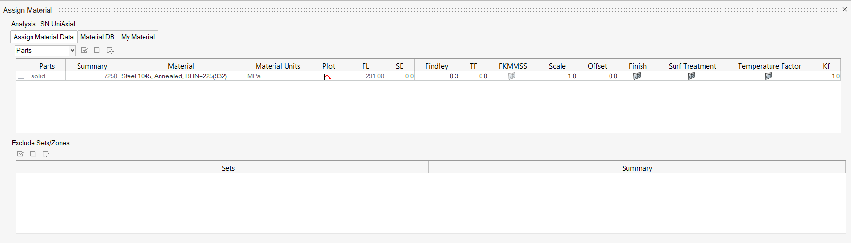

Assign Materials
  1. Click the Material tool.
    Figure 5.
    The Assign Material dialog opens.
  2. Activate the checkbox next to the part solid.
  3. If Steel 1045, Annealed, BHN=225 (932) is not the default material assigned to the part:
    1. Click the Material DB tab.
    2. Right-click on Steel 1045, Annealed, BHN=225 (932) and select Add to Assign Material List.
      Figure 6.
    3. Return to the Assign Material Data tab and select Steel 1045, Annealed, BHN=225 (932) from the Material drop-down menu.
      The Material list is populated with the materials selected from Material Database and My Material.

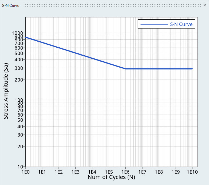

  4. Optional: Click to review the SN plot.
    Figure 7.
  5. Accept all other default parameters.
    Figure 8.
    Note: The FL (Fatigue Limit) and SE (Standard Error) values are from the SN curve selected for the part. The SE value can be edited from both the Assign Material Data tab and the My Material tab. The FL value can be reviewed and edited from the My Material tab. Parameters updated in the My Material tab will be saved to a user-defined excel spreadsheet.
  6. Exit the dialog.

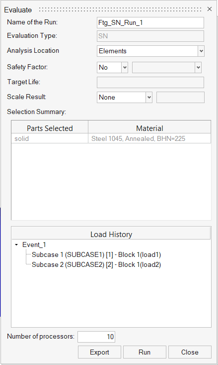

Evaluate and View Results
  1. From the Evaluate tool group, click the Run Analysis tool.
    Figure 13.
    The Evaluate dialog opens.
    Figure 14.
  2. Optional: Enter a name for the run.
  3. Click Run.
    Result files are saved to the home directory and the Run Status dialog opens.

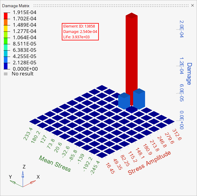

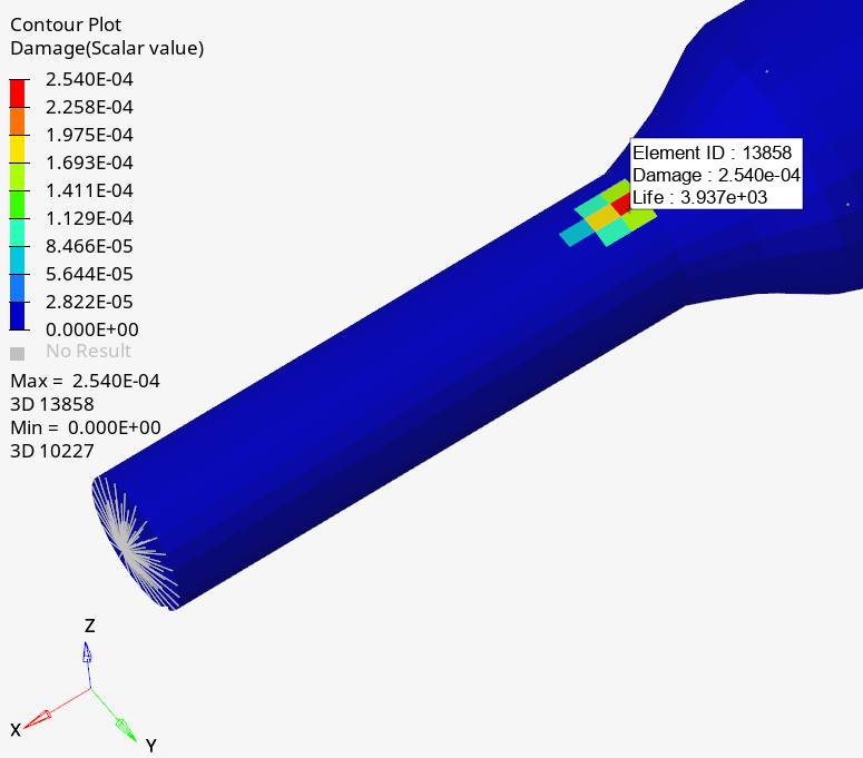

  4. Once the run is complete, click View Current Results.
  5. Use the Results Explorer to visualize various types of results.
    Figure 15.
    Figure 16.
